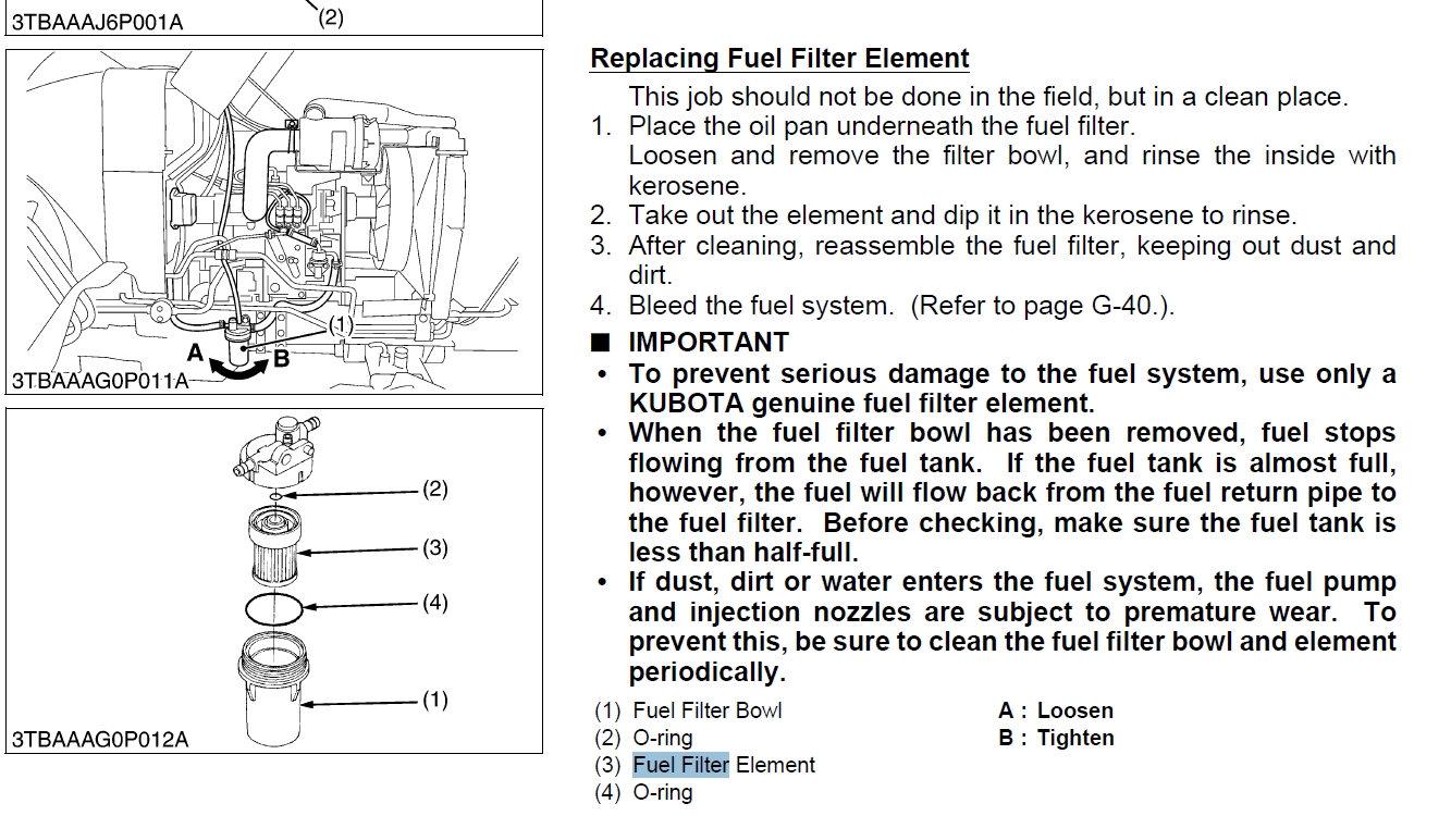

Any fuel filters changed here,problems with air afterwards?
   / Kubota B Series - Service It Yourself #73
Are you having issues starting the tractor after changing the filter?
I've changed mine twice and haven't had any issues. When the fuel bowl is removed the fuel flow is stopped. Once the filter and bowl have been reinstalled the bowl should refill with fuel. When I replaced mine I always changed both o-rings.
Here's the instructions from the WSM...

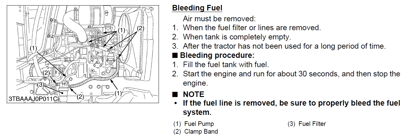

BigBoyToys, I think its the “bleed the system” step in your WSM that throws the eebie-jeebies onto us newbies.
   / Kubota B Series - Service It Yourself #77
BigBoyToys, I think its the 澱leed the system step in your WSM that throws the eebie-jeebies onto us newbies.
Hey Guys...
Here's page "G-40" regarding the "Bleed the System". It's simply a mater of starting the engine and running for 30 seconds. When I changed mine I had more than 3/4 of a tank of fuel so it hadn't been run dry.
