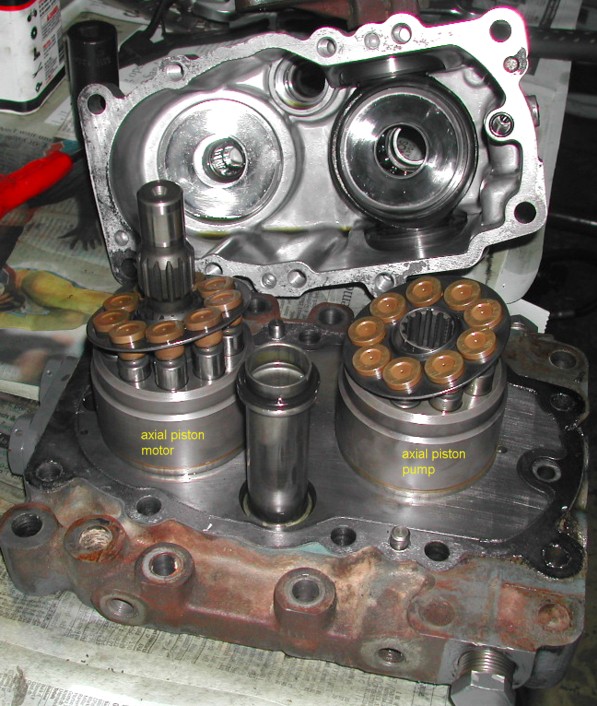

First photo shows the main components of the HST. The motor and the
pump are virtually identical. The pump varies its displacement with
a variable angle swash plate. The motor uses a fixed swash plate.
The tube with the O-rings in the middle is where the MFWD drive shaft
passes thru the HST on its way to the main gearbox. Oil in the HST
does not mix with that in the gearboxes until after filtration. Nice.

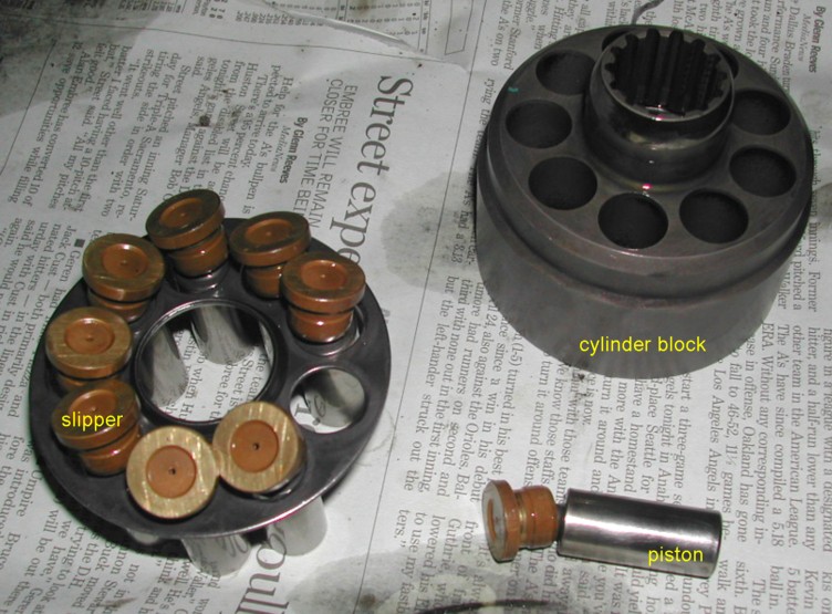

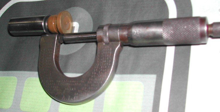

2nd photo shows the cylinder block and pistons. Note the hole in the
brass "slipper", that rubs against the swash plate. That supplied lube
to the plate, and, of course, contributes to some of the inefficiencies
of a HST.
Finally, I miked everything and nothing was out of spec. One bit of
good news. I replaced the main shaft ball bearings anyway (they are
cheap).

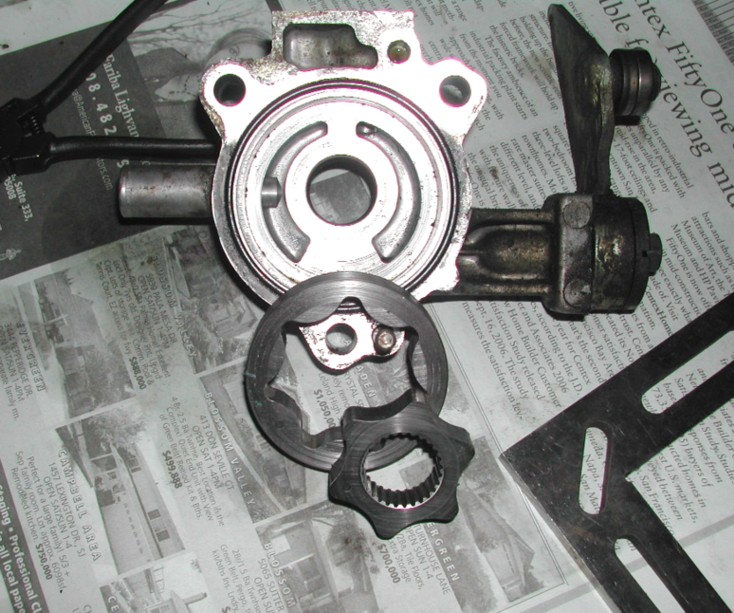

This post gets into the charge pump, which supplies hyd fluid to the suction
side of the HST pump, and the implement pump.
The charge pump (first pic) is mounted to the front of the HST and is always
driven at engine speed by the drive shaft, even when the HST has no demand
(foot off the go pedal). This takes up a few hp, further sapping some of the
engine power seen by the PTO, even when the tractor is not moving. Looking
at the pump, I saw scoring of the aluminum case, and the steel rotary gears.
This can be attributed to the fact that this pump draws oil from the reservoir thru
a steel mesh screen, which did not completely exclude the metal particles that
got into the oil from the disintegrated main gearbox. The charge pump only
operates at a couple hundred psi, and this one may suffice, but I was not
comfortable re-using it. Another $300 for a new pump.

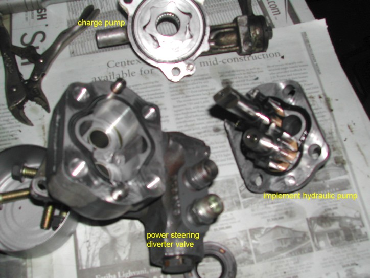

The second pic is a little blurry, but it shows the implement pump, which I
opened up to check. It is in fine condition, thanks to good filtration. The
diverter valve sends oil to the power steering valve, and excess oil (when not
steering) supplements the flow from the charge pump to the HST. The HST's
oil from the charge pump is filtered again, explaining the lack of damage to the
HST. In the past with older cars, I liked to open up the engine oil pumps to
check for scoring, which gave me some indication of how well the previous
owner(s) cared for the car.

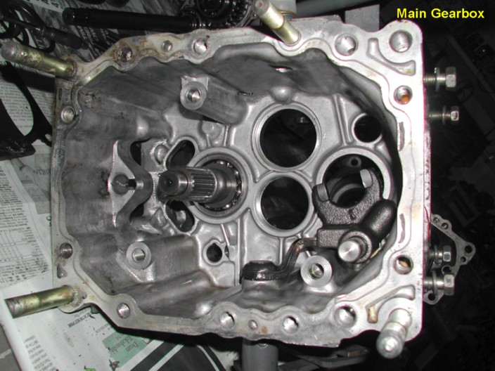

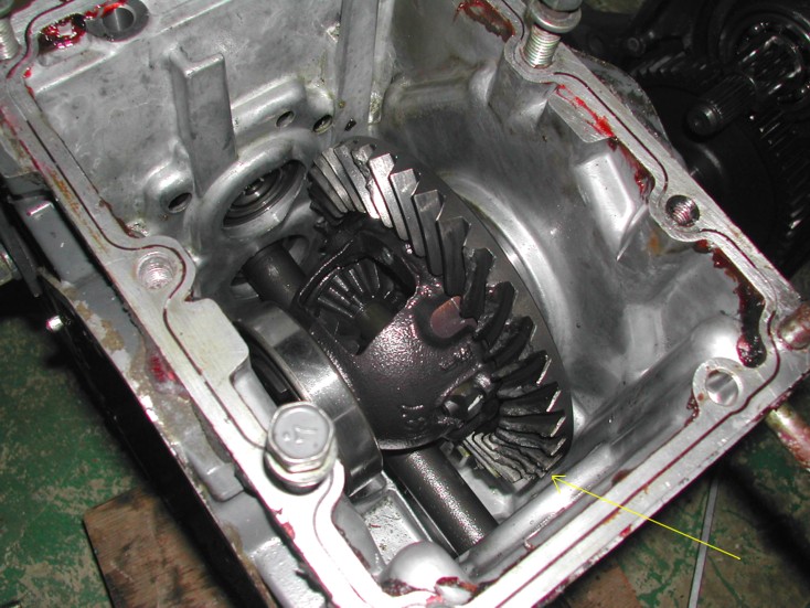

Here is the main gearbox just after I separated it from the HST, and
the rear diff housing. Nothing inside but one gear, one shaft, and one of
the 4 shifter forks!
2nd photo is the inside of the diff housing. Pinion gear and shaft are
missing, but the damaged ring gear is in there.

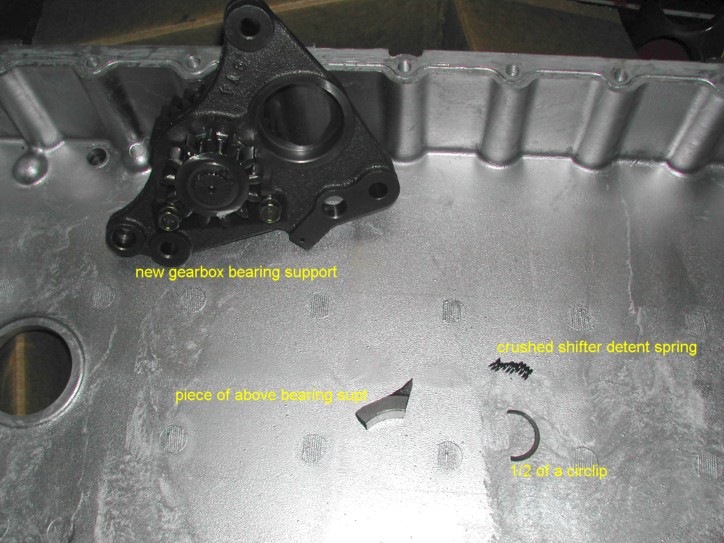

3rd photo shows some of the loose broken pieces I found. The circlip
and steel casting fragment were inside the hyd oil reservoir, also in the
picture. The new steel casting forms a bearing and shaft support
inside the gearbox. Some huge forces shattered the original. Most
interesting was the crushed spring, which came from the MFWD shifter
detent. I found it at the bottom of the diff housing, behind the largest
axle gear. I think it got crushed between the ring and pinion gears, shattering
their teeth. If so, what caused the spring to come out? Perhaps a
broken shifter fork, as that one is only aluminum, and the operator could
have forced it.
