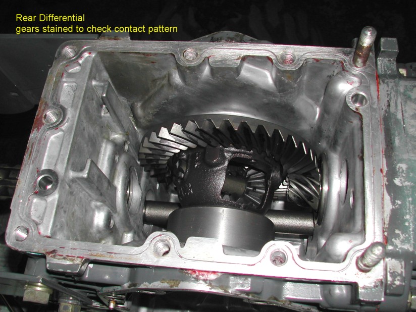

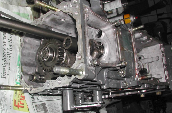

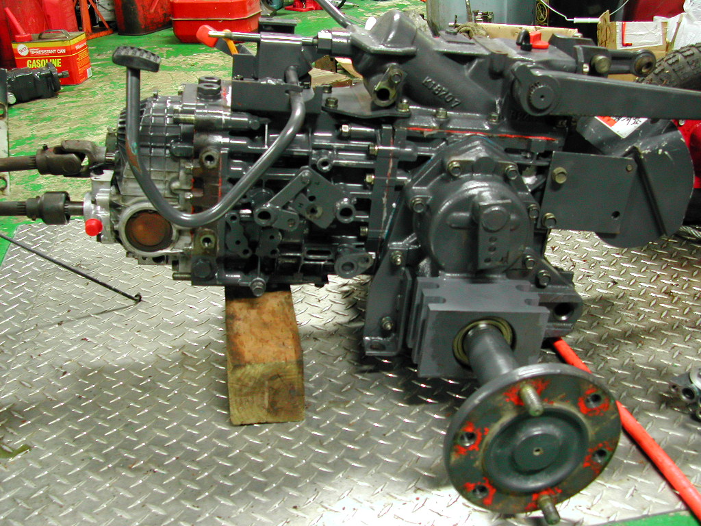

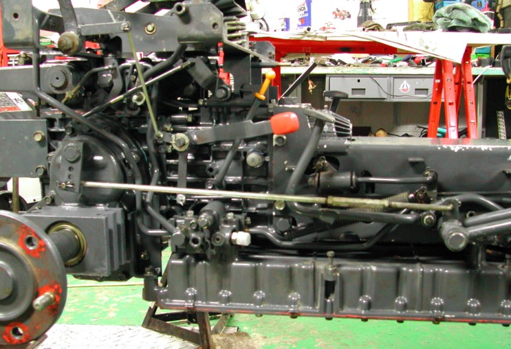

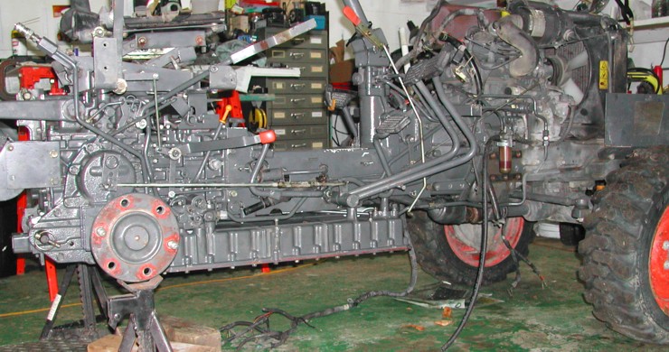

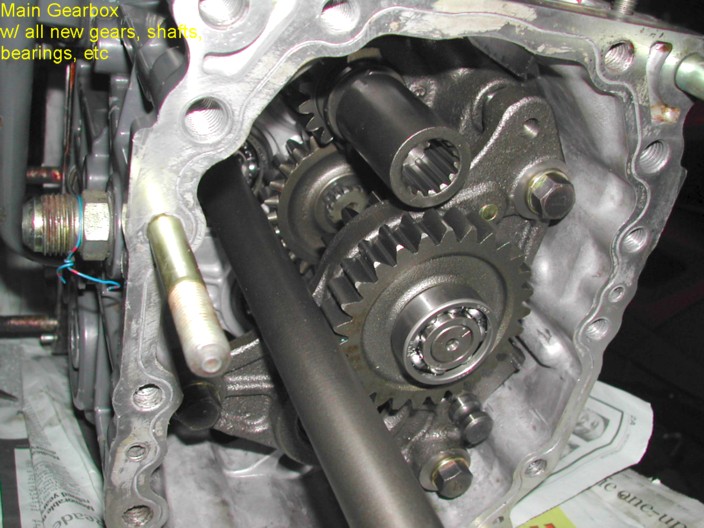

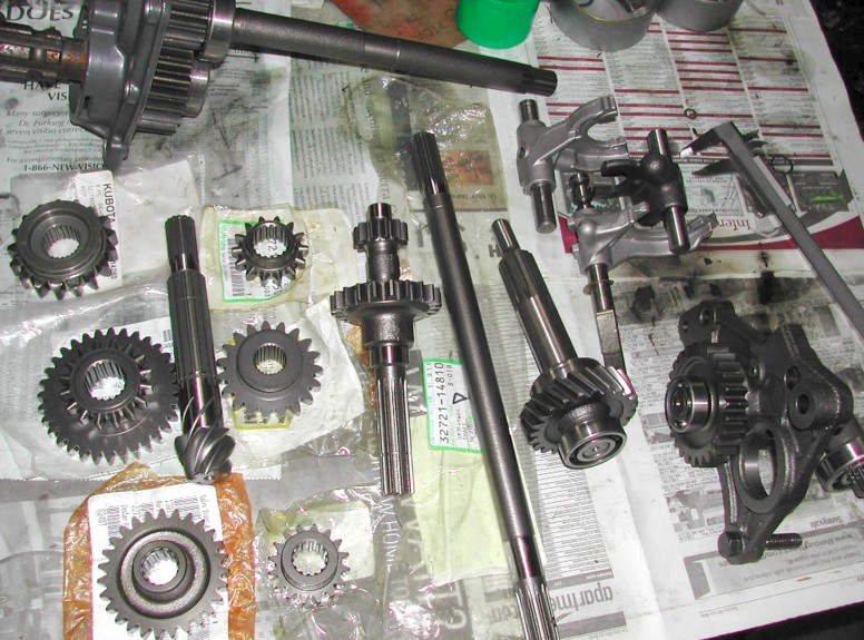

I bought 100 or so parts, most from the parts diagrams.
Final assembly was tricky at times, because I did not take everything
apart myself. Fasteners were all thrown into a large cardboard box by the
guy(s) who took everything apart. When I have these kinds of larger
projects that I disassemble myself, I will have as many as 50 plastic bottles
and tuna cans labeled for each subassembly. Esp if it is going to be months
waiting for parts or other distractions.
YUBBY: I did remember ithe HST pedal spring, but I neglected to get the
charge pump hard line on before re-joining the tractor halves. :(
I ordered a few extra shims to set the ring and pinion gear teeth. I stained
the teeth to look at the contact pattern.

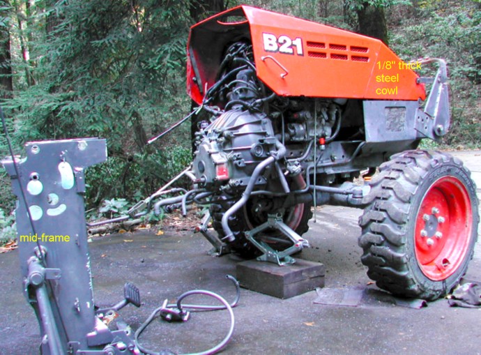

Just out of curiousity, did you have to pull the front end off to get at the clutch?
One of the pix I posted shows removing the midframe from the clutch housing.
If you ONLY needed to get at the clutch, you could separate the tractor
only at the front of the midframe, instead of at the rear like I did. The clutch
housing on this tractor is sealed, BTW. I do not know how common it is with
tractors, but I have seen plenty of dry clutch housings that have drain holes
and vents. If this particular B21 had a drain hole, there is a good chance that
the small main seal leak would not have pooled up high enough to soak the
friction disk. Of course, that's just my opionion....I could be wrong.
