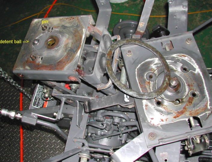

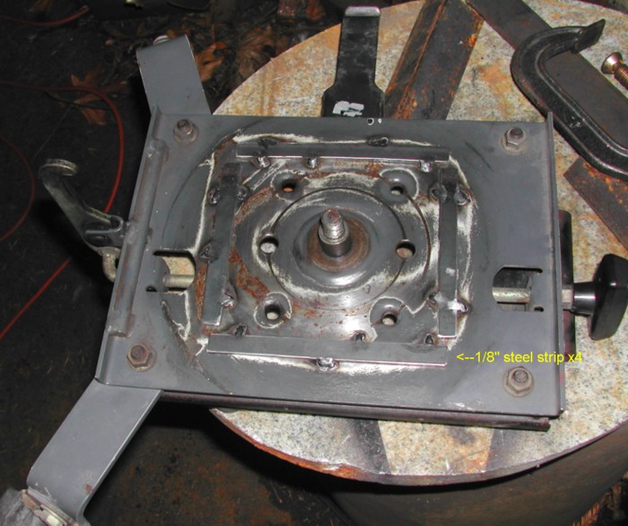

I love the very nice suspension seat that spins around so the operator can
drive or use the hoe. It releases and lifts up and around, locking into place
in 2 possible positions. When I got my B21 the seat was very sloppy and
would rock side-to-side. I took it apart and discovered that there are 2
spring-loaded pins and a locking mechanism to do this job. There is a dense
piece of plastic acting as the friction surface. Its rivets had worn off and
it was displaced. See first photo. I did not see an easy way to attach a
new piece of dense plastic as the fastener would wear off like the original.
So I welded in four 1/8" thick strips of steel. Works great.

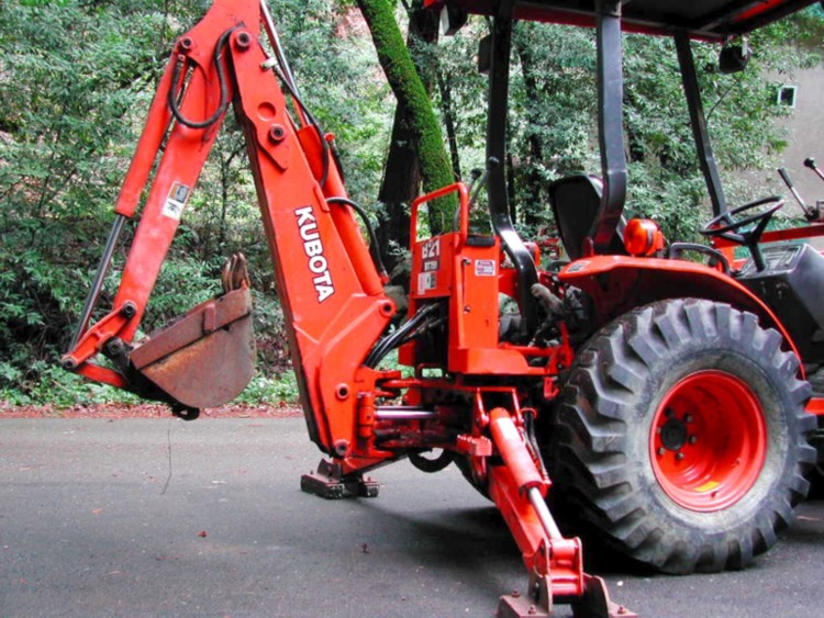

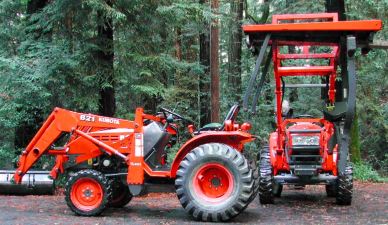

Well, not much happened on the B21 since early Dec. I just got
it out to install the FOPS/ROPS and mount the backhoe. The hoe
was very fast and easy, cuz now the hydraulics are working. The
FOPS was tough, as the photo shows. My Kioti could barely lift the
structure to clear the mounting points.

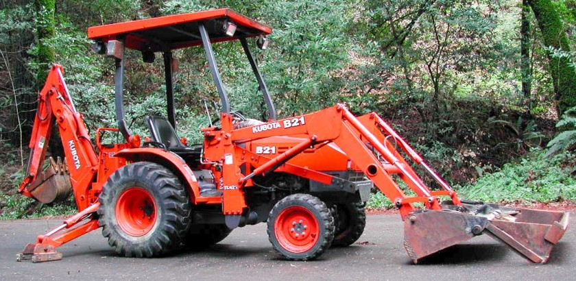

Well, between all the rain (and snow), I finished up with installing
the 4-in-1 bucket. What a neat tool. I might just have to get one for
my Kioti.

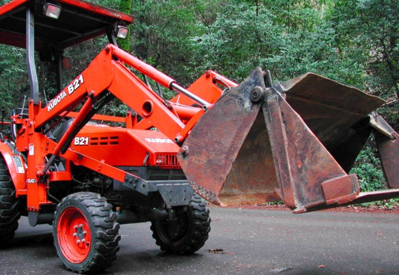

DAVE: The B21 now has a healthy look! I like the looks of that 4n1 bucket! Is that lip on the topside of the bucket standard, or do you think it was a previous add on? That is one of the shortcomings of my L35 with the self-leveling; it tends to jerk, or acting too fast, reaching that mode spilling material, no matter how slow you lift it, which your lip would prevent, I think?
Has the lifting capacity of the loader been a disappointment, because of the increase weight, or any other negatives against the tractor?
Thanx for the up-date....
LEE
   / Kubota B21 TLB complete driveline rebuild #49
LEE
I think you could now add to your bottom line testimonial: "now I get to build/{FIX} anything!"
#50
LEE
There IS a spill guard welded on the top lip of the bkt. This seems to be an
option sold with some 4-in-1s. The prev owner also had 1/2" steel plates
welded onto the inside of the sides of the jaw. Also note the zig-zag
wear surface welded beads added in various places. The prev owner had
one accident that dented the hood....that is prob what got them to add the
spill guard and there was a stainless steel protective plate that I have not
reinstalled.
I have minimal time learning the coordination of this 4-in-1, but initally I
am not impressed with the self-leveling bkt. The weight IS huge for such a
small tractor, so the net lifting capacity is less than any other tractor I have
owned or operated.
