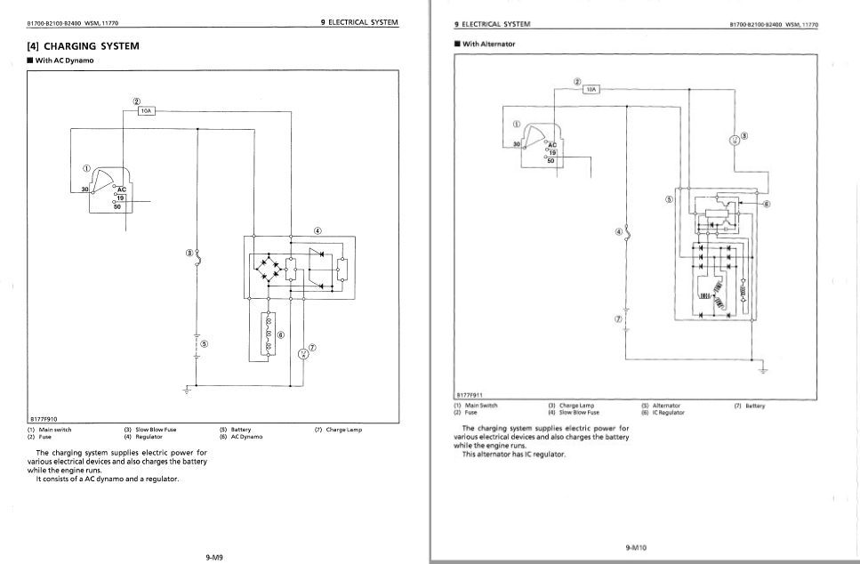

thanks. does anyone have a wiring diagram for this little beast? it's always easier hacking these things if i know where the other end of the wire goes ;)
/ kubota b2400 dynamo #9
great. i don't know what the wiring on mine is. by 'single wire' you mean it's grounded through it's chassis to the engine (as opposed to grounded through it's wiring harness)
Probably ... "One wire" generally mean one terminal/wire going to battery/electrical system... Ground is assumed(bad term) through chassis...
This may help...
Ripped from ...
B1700,%20B2100,%20B2400%20WSM%20Part%202.pdf
Dale

The single wire alternator that I have is just that, one single wire runs from the alternator to the positive side of the battery, the voltage regulator is built into the alternator and it does not need any input power to excite the field.
If your alternator has a wiring harness going to it you probably have an external voltage regulator.
Also, if you have an alternator idiot light there is a way to hook it up, but I didn't bother, when I rebuilt the dash I added a voltage gauge.

thanks. it appears that i might have a harness (i guess i'll need to pop the hood when it's light outside). from that diagram by dale (thanks very much BTW), i see the dynamo goes straight to the regulator, consisting of a wheatstone bridge. the charge lamp doesn't light up anymore (it did when i was running halogen lights), i remember trying to test the alternator, when i changed out my lighting, and i got 13v which seems low, but should be enough to charge. i wonder if the charge light has burned out. anyway, thanks. i'll tear into it this weekend and see what i can find.
/ kubota b2400 dynamo #12
Check the lamp some systems actually require a operating charge lamp to initiate the charge sequence of alternator systems but as you have a dynamo I suspect its a "generator" it may not need the lamp, but check it anyway... One never knows....
Functioning generator or alternator should top out about 13.8 to 14.2 volts... 12.5 to 13.5 volts is just battery float voltage, doe snot indicate charge..
And in regulator its a "full wave bridge rectifier" (by diagram) and not Wheatstone bridge....

Remember, what you have is a dynamo. Permanent magnets rotating around a coil(s) of wire. To test, you need to disconnect wiring at dynamo and measure alternating current voltage. It should be approx 40 volts between each pair of wires if your dynamo has 3 wires.
They are very simple and rarely fail. The rectifier/regulator is a different story as far as reliability is concerned. Rather than change the dynamo's output, the rectifier dumps excess current by converting it to heat. In the beginning, as you converted to LED lighting, you reduced the current draw by the tractor and require the rectifier to dump increased current and you may have cooked it.
