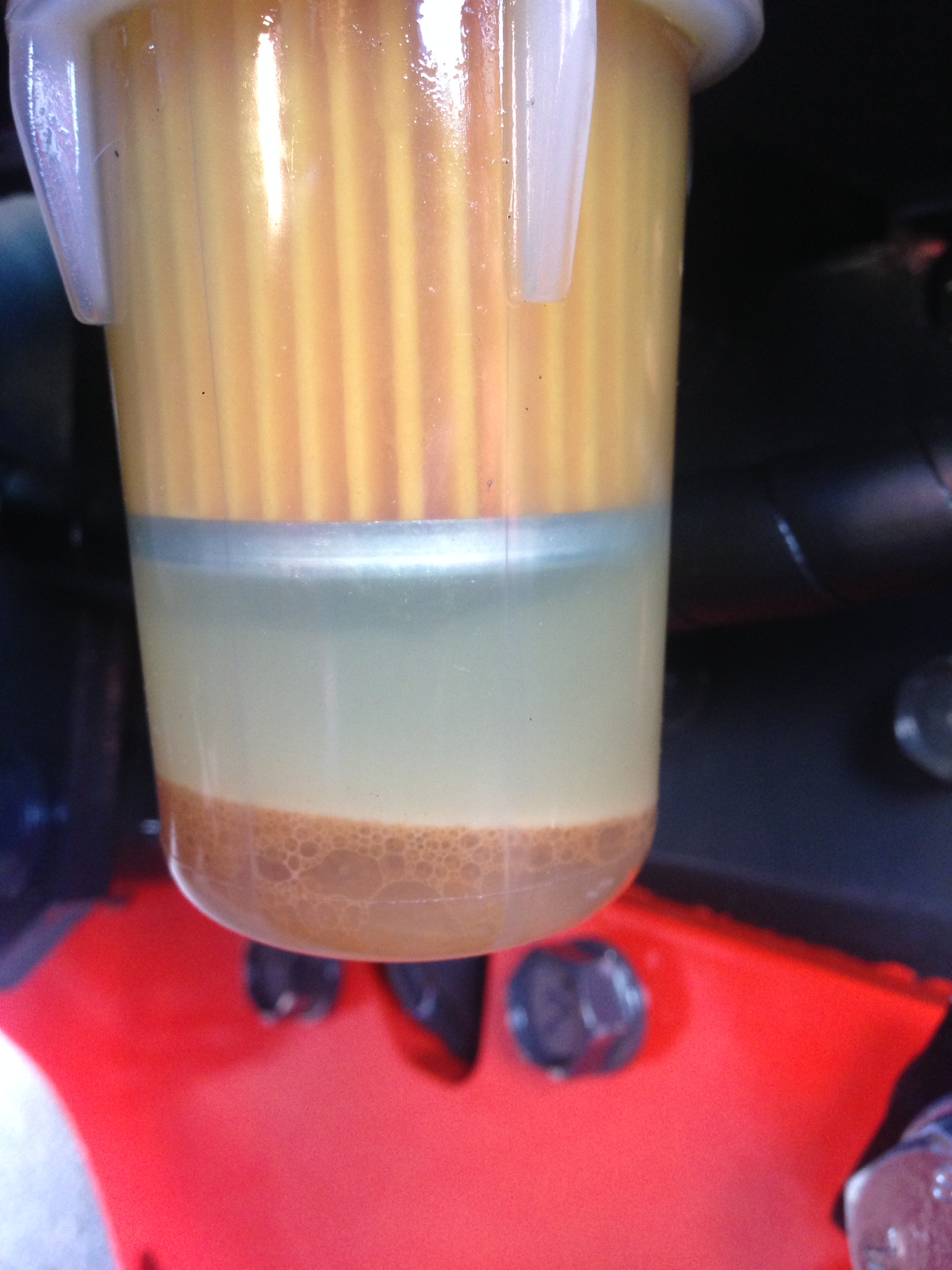

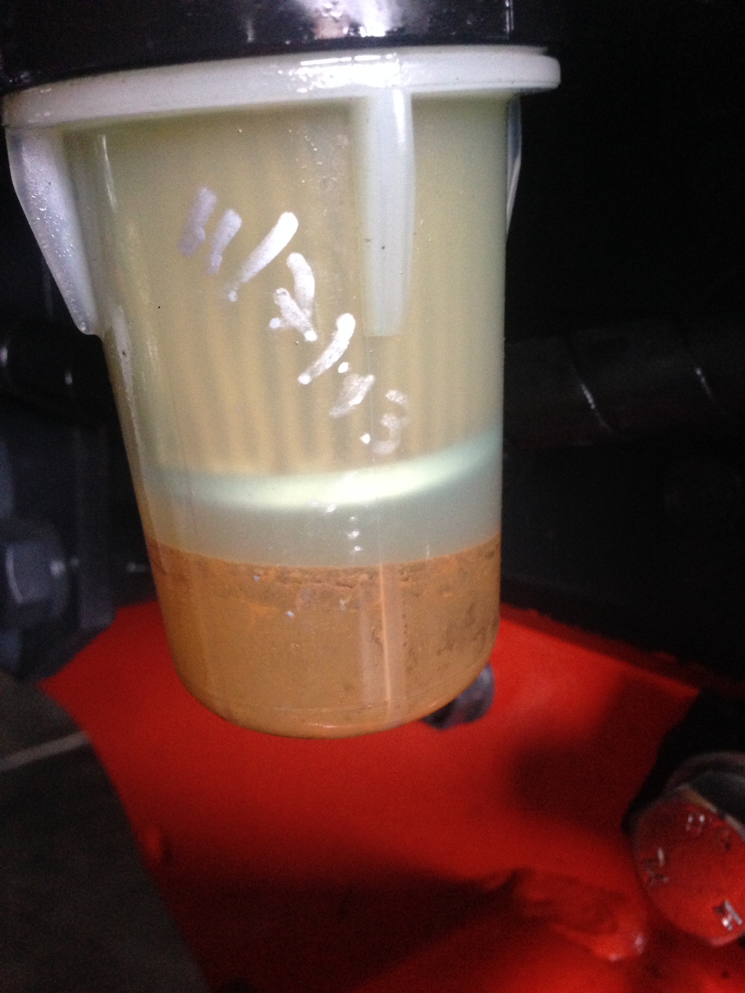

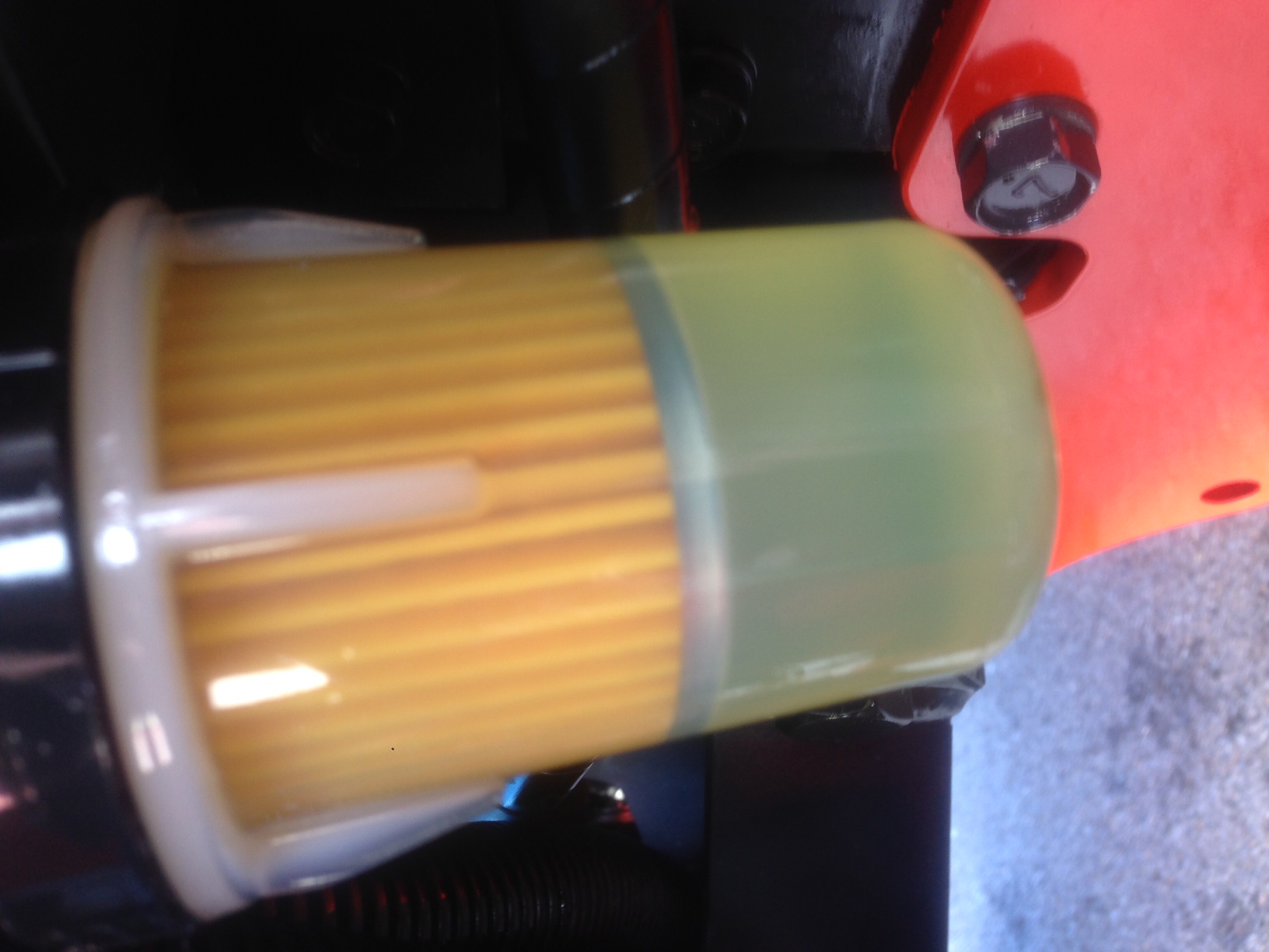

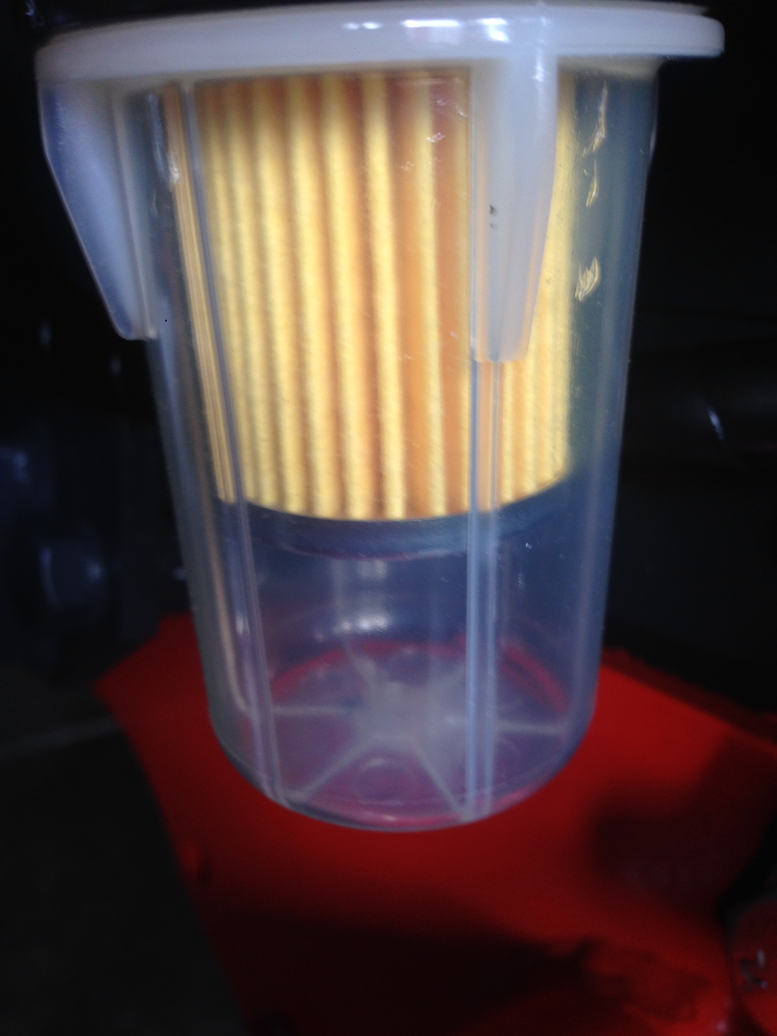

After filling up my diesel truck and the tractor I got a water in fuel light in the truck on the ride home, I ended up having to have the trucks tank drained...long story short I drained the tractors fuel and replaced the fuel filter as a precaution. I am at 29.X hours and it was my first time even looking at the fuel filter canister:ashamed:. Curious as to what yours looks/looked like at your last glance? I have attached pictures of mine.
1. Original filter at 29.X hours
2. Clean canister with new filter before filling with fuel
3. Filled with fuel before starting engine.
4. After running for 10-15 minutes

Whoa!
201drive, you've got a dose of contaminated fuel there! The bottom layer in picture 1 looks to be water. Picture 3 shows "cloudy" fuel that looks as if it may be carrying small water particles that have not yet settled out of suspension. Picture 4 bottom layer again is water. The water tends to settle out as the water molecules will not combine with diesel oil, though if agitated enough they can stay suspended for a relatively short while.
I would remove the filter bowl and clean it again. Do it soon and check it again often. Repeat each time you see water in the bottom of the filter and you may not have to replace the filter element if you can prevent it from getting fouled and clogged with water.
My filter looks clean with no sediment layer at over 50 hours. I'd be having a talk with your fuel supplier as they are responsible for selling uncontaminated fuel.
bumper

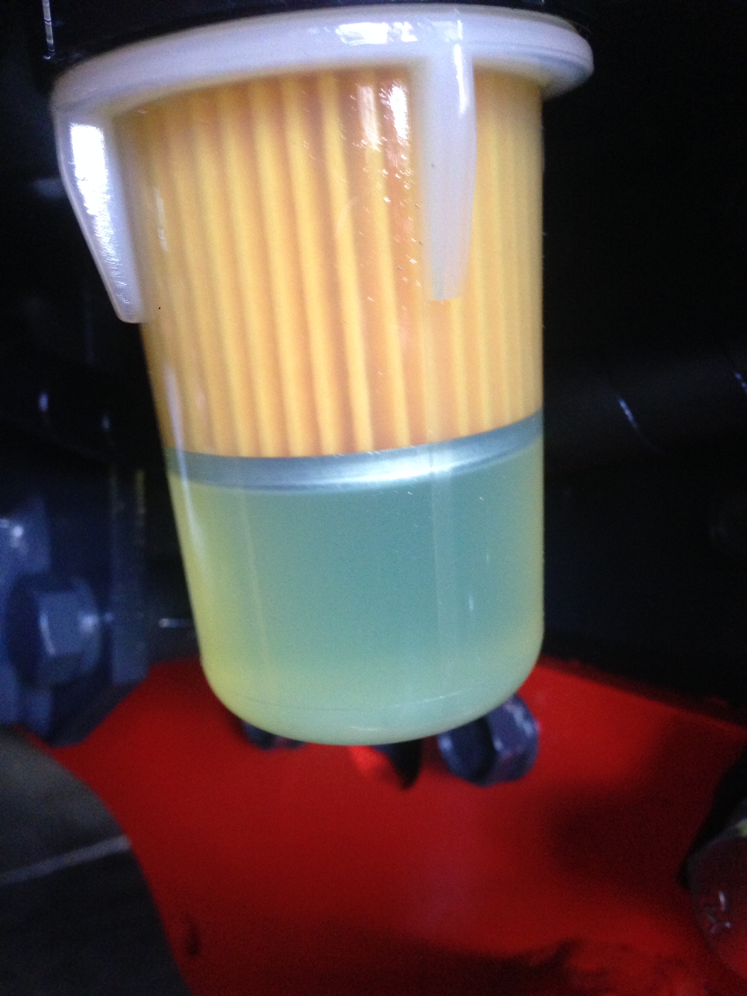

Update:
Drained the canister a total of three times this morning.
1. Drained canister reinstalled and ran for a few minutes looked good.
2. Drained canister again just to be safe and a little bit out of the fuel tank, reinstalled canister ran it for 10-15 minutes looked similar to picture #4
3. Drained canister and a bit more out of the fuel tank, reinstalled canister and ran it for 15-20 minutes at 2300RPM
Final results attached...All looks well? I will be checking it before and after each use now. :thumbsup:photo-5.JPG
I don't know whats going on with the uploader it's attaching it crooked, just click on it and it fixes it.
