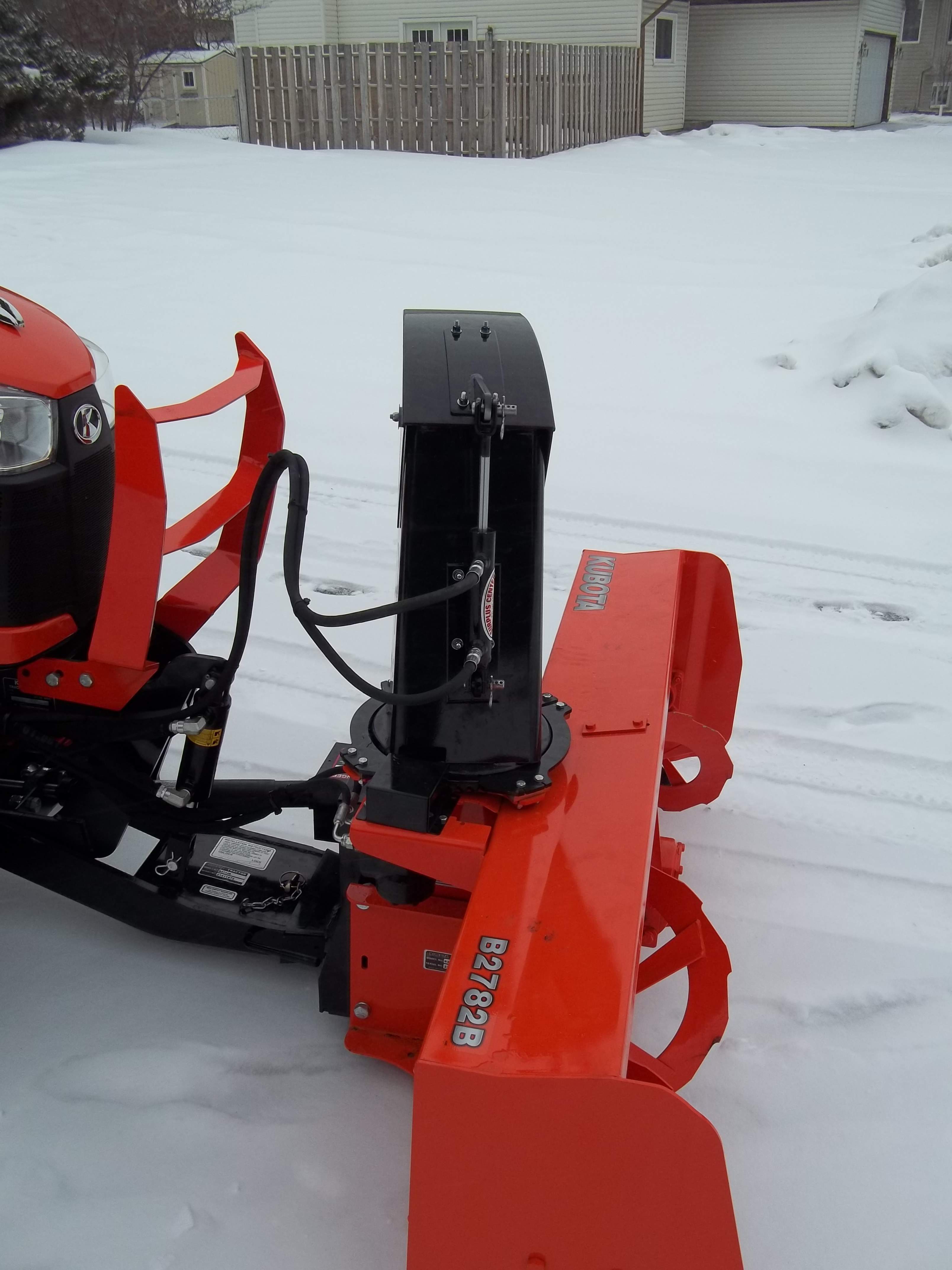

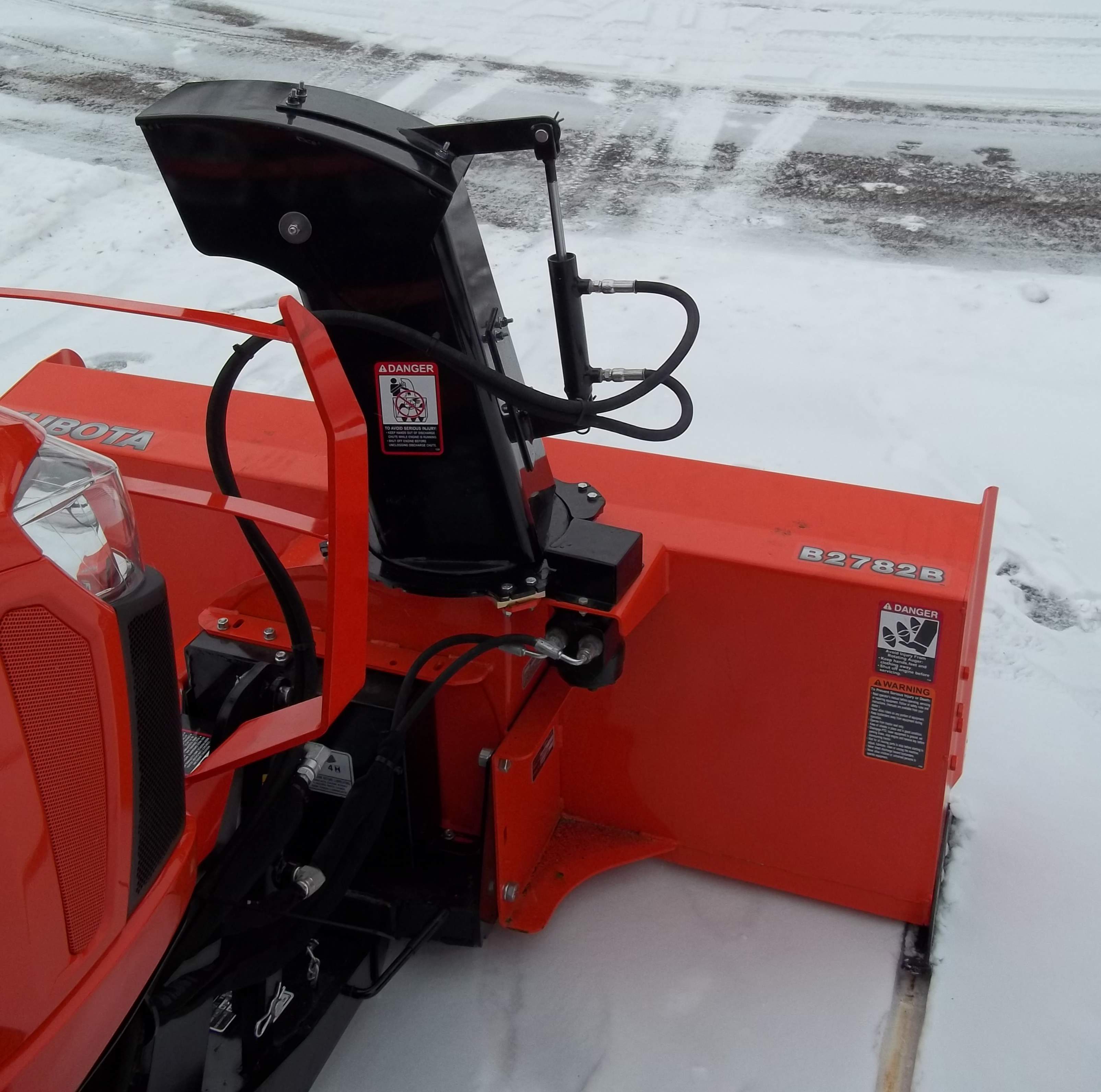

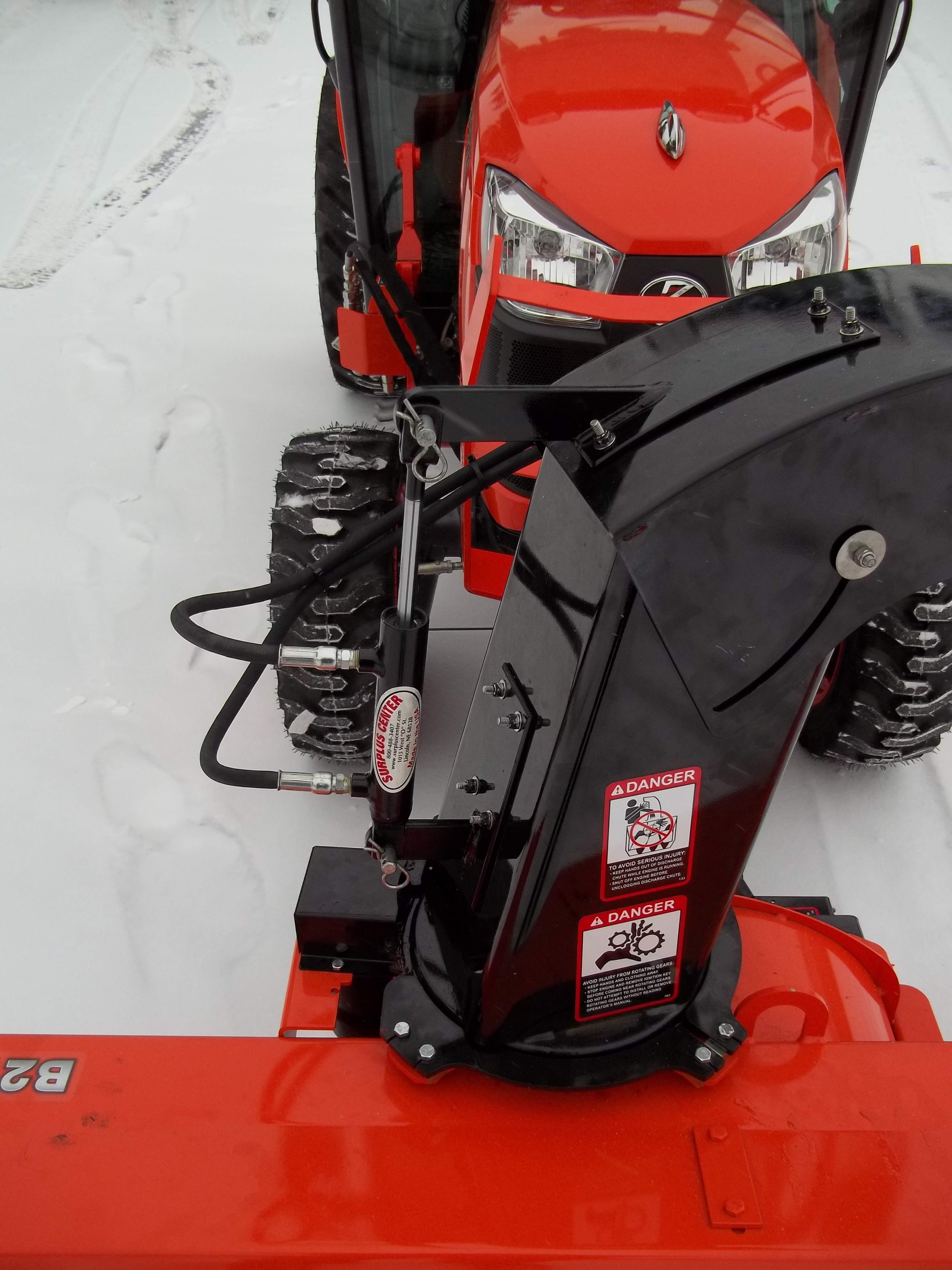

** Thanks! Couple of snows and no more sticking, clogging, or need to spray Pam etc - - at least in the chute.
I am waiting to see if you line the impeller housing...
** Still on the fence on this one. One of my impeller blades won't clear 1/8" UHMW PE, the other 3 will. To do it right, I'll need to remove the impeller, true up the edges, at least so they're even, and re-balance it. I can static balance it using a motorcycle wheel stand, but also have a computer balancer that's designed to balance aircraft propellers and turbines.
How did you fasten the pe in the areas that you lined?
** The larger chute liner fits snugly, and is only held in place by the two small front guard grill bolts (grill not used), and by the chute deflector radius slot bolts. It has not tendency to move and is firmly in place, mostly due to the geometry. The chute liner is in 3 pieces, I used 6-32 countersink SS screws, drilled and tapped the chute, countersunk the PE and just ran the screws in from the inside, with no nuts on the outside. Could have used screws with locknuts. I used only two fasteners per piece as the two at the exit edge of the curved flat piece (it gets the most impact) and the curved shape of the side pieces tend to hold the curved piece in place (curved piece installed first and overlapped by edges of side pieces.
Also, do you have a link to the led lights and the Jergens pin?
** I did get a smoking good deal on the Jergens pins. The seller corrected that eBay listing error immediately after receiving my order (I tried to order two more at the good price! Greedy, I know.) For the LED lights, just go to eBay and search <LED work light, 36W> it'll be the first one that comes up - - further, it's 7" wide.

In this case, though, a drip oiler may be overkill. Most drive chains, and I think this one, are O-ring type, with sealed in lubricant. The user manual suggests chainsaw bar oil at I think 10 hour intervals.
EDIT: Manual says every 4 hours and after each use.
Bar oil is typically sticky, and besides making a mess, tends to stay in place for awhile. It's only being used to lube the rollers and sprocket wear surfaces as the lube inside the chain takes care of the pin to roller interface.
So, I'm thinking just a small metal cup with tube to dribble a little bar oil onto the "inside" of the chain loop as the blower is running. No needle valve needed, as the oil can dump onto the chain in seconds and enough will stay in place for the duration. Good news is it's a nice clean environment, no dust or dirt to speak of (completely unlike a motorcycle or bicycle chain) and so chain and sprocket life should be good.
bumper
   / Kubota B2650 and B3350 info and hints #77
For lubrication of the o-ring chain on the B2782 blower,it's nice to have a helper.
I place the PTO selection lever in the rear PTO position;this allows the front(mid)driveshaft to turn freely.
Just ahead of where the driveshaft enters the blower is a small space through which you can see the chain.
Having the helper rotate the blower fan turns the driveshaft and chain allowing me to apply lubricant to the slowly rotating chain.
I've been using Lucas oil supplement at the suggestion of a long time biker friend.The quart bottle easily applies the lube through small opening.
Beats taking off the chain cover every time-I seem to recall 4 hour chain lube intervals.Good Luck!
