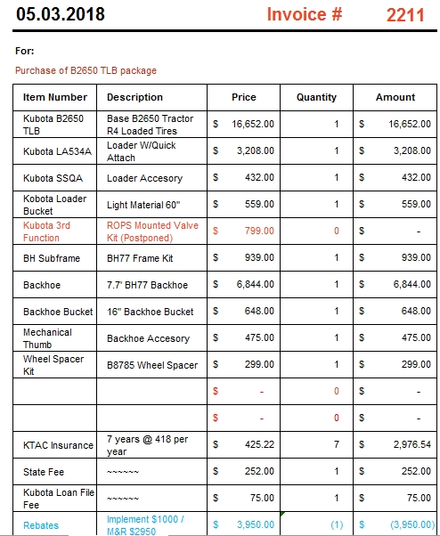

My dealer is charging me $1,160 installed for a third function valve. I think this is excessive. Mind telling me what yours cost if it was itemized?

Mine was $800 for the loader 3rd function installed prior to delivery.

In the B2650 count down thread I posted the invoice showing the breakdown.

Ask and ye shall receive...
