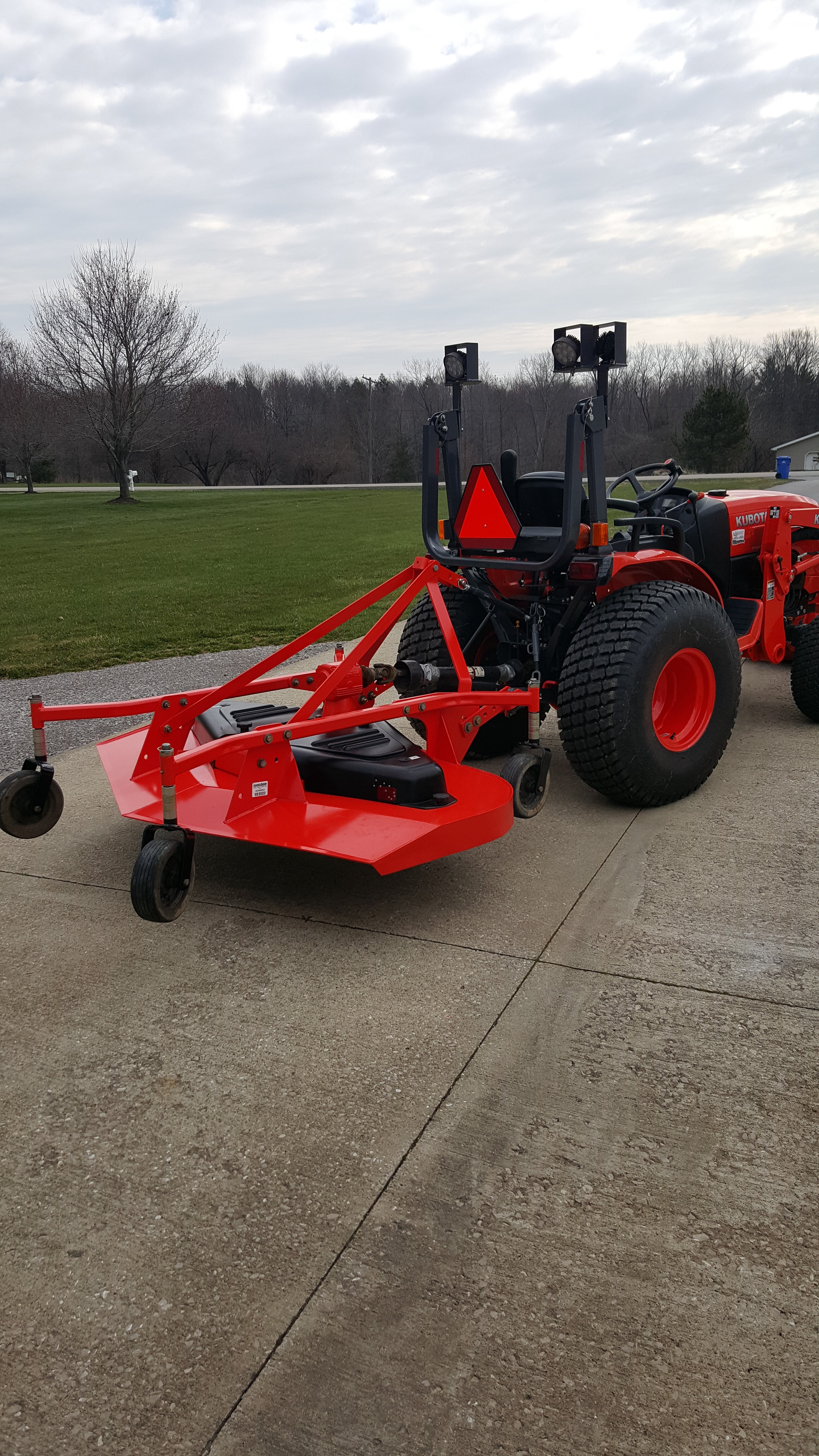

Just don't want scare off anyone considering a B2650 to mow with because I don't believe it's a "B2650 not strong enough to run a 72" mower up hill" issue. It's just that the combination of over size tires (I know from my old days putting oversized tires on a Bronco and Wrangler how the larger circumference and weight zap power), along with the additional weight filling them with liquid. I don't know but wouldn't think a rear finish mower would pull more power or weigh more than a mmm of equal width but perhaps it does?
Knowing that I was going to be mowing a lot and doing loader work with my B2650 I opted for turf tires filled with air and the 72" mmm. The deck is easy peasy to put on and off, and the tractor runs this mower just fine through fairly heavy grass up and down hill in mid range. For grass that's up around grill height I use low range. I only mow with the loader and ballast box off.
With all the objects to mow around, and in the interest of saving tractor hours, last Summer I purchased a Zero Turn dedicated mower with a 61" deck and it's actually a little faster mowing than the tractor with the larger deck so the deck just sits in the shed now.

I need the width for this property, even at 60" wide I've had some really sketchy moments. That was part of why I was willing to buy this machine, I wanted the width but not the weight of a CK2610 it L2501. This game me that same width with about 1,000 less grass destroying weight. I had a BX25D before this, you had to extend the backhoe out flat to the ground and swing it to the uphill side to cross my lawn and get to the trails. If I got off, I could push on the ROPS and the uphill rear tire would lift. Not cool.
With this wide B2650 and fluid filled tires I can cross the yard in high range and full throttle/HST while drinking a beer. It's stupidly stabilized by the tires. I'll take the lumps.... I'm not giving up these heavy and wide set tires. I'm picking up a Woods Heritage RD60 in a few weeks, so that should take care of the issue

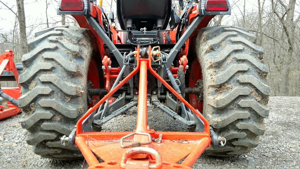

What would be nice is for someone with the original size tires to drop by and change them out for long enough to do a quick video. I am thinking it would make more than 7 per cent difference.
I know .370 rear end gears changed to . 355 in a 79 vette made a huge difference in performance. Less than what you have changed in the overall difference of tire circumference.

It's 7.5% no matter how you look at it. Math is math.
I don't blame the tires nearly as much as some of you do. The FDR2572 is the larger gearbox, heavier mower. It's minimum HP requirement is 25 at the shaft. I'm 19 at the shaft. Now that I know that, it's fairly easy to accept that I should have looked for the Land Pride standard (it light duty) 72" mower. But, it's all cool. I'll grab that Woods Heritage 60" and it should be fine. Screenshot_20180429-214925.jpeg
