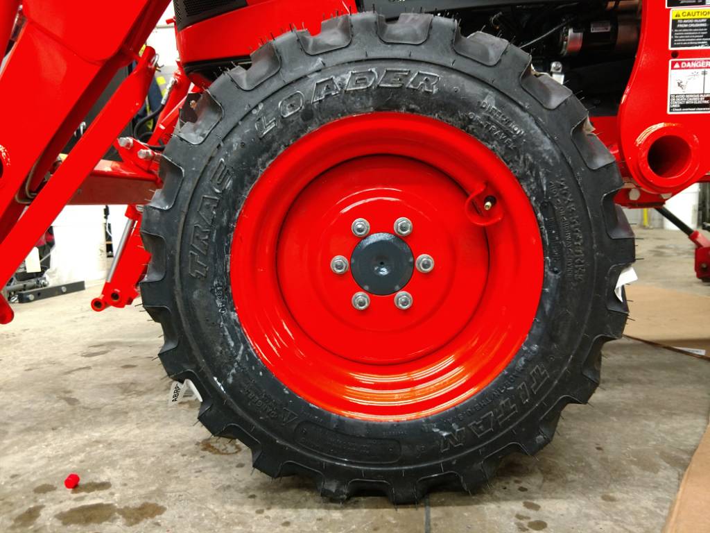

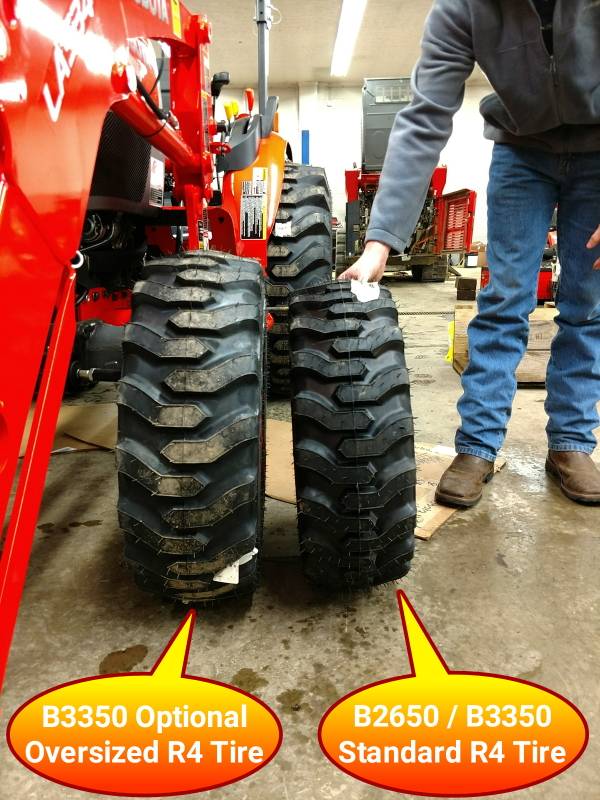

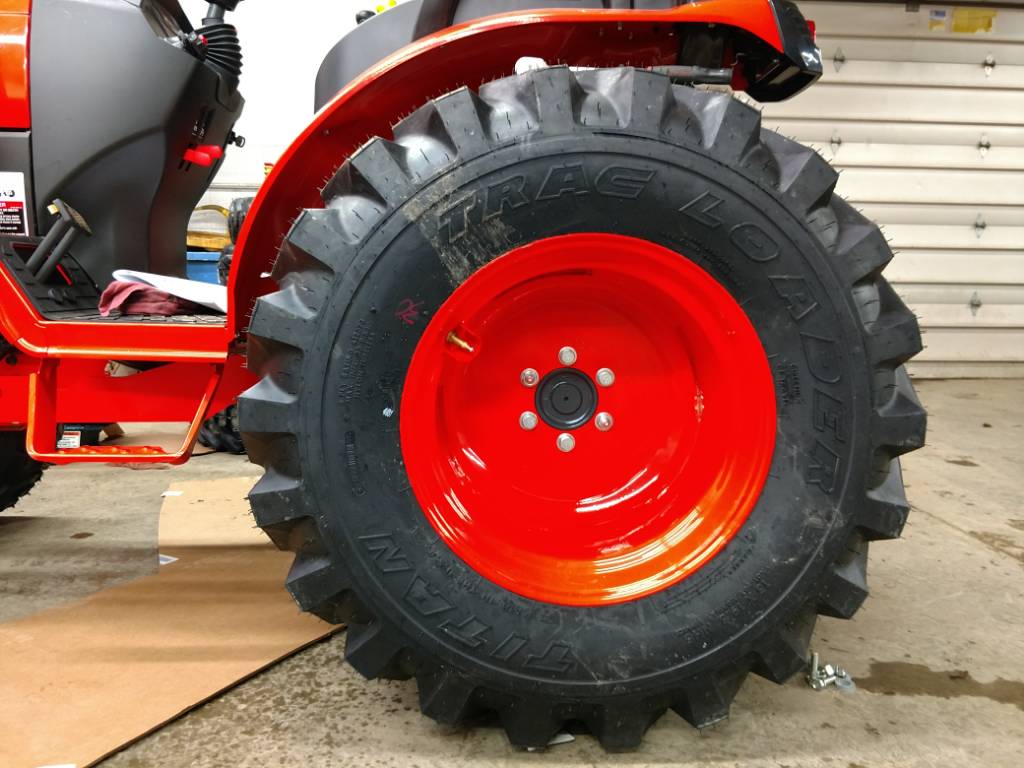

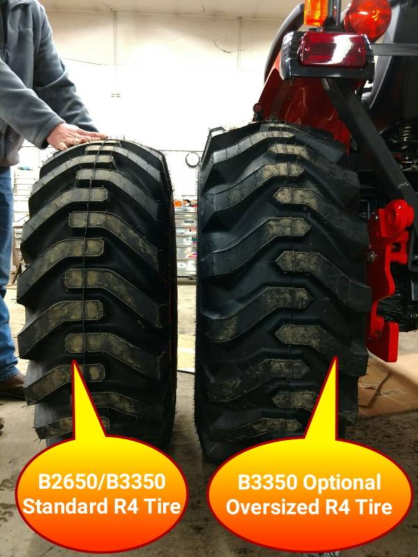

I run the wheel and tire package that is optional when buying the B3350SU.
According to a Kubota engineer response, it costs me 7.?? Percent of the designed gear reduction.
But, it adds a lot more fluid fill weight for my hills, it takes my width to 60.5" in the rear, it gives more aggressive tread design and it has much greater surface area... So it has at the least, equal or possibly less ground pressure per square inch to allow for less damage the grass.
Oh, and it looks cool as heck 1515543341-picsay.jpeg1515543521-picsay.jpegIMG_20180109_165330657.jpegIMG_20180109_165340882.jpeg

The optional tire package includes no changes to the basic tractor but the increased volume of liquid ballast adds weight and the increased circumference of the tires increases speed, which is the same effect as an increased (lower, numerically) gear ratio.
