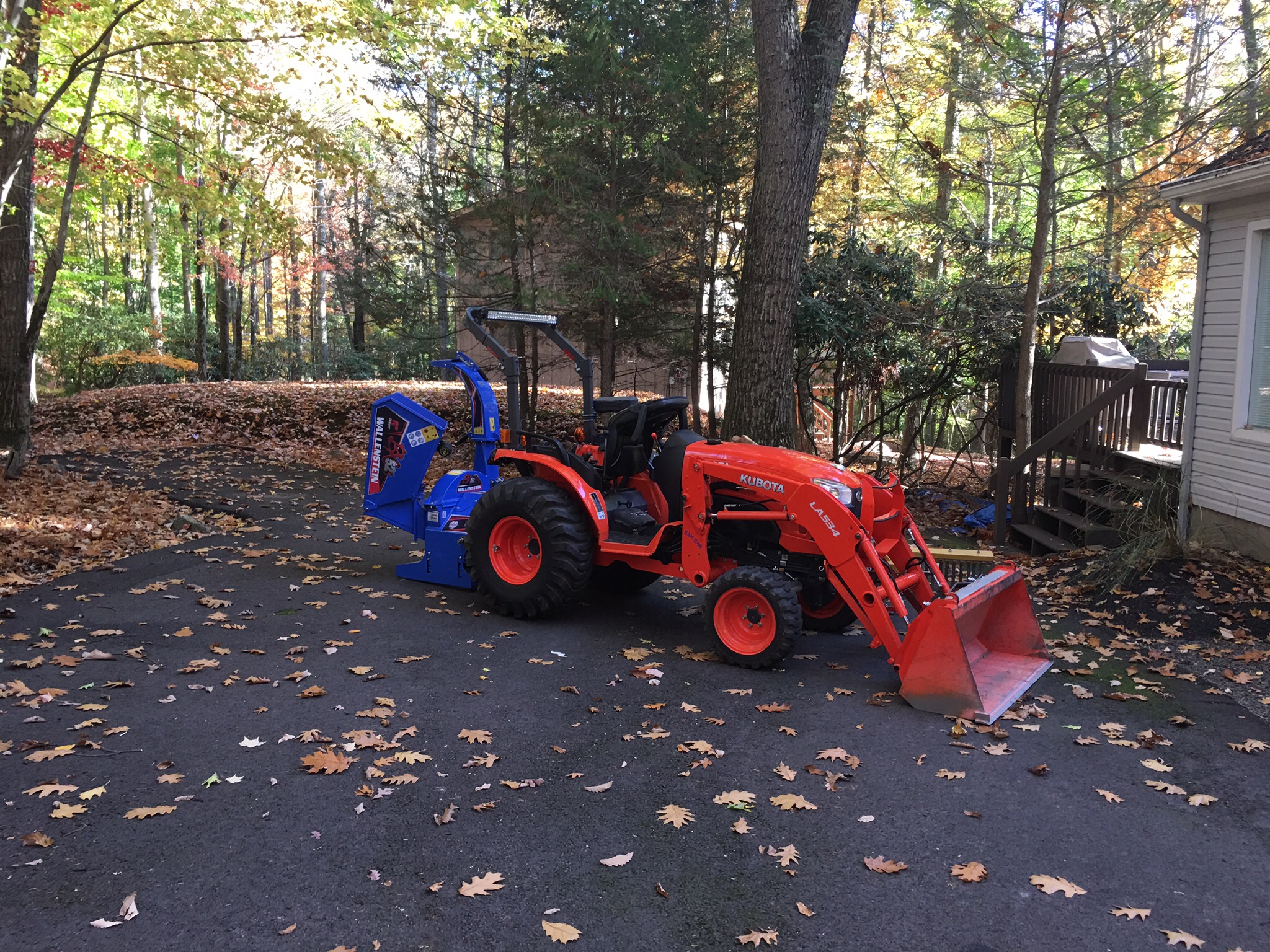

Farm: if it's not too much of an inconvenience, can you measure the overall height of your B2650 with the R4 tires. My nearest Kubota dealer is about 60 miles away so just want to get a sense of whether the tractor may fit through the door before I request that they come out and verify.
Sorry, been away for awhile. Busy getting ready for winter. I measured my door and it is about 84 1/2 inches tall. I have some pics on my phone that I will try and upload. I have about 1/2 an inch between the top of the cab and the trim. Keep in mind the top of the cab is not flat but rather curved, so it is only close in the center and has more clearance as you move towards the edges.
   / Kubota B2650 - Options to make it clear the garage door? #16
I had the exact same problem with my 2650 and 7 ft. door . My garage was away from the house so I took off the top trim and added a strip of wood on top of the door to make up for the gap and it worked out okay for me . I do have R4 tires on mine .
