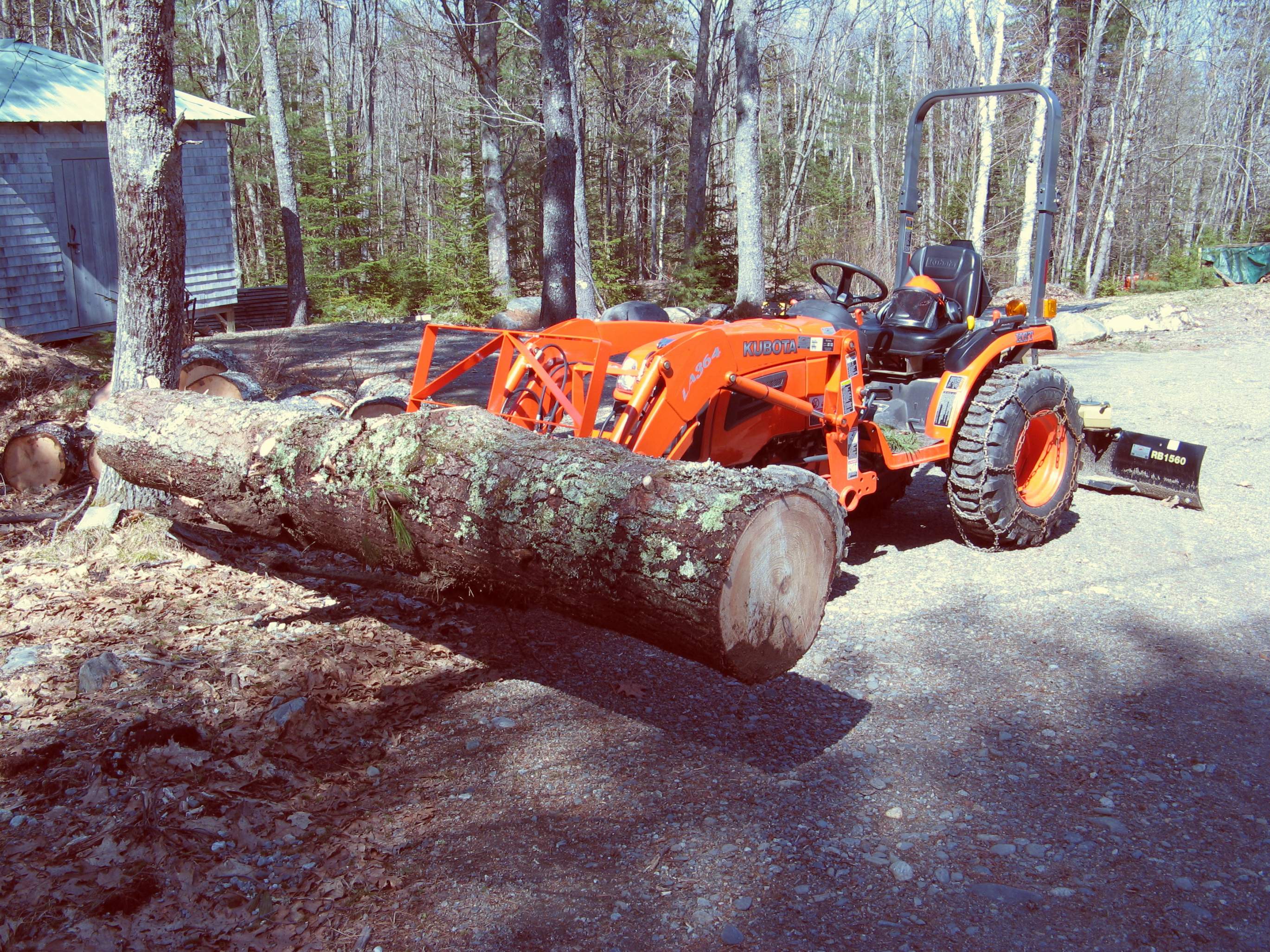

You sure have been busy with that B of yours, and I'm glad you had it to help the neighbors out.......... that is a good feeling all the way around. For that kind of work, you might want to think about adding the Kubota quick change or a skid steer quick change to your loader arms, and getting a set of forks. I added them to my B2620, and found them more useful than I ever imagined for handling logs, brush, rocks, and even pallets on occassion. :D I thought they were a bit expensive when I bought them at $200 + for the QA, and around 1K for the forks, but I never thought about the price again once I started using them.
Oh yea, you guys don't have rocks.......... wanna buy some?
Yes, I'll vouch for the forks too. I've moved logs, popped rocks out of the ground, set rocks, turned rocks around, planted trees, popped bushes out of the ground and transplanted them. You can just come up to a tree with a heavy root ball and pick it up. Oh, and put my generator in my pickup to loan to a friend. They are very handy and save your back from trying to shove things in the bucket. Plus the loader will lift more weight with them than the loader and with bucket will. They are nice but not cheap either.

picking up logs with the forks :thumbsup:
   / Kubota B3300SU Pricing #68
Those forks sure are handy! I swear that I need two tractors sometimes though, so I can use everything at once. :D :D Then I could have the box blade, and bucket on one, and the forks, and my chipper on the other.............. or maybe a backhoe......... Hey, maybe three tractors would be best, especially if I kept my Simplicity for mowing. I can see how you could get that problem pretty easy, especially if you lived close to a good dealer.
