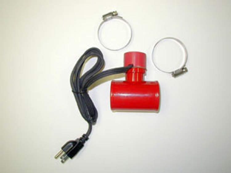

While we are on heaters, here is the model mentioned earlier in the thread that worked great on my pickup truck in a very cold climate. It's a KATZ 1500 watt lower radiator hose that had a heater hose connection to the block and this caused the coolant to circulate. This is the only one that worked for me and the truck was warm the minute I fired it up. I wouldn't use it on a tractor but for a truck it was great.
Here is picture of it and this is the one you want.

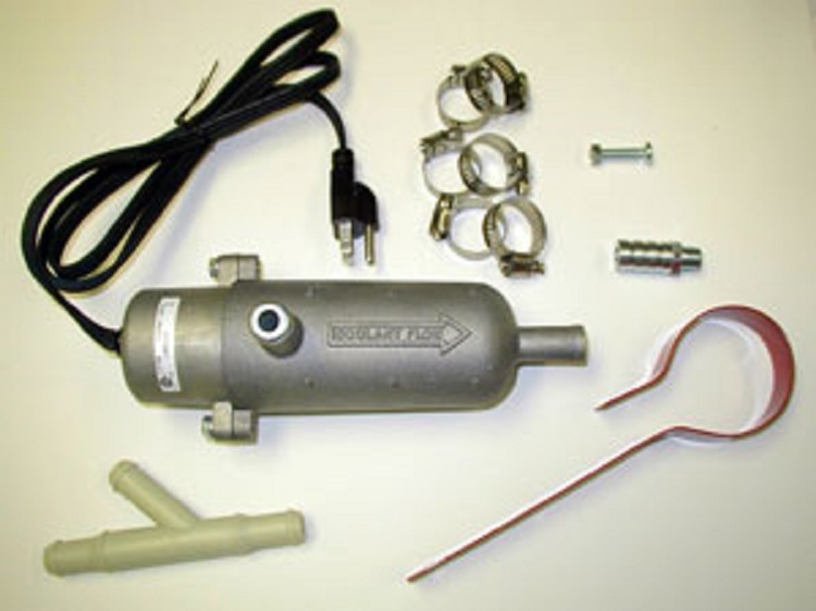

There is also a radiator hose heater only and without that heater hose circulation it really doesn't work very well in a cold climate. Here's a picture of that one that I found not as good as the first.
Just my two cents on this...
