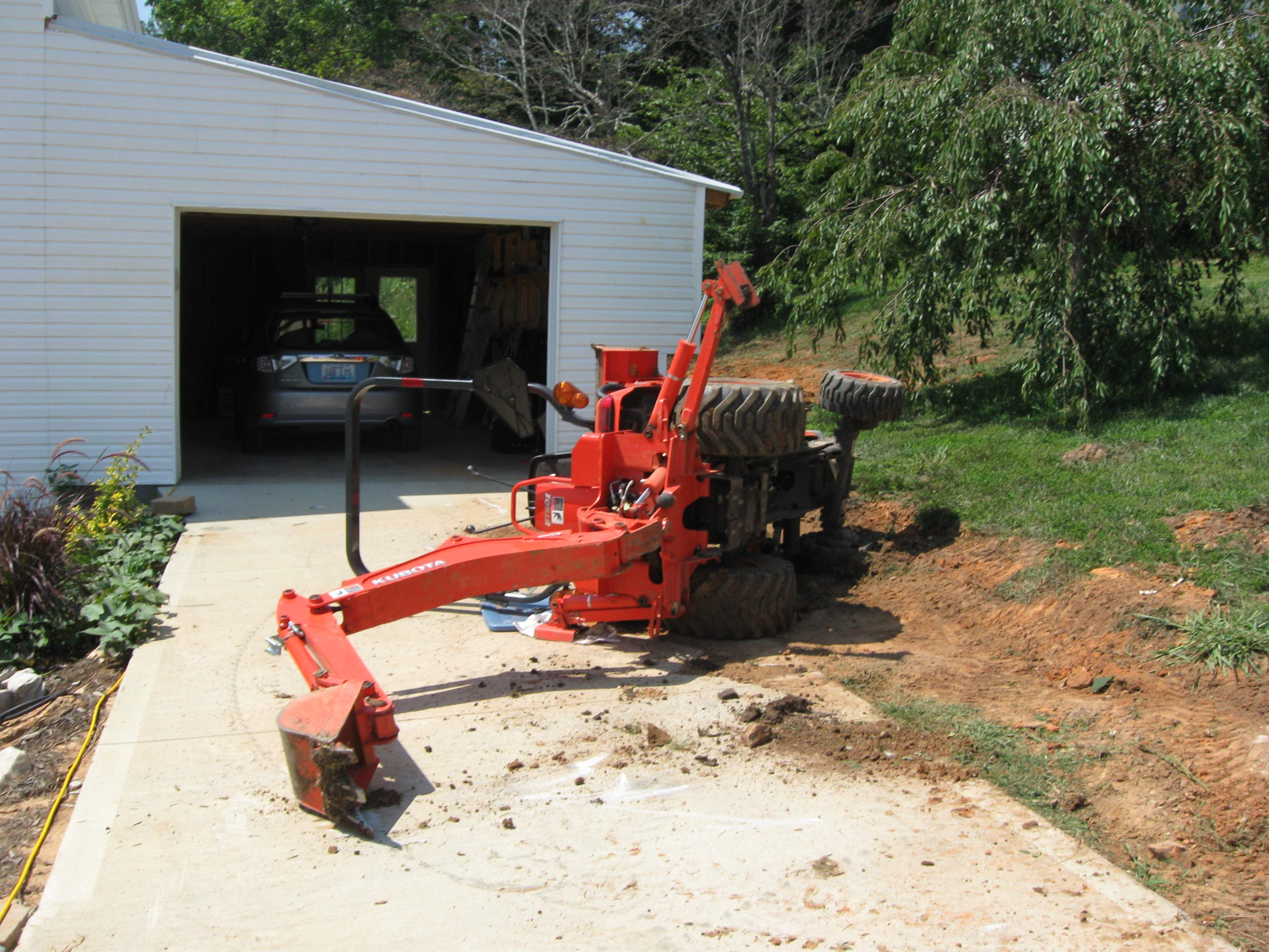

Several of "us" have dropped stuff in the fuel tank over the years. Usually a cap, lid, spout, ring or something from our fuel can. Some threads in the past. The best method to retrieve the "stuff" is to turn the tractor upside down and shake it till the item comes out :D but most of us aren't that strong. Or lay it on its side and maybe it'll roll out. :eek:I did finally get my part out (I think mine was the pour spout) by letting my wife have a go at it with a full tank of fuel which made it float near the top where she could see it but I never could. It never hindered the running of my tractor but just knowing it was there bothered me. IMG_0992.jpgIMG_0992.jpgIMG_0992.jpg
