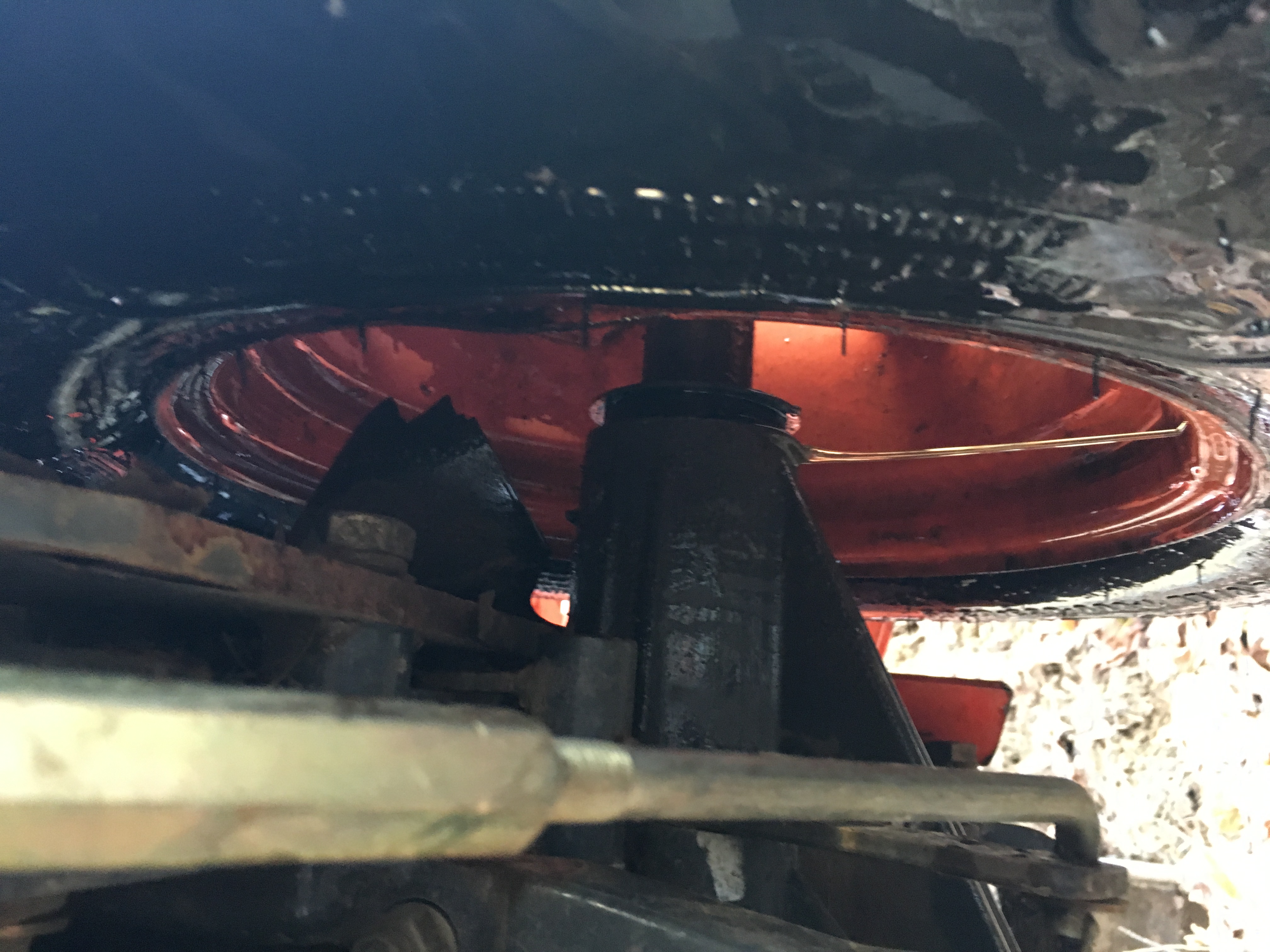

I called the dealer and their guy can't pick up BX23 until Dec 5th
The day of the leak I took different angle picture shots and this new posted picture is interesting.
If you look at the stream of hydraulic fluid streaming in this new picture, it seems to be coming out of the axle
and not from above it. What do you guys see? If this is the axle seal, is this hard to change?
If one changes the left should the right side also be changed?
The tractor is 1 1/2 hours from me and I will not be able to look closer until Wednesday.
Thanks for the help everyone.

That axle seal is pushed out, something caused it, need to figure that out first. If it was pushed out from excessive pressure you might be able to just drive it back in without replacing the seal.
