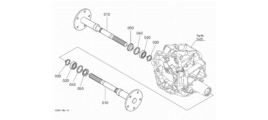

Can anyone describe for me how to knock back into place the metal housing that was pushed out that has the left rear axel seal behind it?
Can I take a metal 1 inch or 3/4 inch socket for example and repeatedly tap with a hammer at different areas of this metal housing and it will evenutally
fall back into place? The dealer is supposed to pick up BX23 next week and I don't know how long it will take them to fix and return the tractor and I only
have about 1 week of warm enough weather to work so my concern is when it is returned the season is over. I took off, had a cylinder repaired then I reinstalled it.
Would you say removing the tire and tapping in the seal is an easier or harder job when compared to the cylinder?
Can I use the BH legs to raise the rear tires off the ground to get the left tire off or will this cause pressure and
prevent me from properly tapping in the seal?
Thanks everyone.

If all your fluid leaked out the axle seal I would not start the tractor up to put the backhoe stabilizer down as you probably do not have enough fluid in the system.
You can go to Messicks and look at the parts breakdown.
Use a jack underneath the rear hitch plate and remove the wheel .
The seal is inside the round metal ring it is light metal and can be bent or warped if not driven in carefully.
You have the seal on the outer most part of the axle then the internal snap ring that keeps bearing into the trans case, the bearing and then the external clip that holds the axle in behind the bearing.
You should be able to slide a wrench over the axle and be able to tap the seal back in just make sure it goes in square and goes in evenly. Refill the oil to the top of the dipstick and should be able to run. Keep an eye on the seal and if is not leaking you the overfilling may of just been the reason the seal pop out.

On my BX 2350 same thing happened and I removed tire wiped off surface and applied adhesive sealant to edge of seal and pushed back in. You may not need to remove tire? Mine has held for over 1000 hrs.
