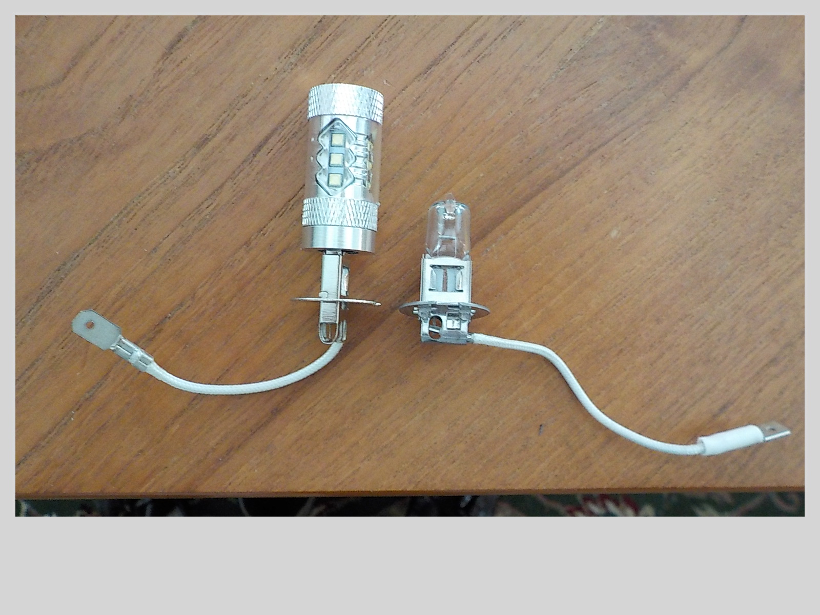

What I got in from Amazon, which sure had a nice spec, is waaaay bigger than stock. Kinda doubt it's going to fit in the oem
plastic housings. So, rather belatedly, instead of my guessing at this again, has anyone already done this and can you advise as to
which H3 LED conversion bulbs fit?

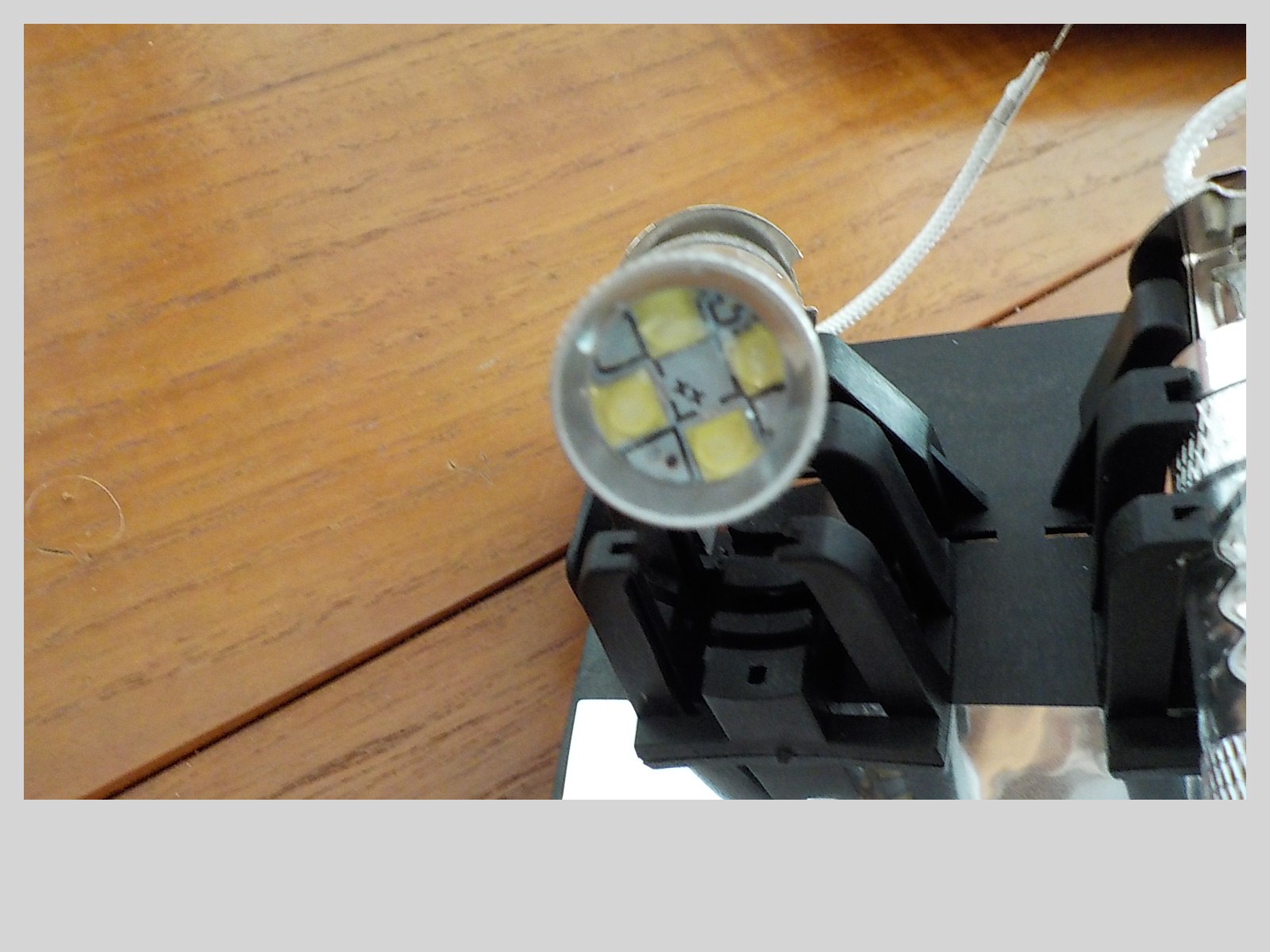

So I'm not quite understanding completely what the last two photos are showing. The black plastic part with the reflector, did that come with the bulbs or is part of the headlight assembly?
Did you try to fit bulb in the housing? Exact what lights are you trying to replace? More photo's would help.
/ Kubota conversion LED lamp bulbs
Mike, the black plastic is only the container it came in, size is shown best in first photo.
H3 bulbs have a standardized mount; it's after the mount that is the issue.
I am trying to replace the bulbs in the optional lighting package that adds two extra lights in front and two in the rear.
No, not yet to try, was pretty sure that big bulb would not fit under the plastic case. Seems to be designed to replace standard headlight bulb, not a smaller cased auxiliary light.
I'll take another pic today.

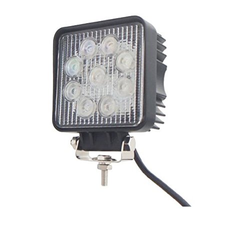

I'd swap the whole unit on work lights if you are going LED. The 9 LED square or round work lights have the whole back of the unit as a big aluminum heatsink to keep the LEDs cool. A bulb doesn't have a huge heatsink like that. So either the LEDs are going to fry themselves or the bulb is a lot lower power.
Heat is the enemy of semiconductors & it will kill them quickly without adequate cooling.

I would also replace the whole housing. We have some of these on the L3830: Amazon.com: TMH 27w Square Shape 6 Degree LED Work Light Flood Beam Spot Lamp Off-road, 4wd, 4x4, Utv, Sand Rail, Atv, Suv, Motorbike, Motorcycle, Bike, Dirt Bike, Bus, Trailer, Truck, Train, Mining Truck, Excavator, Bulldozer, Crane, Road Roller, Fork Lift, Fire Engine, Police & Rescue Vehicle, Military Vehicle, Camping, Courtyard Lamp, Fishing, Boat, Yacht, Road Lamp, Street Light, Fog Lamp, Day Light: Automotive
I have been very happy with them.

due to the holidays I got pretty distracted but finally got time to work on these lights yesterday.
A complete bust.
the new bulbs have zero chance of fitting in there, the oem Kubota lamps are sealed/glued together in the front, can only insert bulb from
rear through small hole (big enough for a small halogen bulb...) while replacement bulb diameter was way too big.
Back to the drawing board. First, bulb has to fit through hole, for sure, second it can't be too long to hit plastic case.
At least I know I'm looking for something much much smaller now.

The problem is that to make enough light with an LED you need to dissipate heat and that takes surface area which you don't have room for in the hole that a halogen came out of.
Thats why you generally just replace the whole fixture with and LED one.
