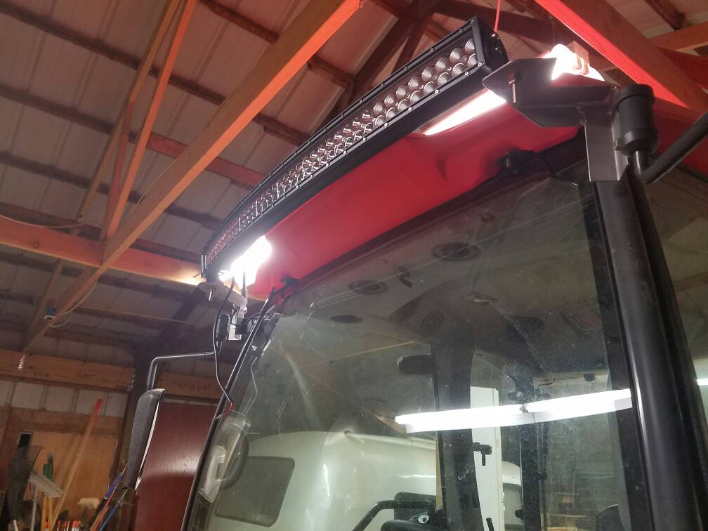

No, but I did a ton of research a couple years ago retrofitting HID projectors into the OEM housing on my Tacoma. My HIDs focus perfectly & have a cutoff just below the car in front of me so they don't blind people.
I've pulled the new front cab halogens on my L4060 & am putting in a 43" led light bar up front & 52" in the rear.
Brackets are all finally fabbed up & just need paint. Going to be running a new circuit directly from the battery with appropriate fuses & relays to power them.
The 52" is suppose to pull 300 watts, but when I hook it to my bench power supply & fiddle with voltage between 12 & 14v, it tops out at 170 watts. When you look at the light bar it has about a dozen 52" long find 2-3" tall, pretty in line with most LED lights. Thats massive surface area very close to the LEDs. When you compare it to the really long flexy strap on those headlights, there is no question it's a lot more surface area much closer to the heat source. The length of those straps really makes the part next to the bulb do most of the work.
I gave up on my headlights right away. To hard to fit in a decent LED & impossible to properly do it in the OEM housing. The killer for me is, even if I did it right, I'd just blind myself with glare off the back of the bucket or loader & still get no light infront. So I went with something mounted in a better location.
In addition to running hotter, halogens put out their light on a tiny filliment. Even if you crammed a pile of LEDs right next together, they are more bulky than that filament. So ignoring the fact they would cook themselves at that density, they would be emitting light hitting different parts of the reflector & coming out of the housing in a very non optimal pattern. HID bulbs are about the same as halogens can't even work in a halogen housing terribly well because they emit light from a different part of the bulb than the halogen filaments.
If you've ever been blinded by a vehicle with really blue headlights that weren't OEM, that is the reason. They stuffed a HID bulb into a halogen housing. It doesn't focus right so throws light everywhere even on low beams. Granted blinding oncoming drivers isn't really a tractor problem, but it does illustrate how light isn't focusing where it should be for proper illumination.

Paul, I'm glad you chimed in, and thank you, you are pretty much considered the guru of these projects. However, yes, the headlights make sense, these aftermarket bulbs are so much larger apparently to dispel heat, the one you used even had a fan on it it, like a computer chip or zrt motor. But did you ever try to replace the bulbs in the smaller lights?
Maybe one can't...
Downsizing, thank you. I would expect you to offer me tips on downsizing...:D
It's pretty clear to me the answer here is to just ditch the oem lights and replace them with LEDs. I opted to add to what I had, thinking more the merrier, and having a diffused flood pattern from the oem lights would have been fine since the new LED's in front have a built in spot and flood function. Yes, getting blinded by headlight glare bouncing back would not be good, good point Fallon. Paul, you ever have problems with that with your new headlight bulbs? Particularly in your area where you are working in snow all the time, blowing snow and lots of light would make a whiteout condition I think, how has it been?
