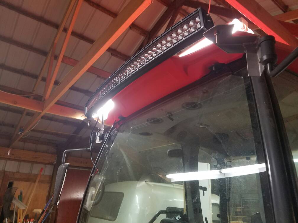

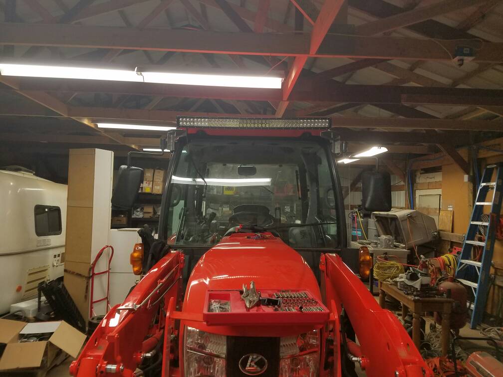

No, but I did a ton of research a couple years ago retrofitting HID projectors into the OEM housing on my Tacoma. My HIDs focus perfectly & have a cutoff just below the car in front of me so they don't blind people.
I've pulled the new front cab halogens on my L4060 & am putting in a 43" led light bar up front & 52" in the rear.
Brackets are all finally fabbed up & just need paint. Going to be running a new circuit directly from the battery with appropriate fuses & relays to power them.
The 52" is suppose to pull 300 watts, but when I hook it to my bench power supply & fiddle with voltage between 12 & 14v, it tops out at 170 watts. When you look at the light bar it has about a dozen 52" long find 2-3" tall, pretty in line with most LED lights. Thats massive surface area very close to the LEDs. When you compare it to the really long flexy strap on those headlights, there is no question it's a lot more surface area much closer to the heat source. The length of those straps really makes the part next to the bulb do most of the work.
I gave up on my headlights right away. To hard to fit in a decent LED & impossible to properly do it in the OEM housing. The killer for me is, even if I did it right, I'd just blind myself with glare off the back of the bucket or loader & still get no light infront. So I went with something mounted in a better location.
