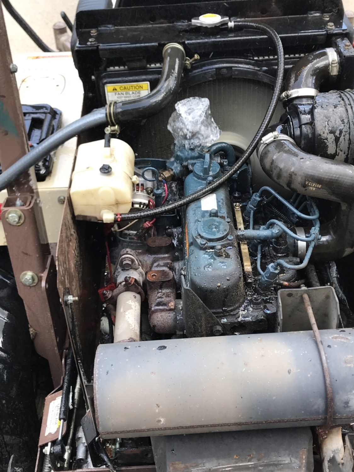

Well this might not be the by the book method to flush a cooling system but it looks pretty flushed and confirmed the water pump is working.
Nothing wrong with a straight water flush.

I just finished mowing about 2 acres with the straight water in the radiator and it didn’t overheat. The gauge stayed in the middle of the range. Checked with my ir thermometer the block is about 210 degrees and the radiator is 190.
Would still do a chemical flush then pull the radiator and do a proper cleaning of the fins. You *might* be able to use something like radiator cleaning foam, or acid, without pulling it, but I would just pull it to be certain.
And please do put a thermostat back in. More efficient that way as it not only allows faster warming, but also regulates the water in the block allowing it to absorb as much heat as it can. Especially from around the top of the cylinders and head.
