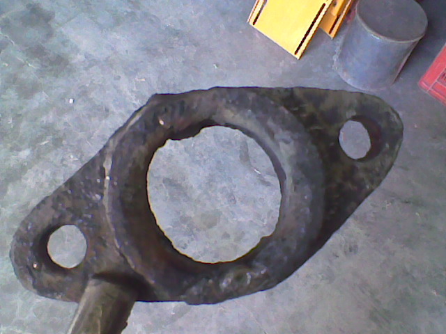

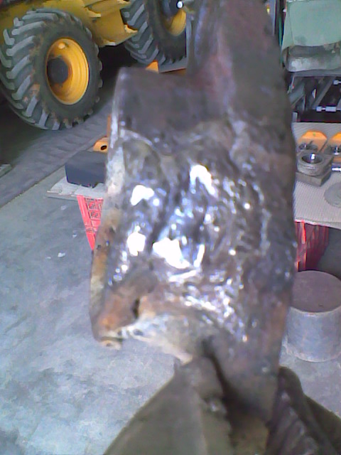

i've had good results with nickel rods, have done anything from pump glands to slip clutch housings. Dont be in a hurry, v the edges, little pre-warming, tack together if loose piece, dont let the piece overheat, weld stop weld, to keep temp as constant as possible.
IMPOTANT: take chipping hammer and peen ( hit lotsa times on and around welding ) to relieve stress in material.
works every time for me so far.
in the pics i've used dillon cast iron rods, gold marking on rod but you can see the dents from peening and also the gap that was filled in.

Yip, beginning of the Alzheimer stage! Slow cooling very important, let it cool down slowly. The sand/dirt trick works like a bomb.
/ kubota engine block welding #5
Where on the block do you want to weld? Remember to check the deck surface for flatness afterwards if its a large weld and also maybe alignment of crank journals. Had to have a block line-bored before.

Welding cast iron is very tricky; there is a how-to Navy manual that explains in great detail. Preheat is around 350-500 deg., and use dry sand to help the cool down.
