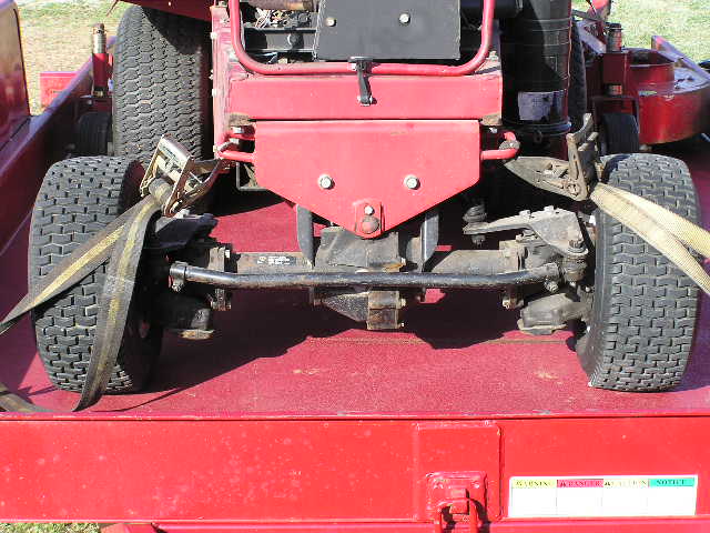

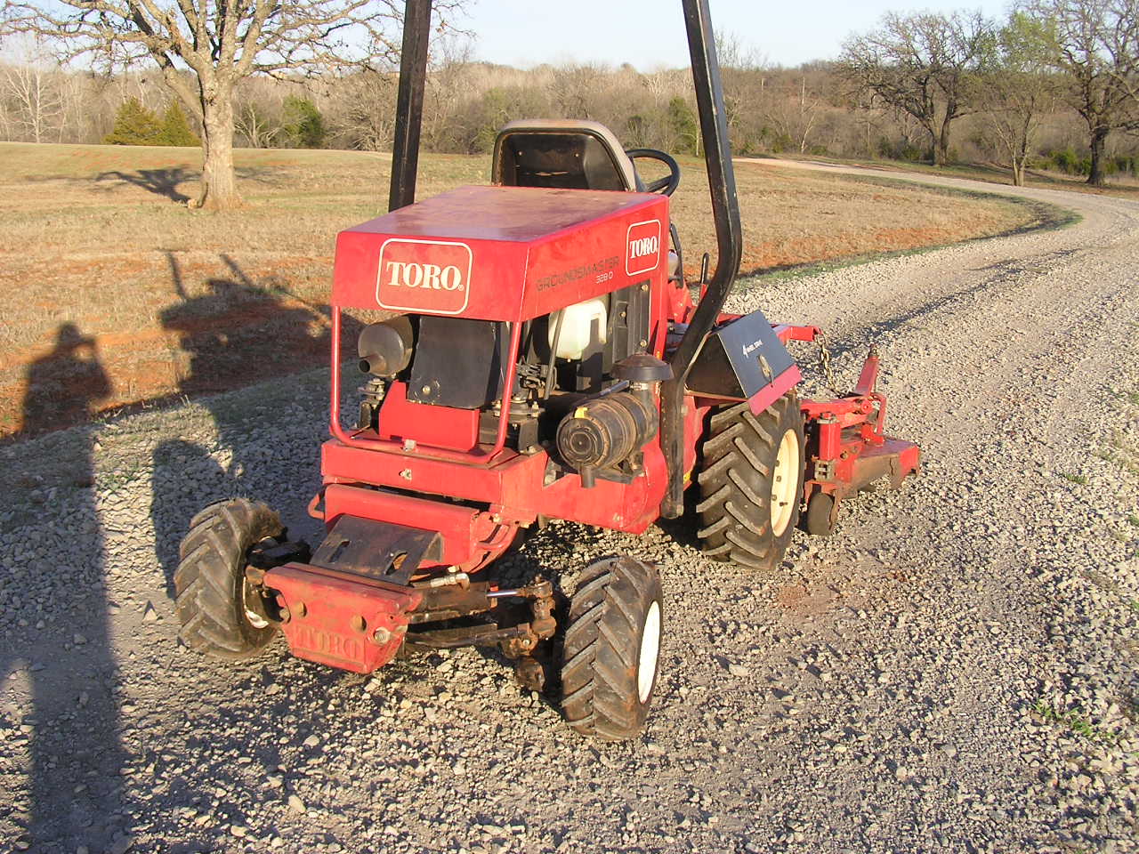

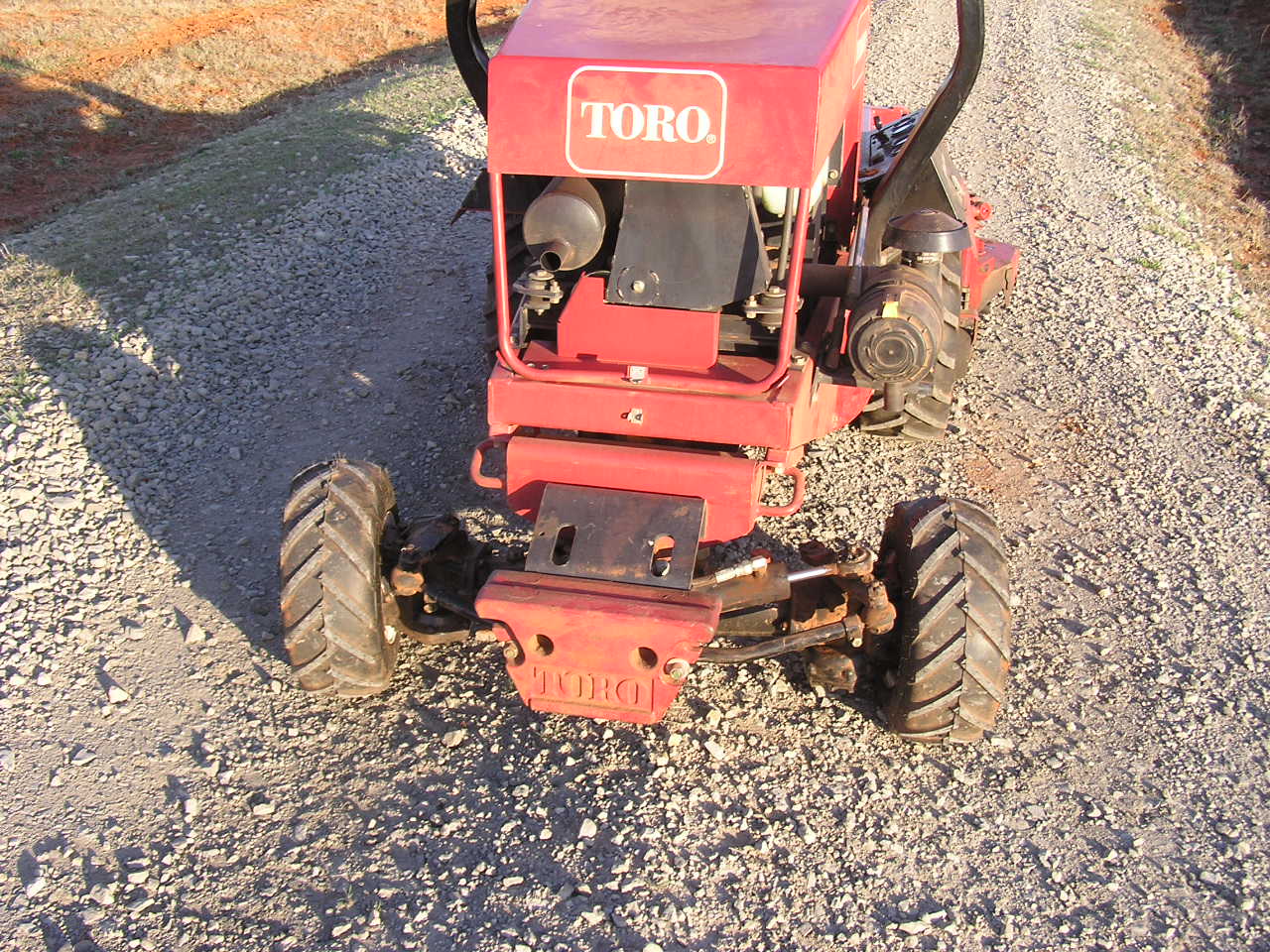

Yep, both of my TORO 4WD front deck machines call for 80w90 gear oil in the rear axle.
The 325D
attachment.php
The 328D
attachment.php
attachment.php
