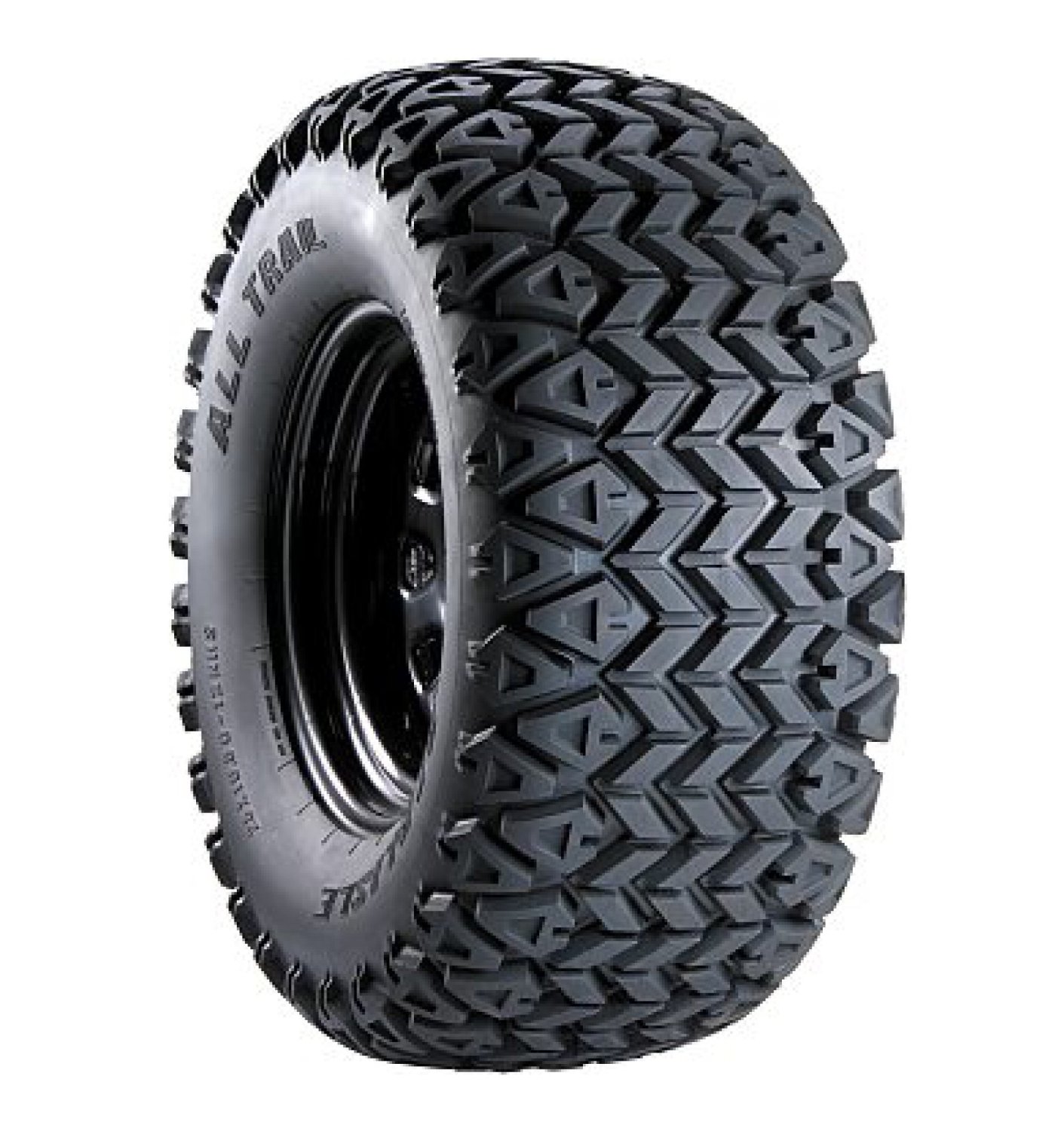

Chevron tires, haven't decided whether I want to crack for them or not. The turfs do terrible...in mud...not to terrible on the slopes. If I was somehow convince they would improve the perceived grip...on the slopes... I'd put them on the F in a heartbeat. For the most part I can avoid the really muddy areas.
I would not go with chevron ("R1) tires if you will be running sideways on slopes. I would install something like the Carlsile All Trail 2: Amazon.com: Carlisle All Trail II ATV Tire - 22X9.50-10: Automotive
You wont lose sidehill traction like you would with R1 tires, you will get more traction than turfs give even in mud and you might even get a little more traction in mud than with R1 tires.
Aaron Z
I was told by a Kubota dealer that the beads on those tires are not as strong as the Chevron. I like you would prefer that atv tire, but the Kubota advice kind of in your face.
