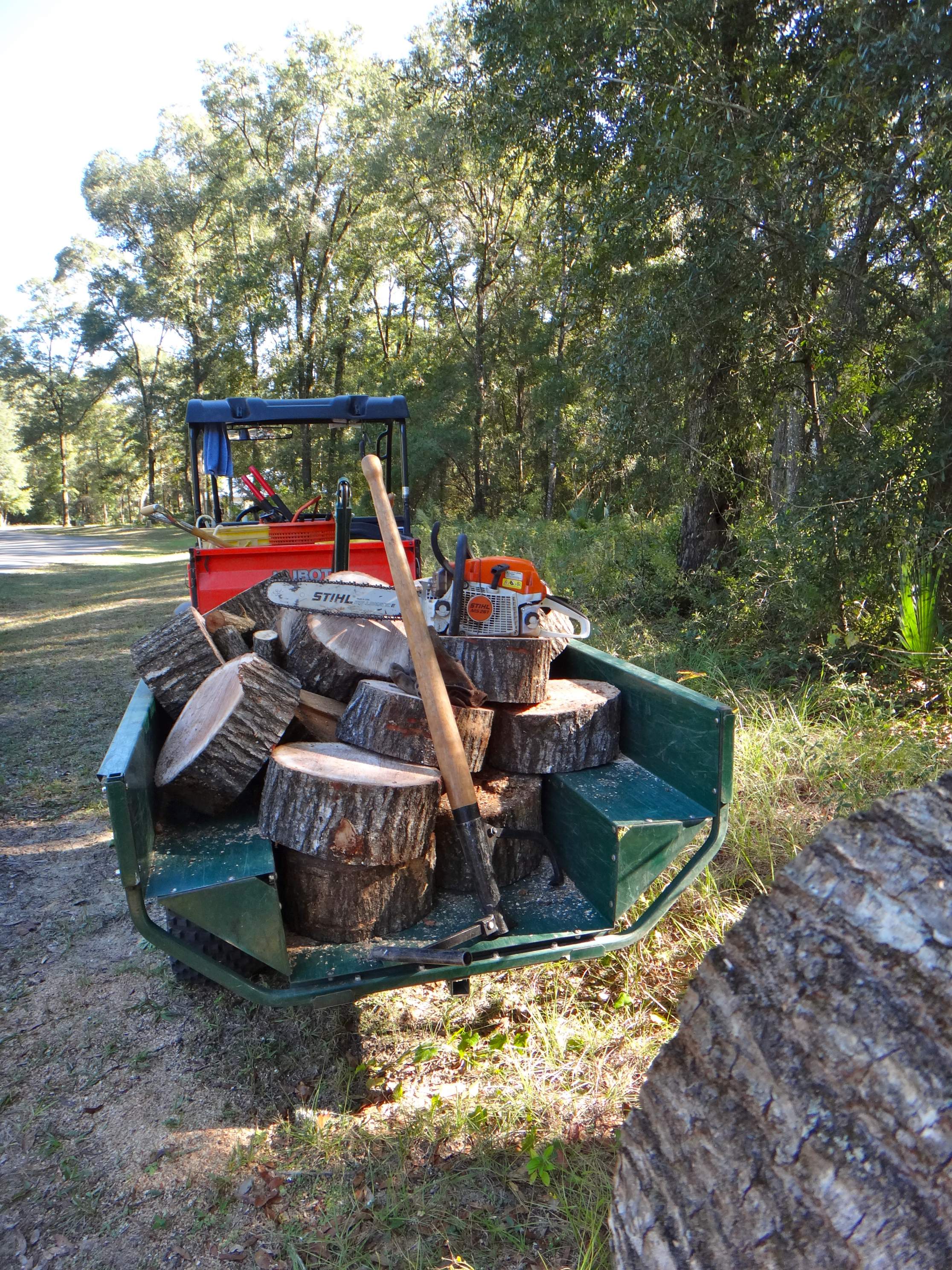

So after looking around our NH property I'm starting to wonder what I would actually do with a compact tractor.
  • Because we won't be there most of the time we will have to get the driveway plowed anyway.
  • Driveway hasn't been maintained so it's going to need three dump loads of gravel mix: spreading and compacting 60 tons doesn't seem practical.
  • If I get ag tires they will tear up the grass, but turf tires won't cut it in the woods, so I'd need a mower anyway.
  • We could use a perimeter drain and some grading in the back yard but most of the rocks are too big for anything but an excavator of some sort. Just measured up one and it's about a cubic yard - roughly one ton. Buried.
  • I do want to make some trails, but so far the tool I've used the most is the Stihl brush cutter with steel blade, followed by a machete.
It looks to me like an ATV with a dump body might be more practical, or a much smaller tractor with a belly mower. Am I missing something?

   / Kubota for NH woodlands #20
Sounds like you are in a similar situation as myself (i.e. lots of woods, need a machine), except I don't have the snow to deal with. A small tractor with belly mower will be fine unless you are contemplating heavy tree clearing work. I have an ATV, but I seriously doubt it will help me grade the road. There are attachments you can buy but they are expensive and I have doubts to how effective a 500-600 lb machine can be.
