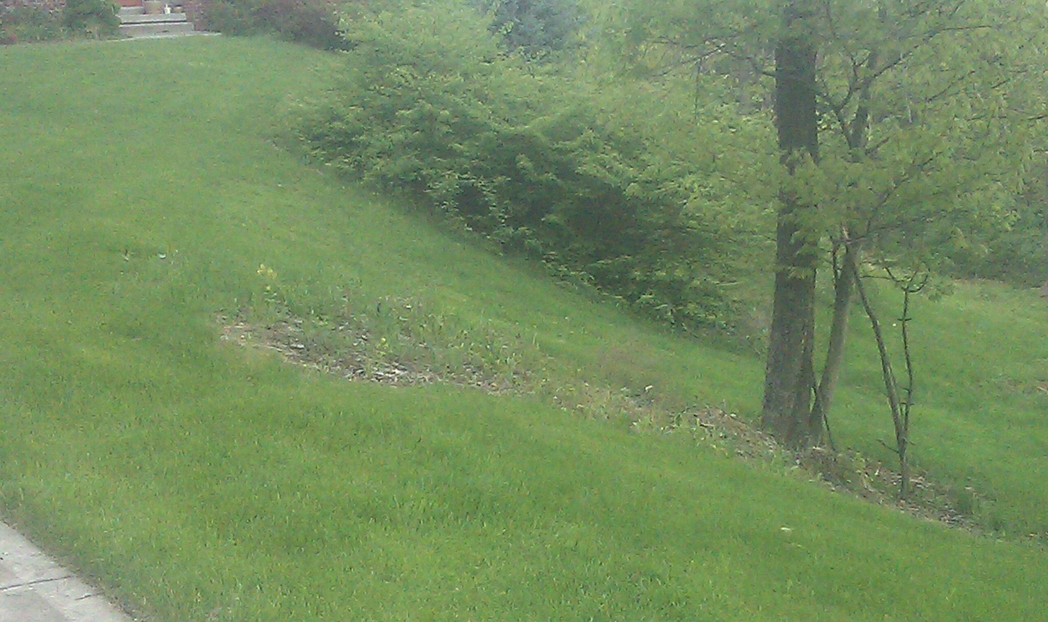

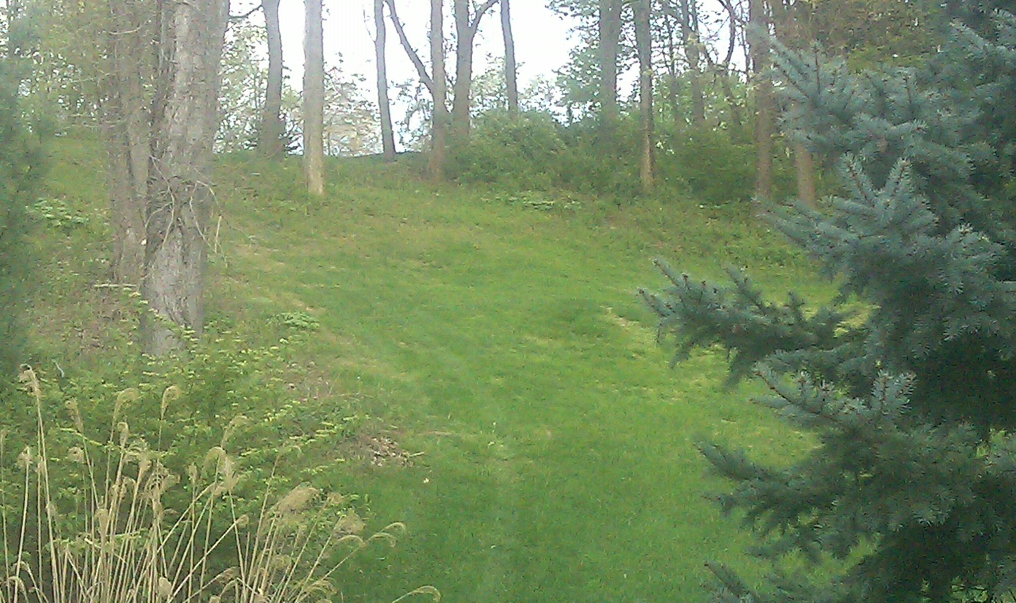

Here are two pictures of the hills that my GR2110 has gone up and down (mostly forward, but an occasional small reverse) without an issue.
From the other posts, I guess I got one of the good ones.
