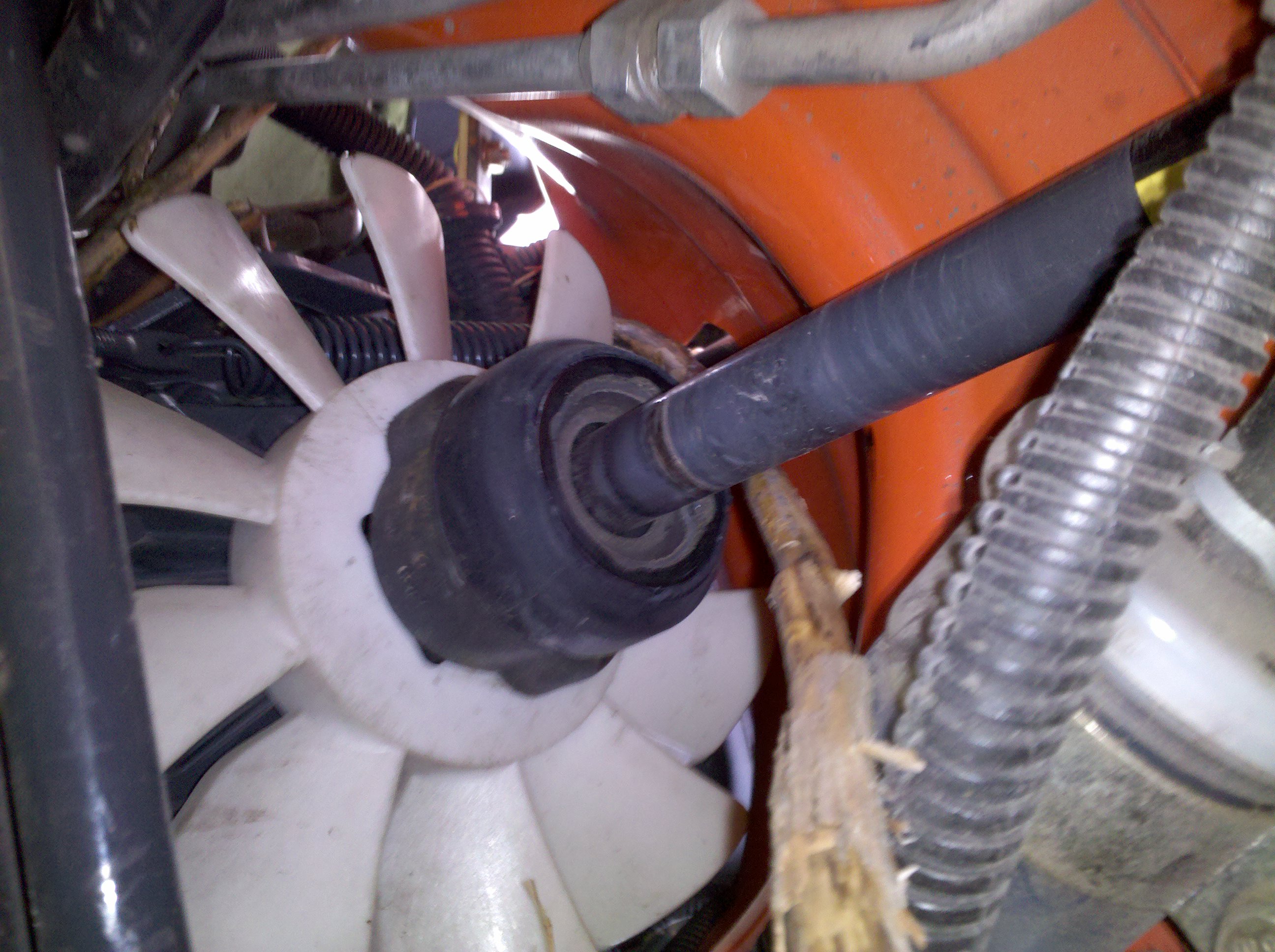

I had a close encounter with a stick trying to break my fan. It barely touched the tip of the fan blades. I heard the sound and was sure that I had lost some blades, but luckily that wasn't the case. I had to cut the stick to get it out.
Did you have the deck or one of the new guards?
WTG pittsville on having the presence of mind to take a photo first.
I credit participation on this site. Just look at the length of this thread, and it is one of many. Makes me VERY paranoid around little branches when the MMM is off.
