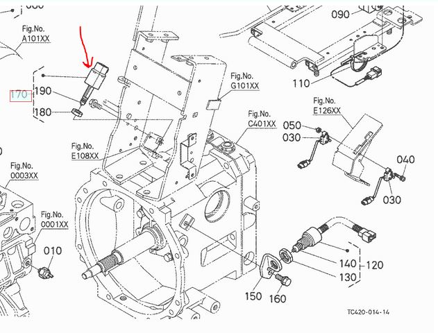

2011 Kubota L3200 HST. I've been rocking the foot pedal back and forth to get it to start for a little while. Today I guess the switch finally quit and left me stranded in the field. I found the safety switch on the clutch and tested it with ohm meter. It tested fine. My question is there a safety switch on the accelerator pedal some where? Please help me find it. Thanks in advance.
/ Kubota HST safety switch problem #2
Let me google that for you.:D Actually looked it up on the Kubota website under parts. complete parts lists are available with diagrams there.
Looks to be on the top right side of the hydrostat transmission on a bracket there.

If it is like the L2800 which according to the diagram it is, then it is adjustable. Go to the left side of the tractor and look up under the dash by the key switch and you will see the safety switch. Then rock the HST pedal while observing the switch and you will get an idea where center is, how it operates, and how to adjust the switch to allow the tractor to start when the HST pedal is slightly off center.The switch itself may have just come loose. It is actually an easy fix.
Thanks guys for all of your information. I was able to find and adjust the switch. I'm now back up and running. This is an awesome site and thanks again for all of your help. :cool2::drink:
