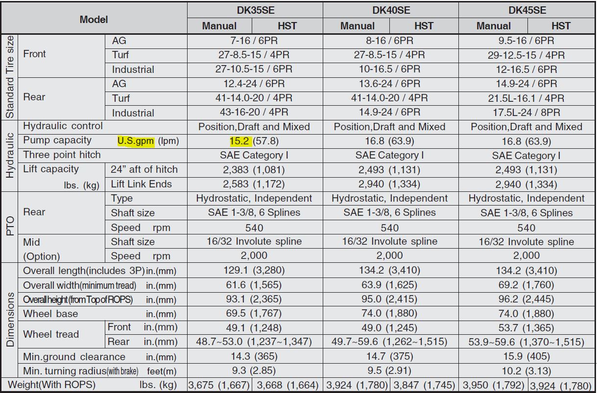

OOOOKAAAY. Speaking of things I don't know huh?.. Your just digging a hole deeper my friend. See the spec sheet below. By the way the 3pt knob right under you seat has NOTHING to do with making the 3pt lift smoothly. It is the drop rate control that allows fluid from your 3pt. cylinder to drain back into your "tank" which is the transmission cavity of your tractor. When I spoke of the Standard L Jerky hitch I was referring to the MLS valve of the 3 point itself NOT the drop rate control which is nothing more than a bleed valve. Your 3pt drops TOTALLY under the influence of gravity and nothing else. All you are doing when you are adjusting that valve is adjusting the rate that the fluid drains, or if you turn it all the way to the right it totally blocks the flow of the fluid. This is useful for transporting a heavy implement on a bumpy road with less stress on the 3pt.
I DID NOT make the comment directed to MR WOLFE about brain rot. I am innocent I tell ya.
AS the highlighted text shows. below the TOTAL flow of the Hydraulic implement pump. However like almost all of the rest of them it is divided into two sections. One section is dedicated to the power steering which is just over 5 GPM and the second sections flows first to the loader and then out the power beyond connector to the remotes (OF WHICH ALL of the DK series is by default equipped with one, which is another benefit of a Kioti and a KUBOTA Standard L is equipped with ZERO by default) and then on to the 3pt. The DK35se (my tractor) is just slightly under 10 GPM, which compares to the about 6GPM for the L3400 Kubota it replaces. Almost ALL compact tractors work this way,
I Don't know why anyone would want to argue about the Kubota I had and the Kioti I have now. There is NO question about the FACTS I stated about the Kioti having more fluid flow, more weight, heavier axles and many many more features for about the same money as a Standard L tractor. (I gave $19,200 including the sun shade) These are just facts they are not debatable. HOWEVER as I pointed out in my first post, we are comparing apples and oranges here. Or oranges and oranges :). The Standard L tractors even though the horsepower is comparable, the Kioti is built more like the GRAND L series of tractors and do not directly compete against Standard L tractors. They compete in SOME peoples minds that create spreadsheets and lists. The WHOLE point of my post was to say that these list's that newbys create DO NOT tell the whole story. MANY things are missed or not understood. For example in comparing loaders. etc. Most Newbs don't understand the importance of telescoping lower links and sway bars either until they have cussed and hooked up their implements a few times. I DIDN'T either. This is my 5th tractor. I have made some "dumbazz" tractor choices in the past.
Digging my hole deeper? You must have delusions of grandeur. You're the one digging a hole by saying a spped control has nothing to do with smoothness. That's literally what it's for, to allow your heavy implements to drop down slowly and smoothly if desired. Do you know anything at all about hydraulics? There are flow controls, there are no "smoothness" controls. Flow controls are what control the rate or speed and thus the smoothness of the motion. You're welcome.
About that pump capacity, does that include power steering also? Or is that separate? Do you know?
