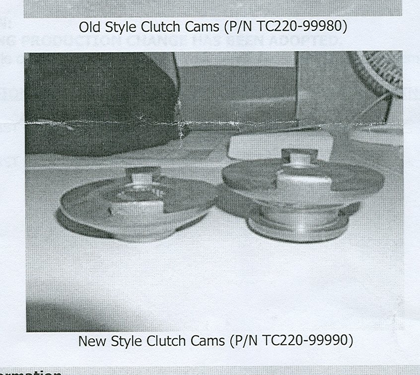

from what i have read (and i am not expert) they changed the over running clutch design so that the newer models don't make the same noise anymore. The one I am looking at is either a 2005 model or early 2006 model.
This is correct. The newer L3400, L2800 and L3700 will not make any noise. The beveled cam which provided the ORC function has been replaced with a non beveled cam. Here is a pic of the new cam.
ccsial,
thanks for your comments in other threads about this issue, they helped me make up my mind to buy the tractor from my friend. I drove it again today (3rd time) and if i slowly lower the throttle I dont get any over running. Then I just disengage the pto. Seems to work great!
