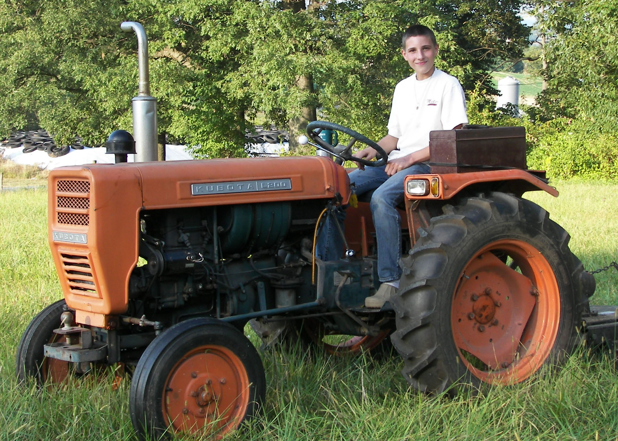

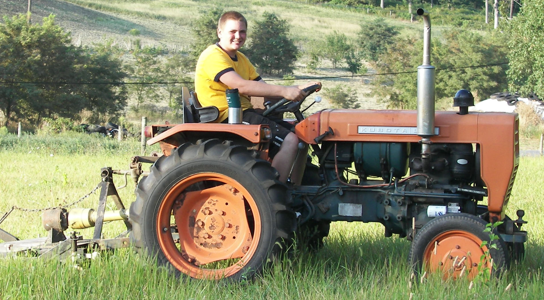

I too was bitten by the cute little Kubota L200 bug. Purchased this one with 1year old 5 ft. finish mower and scraper blade for $2000. Had some braking problems, but discovered it was the rear seals behind the inboard brake drums. No big deal, around $10 to fix. Our two boys think its a real "cool" tractor. Planning on using it to mow about 4 or 5 acres and was wondering if it would handle a 3 pt. rototiller? If so, any idea of what size? Thanks Randy...

Wow. That one looks to be in great shape. I had to pass on 'mine'. Maybe one day. Great to see someone with an L200, especially someone who is using it. Very cool.

Just a follow up on our Kubota L200. After replacing seals in brake drums, we experienced a problem with the power take off. The unit came with a 5 ft. finish mower and whomever had it before us had made a shim plate to try and hold the power take off shaft from coming out. Anyway while we were mowing the pto quit working and gear oil came running out. What caused the problem was no flexibility in the pto shaft (it could not move in and out) and broke the internal snap ring off that holds the shaft intact. After discovering problem it still wasn't an easy fix because it was located inside the case and could not get a pair of snap ring pliers on it. After fishing the snap ring into place with a piece of wire holding one end of it and pushing it on with a long screwdriver the problem was permanently fixed and now everything is working great....except my back which about gave out trying to get that snap ring on and fastened. The boys and I have mowed about 5 acres several times and other than me forgetting to release the brakes one time, everything works as it should..... so, that being said, if you ever find a good looking one.... let me know, we really like ours.........and maybe a second one would enjoy it here also........Randy
