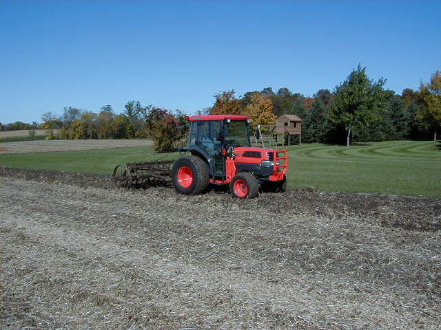

Look at your literature. Kubota does a good job of explaining the spec differences from the 513 to 723 FELs. The 723 is the HD version. It is the loader of choice unless your loader requirements are lighter duty and you will not be removing the bucket. The skid steer quick attach allows you to change from the bucket to many attachments without having to remove and reinstall pins. You simply flip up two levers, lower and tilt the bucket (or attachment) toward the ground and back away. Reverse the procedure to attach next attachment. If you are going to be switching attachments with any frequency, the skid steer quick attach is a must. In addition, because Kubota uses the universal skid steer quick attach, many attachments from Bobcat and other skid steer manufacturers can be used on your FEL. Examples are pallet forks, utility forks (manure), snowbuckets, blades, hydraulic post hole diggers, round bale forks, and the list goes on and on.
As to what size harrow a 3130 can handle, up here in Minnesota a harrow is a ground leveling device pulled over worked soil to break up clods and level. Harrows generally have spiked (6" fixed steel) or spring (12" flexible steel) teeth. My 3430 handles my 20" spring tooth harrow with ease. If you are talking about a ground engaging "field cultivator", something that will sink in 6" or more, then I would recommend something around 6' to 8' (3pt or pull type). I pull a 75 year old 7 1/2' behind my 3430. See picture.
Hope this helps.
