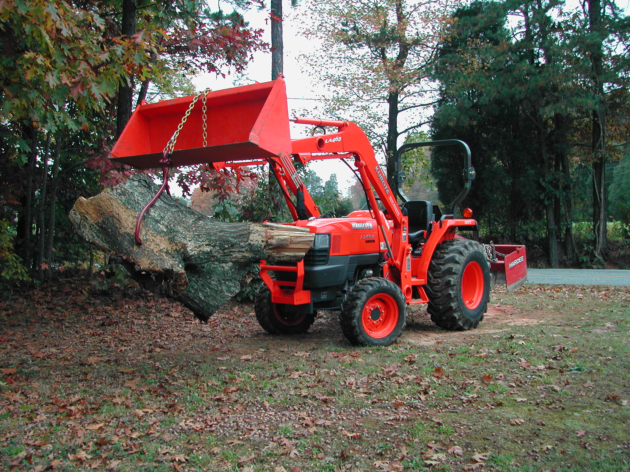

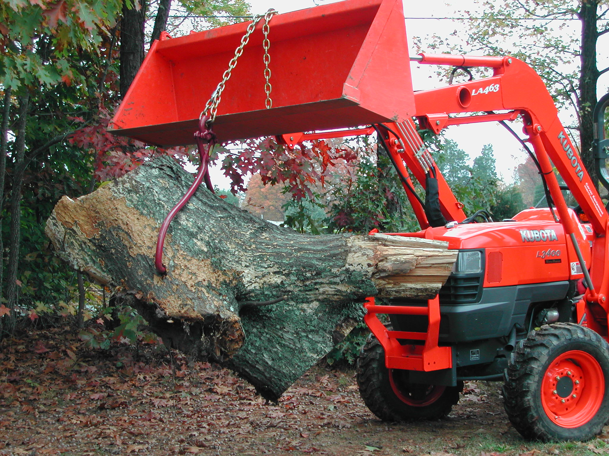

I agree about the loader, I have 30 hours on my L3400 w/ loaded R-4's, 66" bucket Q/A, HST, 2009 from Carver Equipment. $18,400.00 Good luck with your machine. I love mine!!! Hey L.B. let me see you do this!!!!:)
