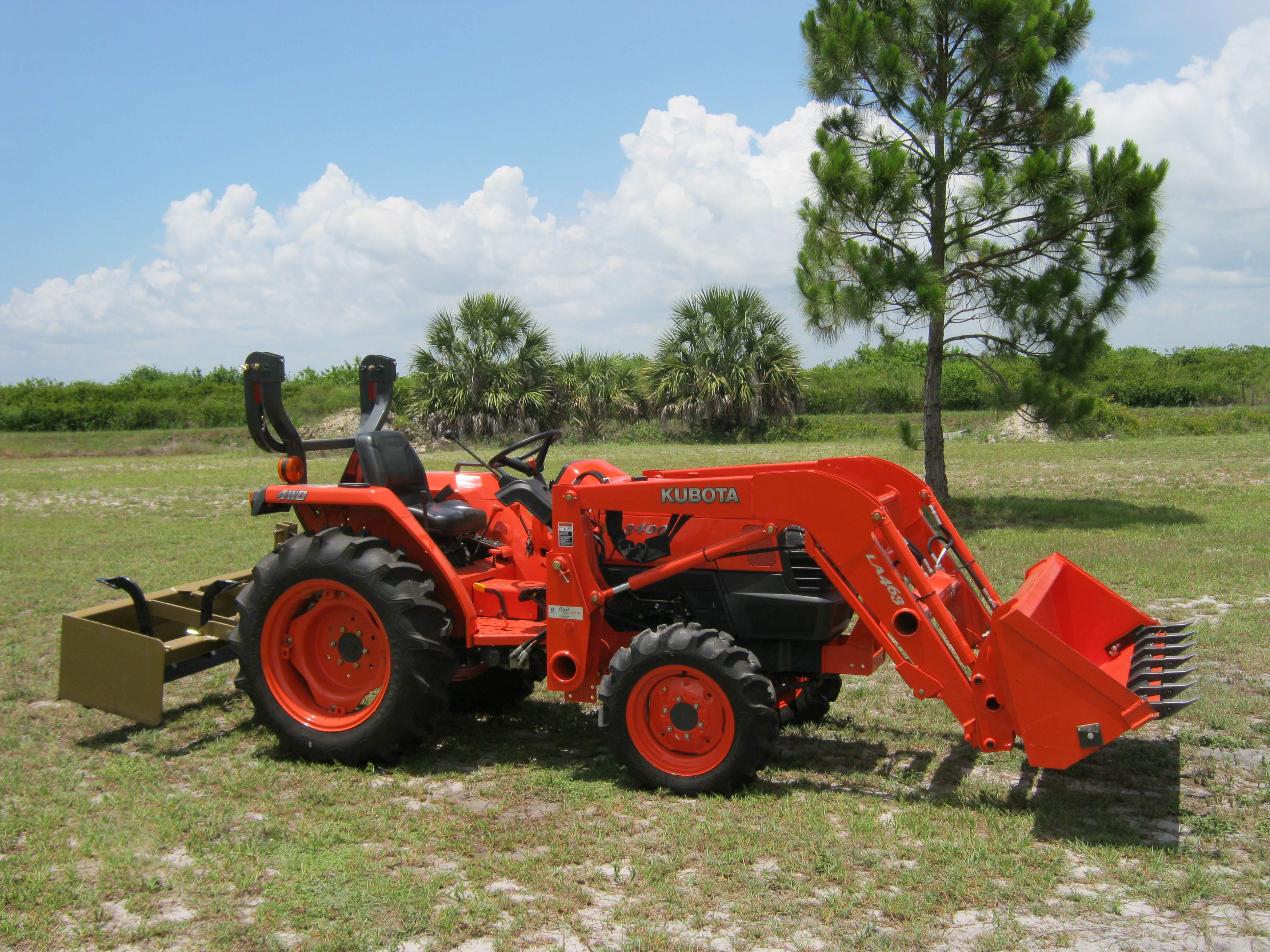

   / Kubota L3400 #43
I have a 2007 L3400DT no jerky 3pt. hitch.Read somewhere that after 70,xxx serial#'s this problem was supposed to have been corrected.:confused2:
Boone
