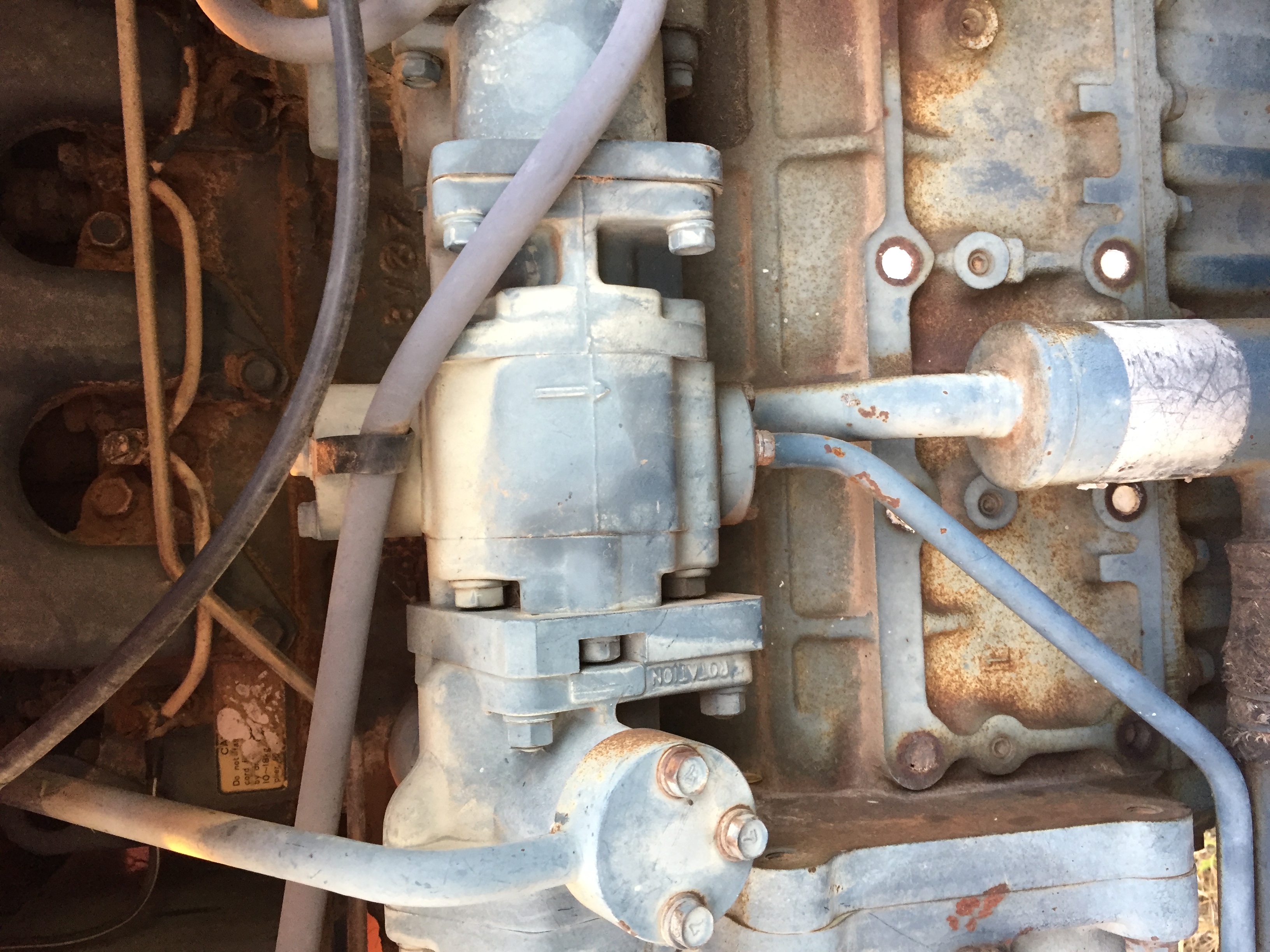

Here is a picture of the pump. I haven't taken anymore pictures but I will this weekend. My PS is Integral. I pulled the Relief valve and inspected it, I put a washer in the relief valve to see if that changed the psi but it didn't change it at all that's why I was thinking the pump was the problem. I bought this tractor a few years ago and have slowly been working on it. The FEL wouldn't move when I first bought it but found there no seals left in any of the cylinders. I also found the outlet was plugged with black sludge. I replaced all the seals and it worked but will not lift a bucket of dirt. IMG_2030.JPG
   / Kubota L345DT Hydraulic pump #22
Here is a picture of the pump. I haven't taken anymore pictures but I will this weekend. My PS is Integral. I pulled the Relief valve and inspected it, I put a washer in the relief valve to see if that changed the psi but it didn't change it at all that's why I was thinking the pump was the problem. I bought this tractor a few years ago and have slowly been working on it. The FEL wouldn't move when I first bought it but found there no seals left in any of the cylinders. I also found the outlet was plugged with black sludge. I replaced all the seals and it worked but will not lift a bucket of dirt. View attachment 527618
Looks like two pumps to me but more photos needed to be certain + a description on which hydraulic line goes from and to.

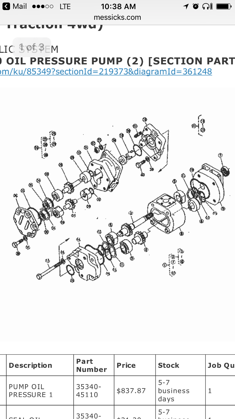

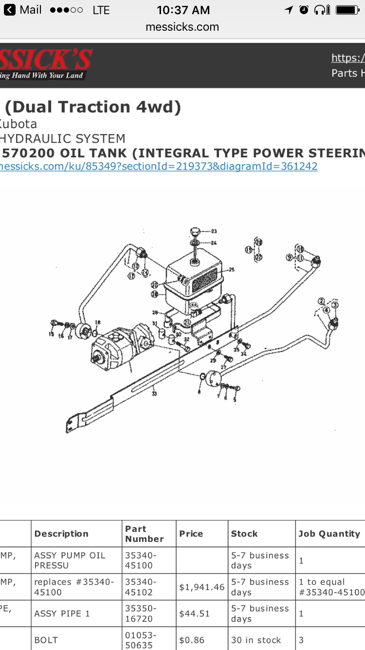

IMG_2104.PNGIMG_2105.PNGI haven't been able to take more pictures but these pictures are diagrams of my pumps.
   / Kubota L345DT Hydraulic pump #24
   / Kubota L345DT Hydraulic pump #25
Pump 2 in the pic above is dedicated to power steering. It has a separate reservoir, separate reservoir, & all. On Pump 1, the inlet is on top, discharge on bottom.
