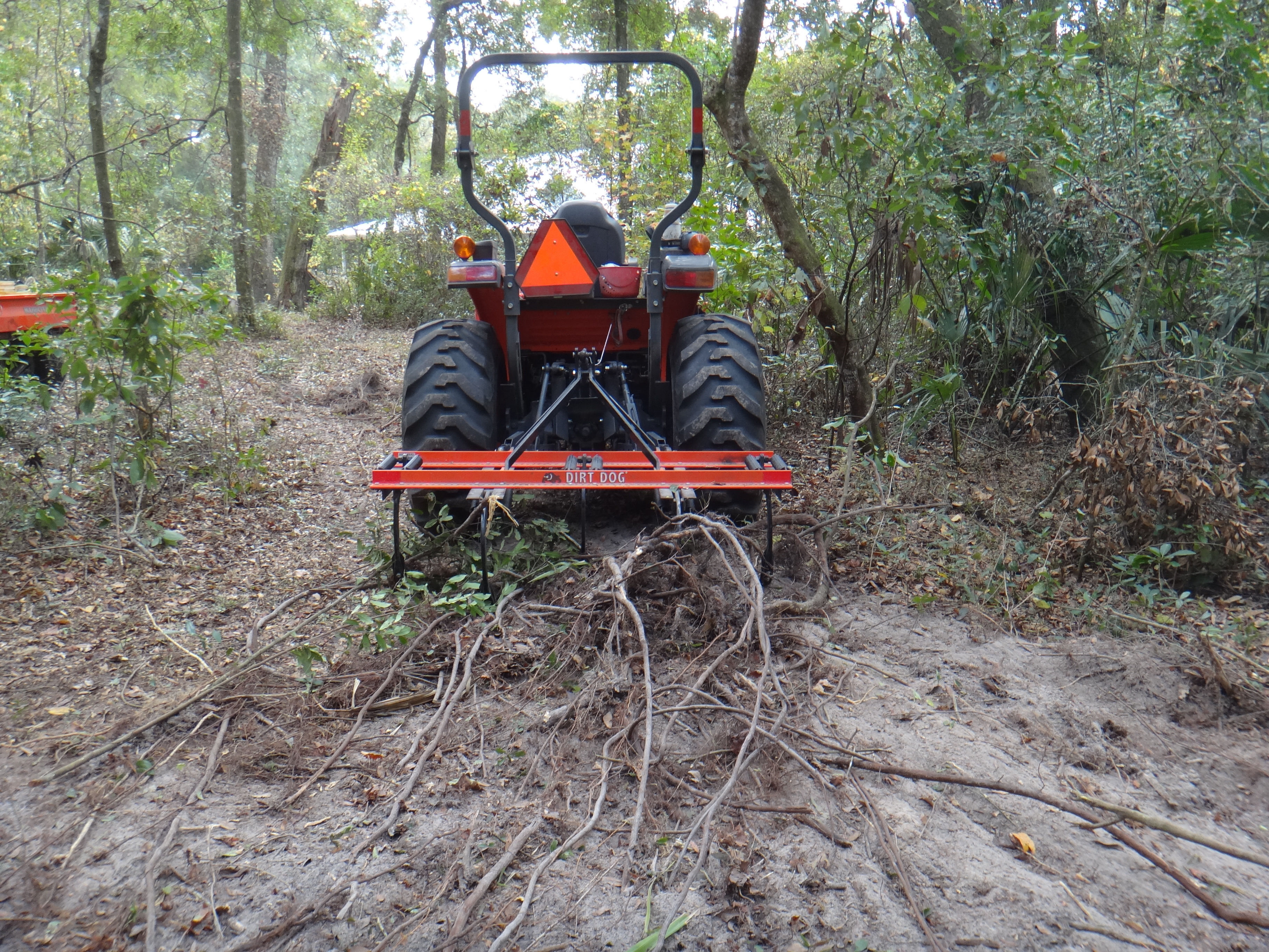

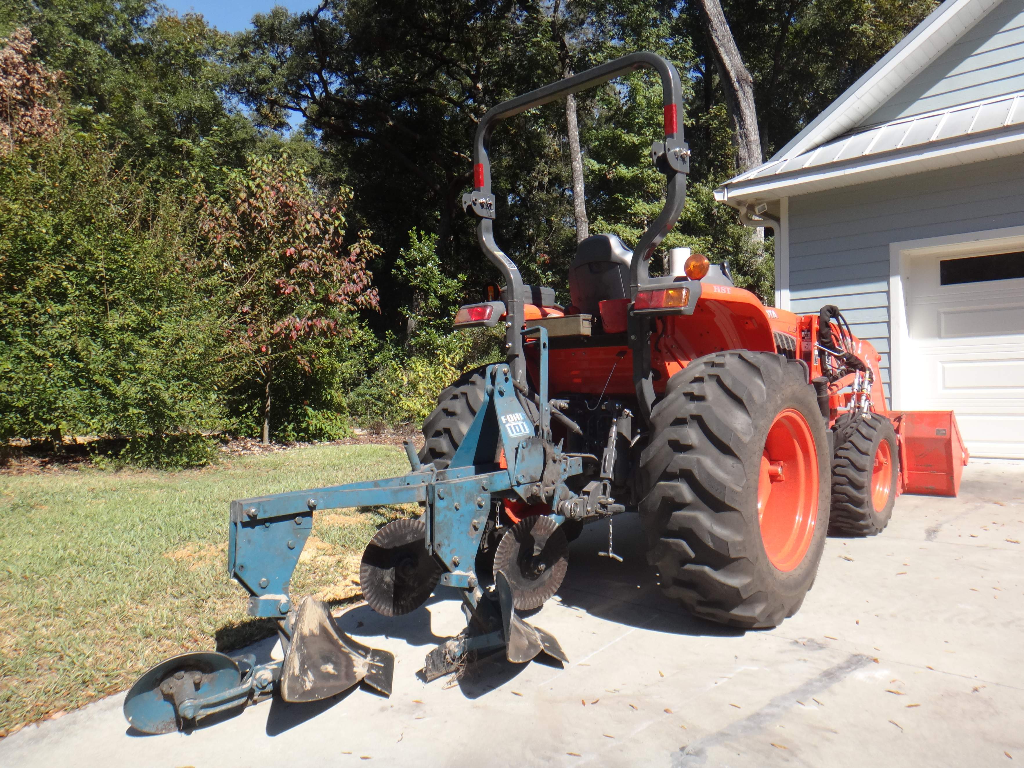

My open station L3560 with R4 tires has an outside to outside rear tire measurement of 62" with front/rear tire centers aligned. Rear wheel/tire spreads on L3560 are adjustable for width with both R1 and R4 tires, so variation will be found. Front wheel/tire spreads on 4-WD L3560s are not adjustable.
Default 4-WD tire spread normally has center of rear tires aligned with center of front tires so a moldboard plow can be pulled. Rears wheels can be set wider but then cannot follow front wheels in a plow furrow.
2-WD Grand Ls, rare birds, have front and rear adjustable wheel/tire spreads. Useful for some row crop applications on flat ground but traction limited.
It seems dealers set the rear tires to match the width of the front buckets.
This makes sense for stability IF pulling a moldboard plow to invert soil is ruled out.
