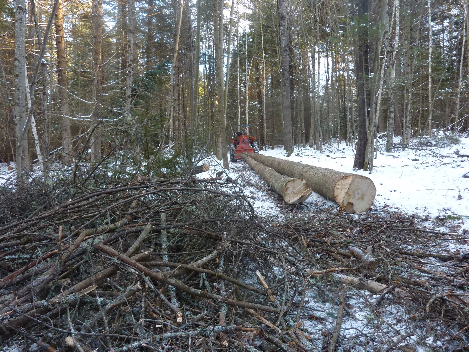

Edit; our machines are comparable, and I wouldn't attempt that big of a load.They only weigh +-2900 lbs.
If 28 feet is the length you need I would bring them out one at a time. Otherwise I would cut them to length in the woods and bring 1 or both of the butt logs out, then go back for the tops.
The 3PTH capacity is only one thing to consider; if you're thrashing and tearing to get the twitch out there's always a chance of breaking something. Sometimes it's better and quicker to go lighter and make 2 trips.

You can try taking them out top first so you lift the light end. In dirt they drag much harder that way but if you have good snow the dragging is much easier. I take them how ever they come easiest and often pull top first. Take heed of what Jstpssng says. You don't want to be always operating at the limits all the time. Like he says - dangerous when a sudden change occurs and hard on the equipment.
They must have changed the L series. The older ones like my 30 hp L3010 are heavier and stronger. Mine weighs 5000 lbs the way it is set up.
