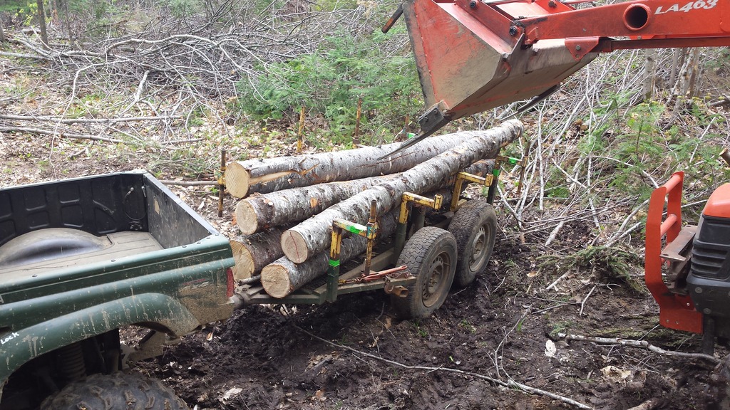

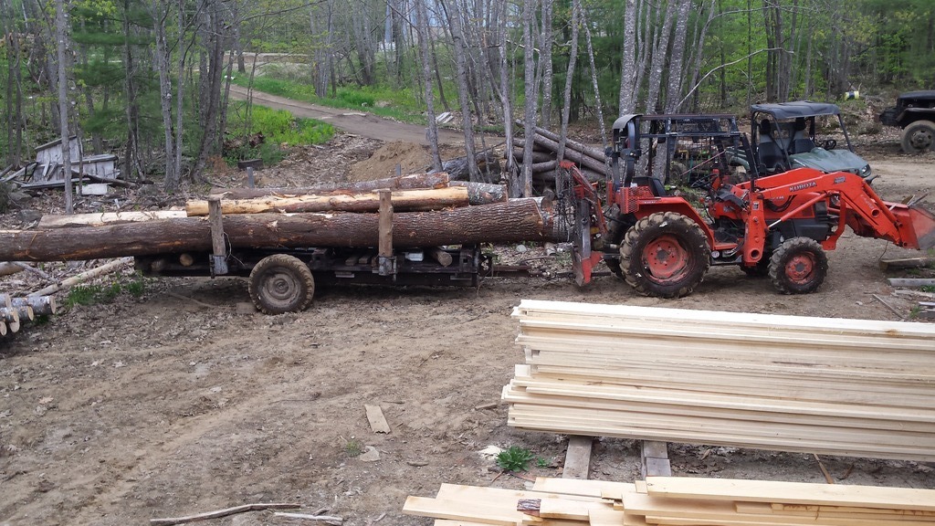

After 20 years of making syrup, it's been 5 years since I done it, probably wont make any syrup again till I retire in a few years.
Any trailer is better than none, can haul twice as much with half the power and stain on a tractor.
   / Kubota L3800 3 pt lift capacity: can稚 lift trees #40
View attachment 547211 View attachment 547212
