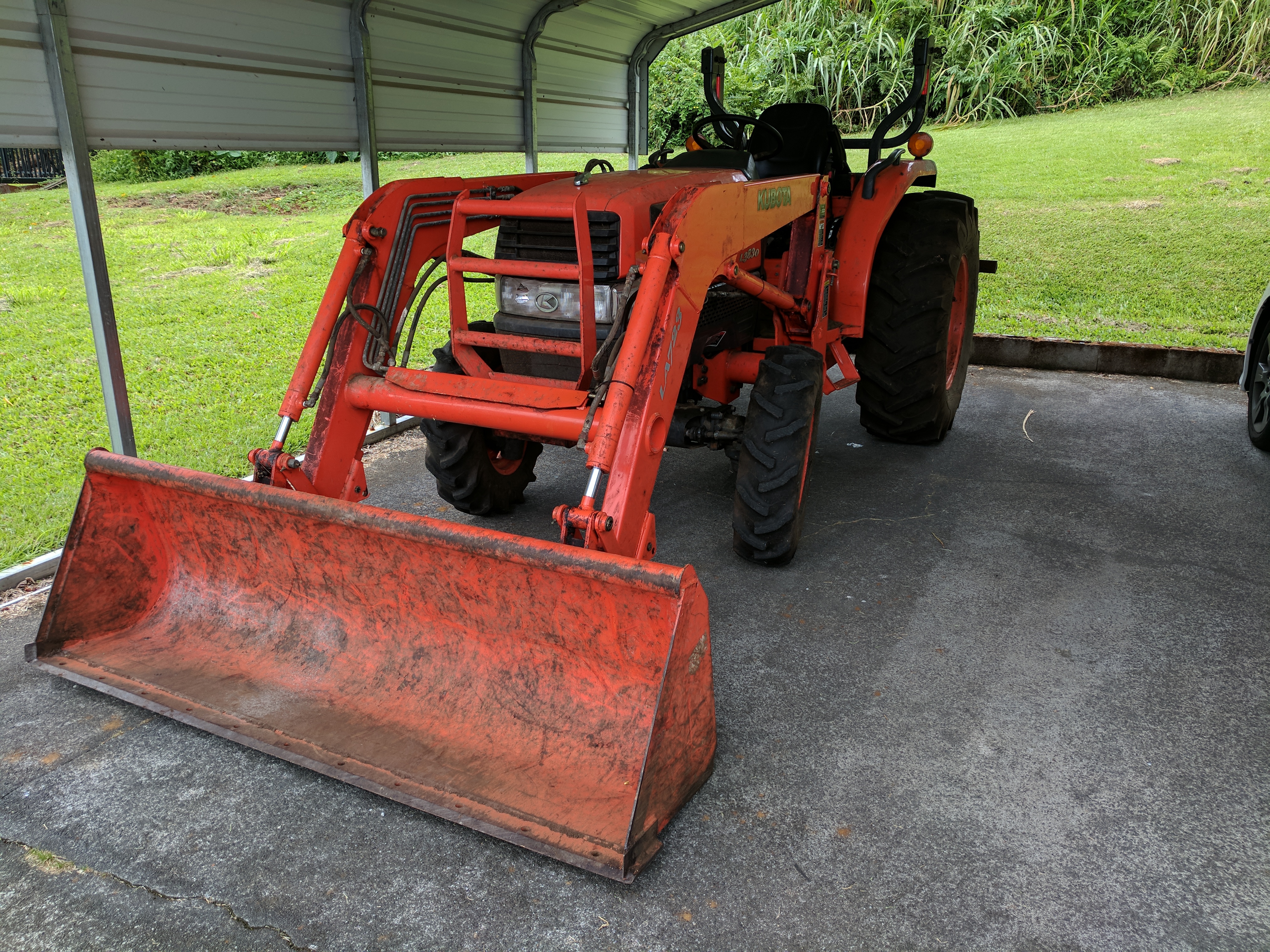

You have a pin coming out of the dump cylinder on loader it looks like, need to check that. Overall it looks good, best of luck
   / Kubota L3830 price check
#22
Good catch; thanks! Can I just tap it back in with a mallet?
   / Kubota L3830 price check #23
Yes it should go right back in but it should have some kind of keeper on it. Most of them have a bolt through the end and some have a pin.
   / Kubota L3830 price check #24
The upper pin on the right side curl cylinder should have 2 grooves with snap rings and the top part of the bucket level indicator is attached there. The lower pin has a smaller section sticking out that the lower part of the indicator is attached to.
David
   / Kubota L3830 price check #25
I was wondering about that I’m not familiar with that tractor. To be sure if that would have been addressed if it sticking out. The ones that I’ve seen with the level indicator only stuck out a slight bit but either way don’t hurt to check.
   / Kubota L3830 price check #26
Pin is secured. It's just extra long for a level indicator which has been removed.
#27
Thanks to everyone for their input! Picked it up this morning; the pic in the carport is right after delivery and the other pic is after a bottle of degreaser and a little pressure washing.
