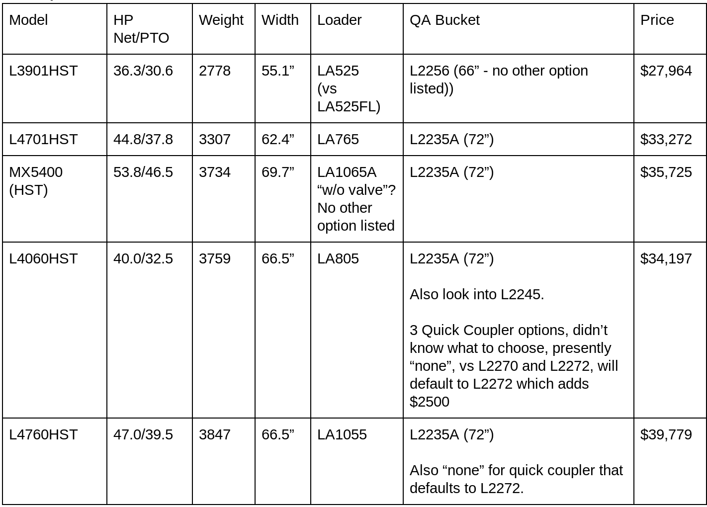

A bit of follow up to share information in my search. I'm getting closer to a decision.
I priced a bunch of base tractor+loader+bucket scenarios on the Kubota web site. probably flubbing some things in my confusion about quick connect loaders, "standard" options, and such, but it was just a baseline for me to better have a conversation with the dealer(s). I've included it here as a hopefully-readable image, because the table doesn't otherwise copy&paste well, and I didn't want to link to something else that was more likely to be deleted (though I have no idea how long tractorbynet keeps image attachments). tractor-comparison.png
The prices were all for HST models with mostly the same bucket, the L3901 was smaller by necessity. All prices were for R4 tires.
More realistically the pricing model is likely to ascend in the order L3901, L4701, MX5400, L4060 L4760.
Of course once you factor in all the attachments with a real quote, that are sized to the respective tractor, things balloon out quite a bit, even after incentives which the numbers don't reflect.
For example, in my table above, the L3901 figure is ~28k, and the MX5400 is ~37.3k. But once I factor in a rear blade, pallet fork frame, grapple, 3rd function, rotary cutter, and scraper blade, and state taxes, those two figures balloon to ~35.9 and ~44.8k. respectively for the L3901 and MX5400. Note that my quote didn't skimp on models of things, for example the rotary cutters were slip-clutch versions, but none I tried to stick with mechanical quick connect loaders, not hydraulic.
Of course it is at this point where we potential tractor buyers must have our heads examined, but that's a whole separate conversation.

Okay, let's talk width tradeoffs:
I've mostly spoken with a dealer about an L3901. Here are the specified (default) widths of the Kubotas I mention in the title:
So the L4060 'Grand' model is more than 11 inches wider than the L3901! That beckons to me, but perhaps it is irrational, and I don't have the a list of cost upgrades involved yet (any data anyone?). And there's the conflict, wider tractor means harder to navigate woods. Heavier tractor means more damage to lawn (when crossing), and potentially tree roots.
The dealer tells me the L3901 only accommodates 1.5" spacers. So at best I'm going to get 58.1" width. I don't know what's available for the others yet.
