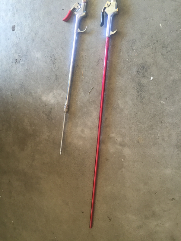

I used to use the top one which essentially is a air wand....
This is until I found the lower one which works head and shoulders better

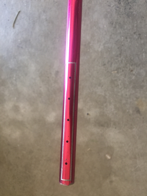

Notice the holes on the side of the wand, the end is capped.
/ Kubota L4240 Engine Temp Question..... #9
Thanks!
Looks like I have another project in the works.. with a regular blow gun it's hard to get directly behind/between the fan blades and the rad, as I'm sure you already know.
/ Kubota L4240 Engine Temp Question..... #10
Thanks! Looks like I have another project in the works.. with a regular blow gun it's hard to get directly behind/between the fan blades and the rad, as I'm sure you already know.
Exactly! This fits in nicely in between everywhere you it too. Again, so much nicer than a standard blow gun for radiators. The blow gun obviously still has its many uses, just not the the radiator anymore (for me).

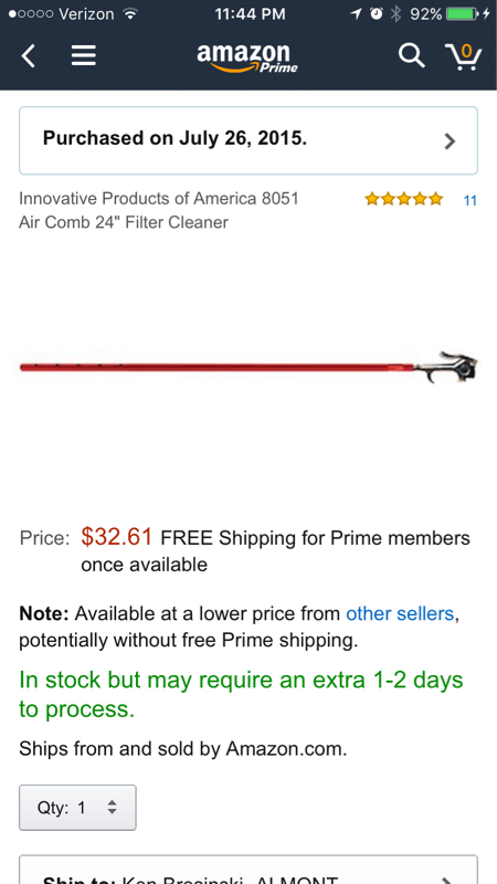

I'm wanting to add one of these to my tool box, but can't seem to find one for sale. You mentioned amazon, I did a search but no luck. What would you call the thing? Perforated Air Wand? Looks like it would work perfectly especially on air filters.
Thanks
/ Kubota L4240 Engine Temp Question..... #13
KenB2920, I'm wanting to add one of these to my tool box, but can't seem to find one for sale. You mentioned amazon, I did a search but no luck. What would you call the thing? Perforated Air Wand? Looks like it would work perfectly especially on air filters. Thanks
Search for "Air Comb" you'll be able to find them that way.
This is the item I have. They have a few lengths but the 24" works perfect. Probably over priced but has probably paid for itself in saving my engines.
I do have the 3.99 one from harbor fright as well. It serves it's purpose and is great but doesn't hold a candle to the air comb for radiators.
I agree it can be made much cheaper. But the diameter is about that of a pencil so it fits well between all the radiators.
Some good videos on YouTube with it.
They sold me on it...
