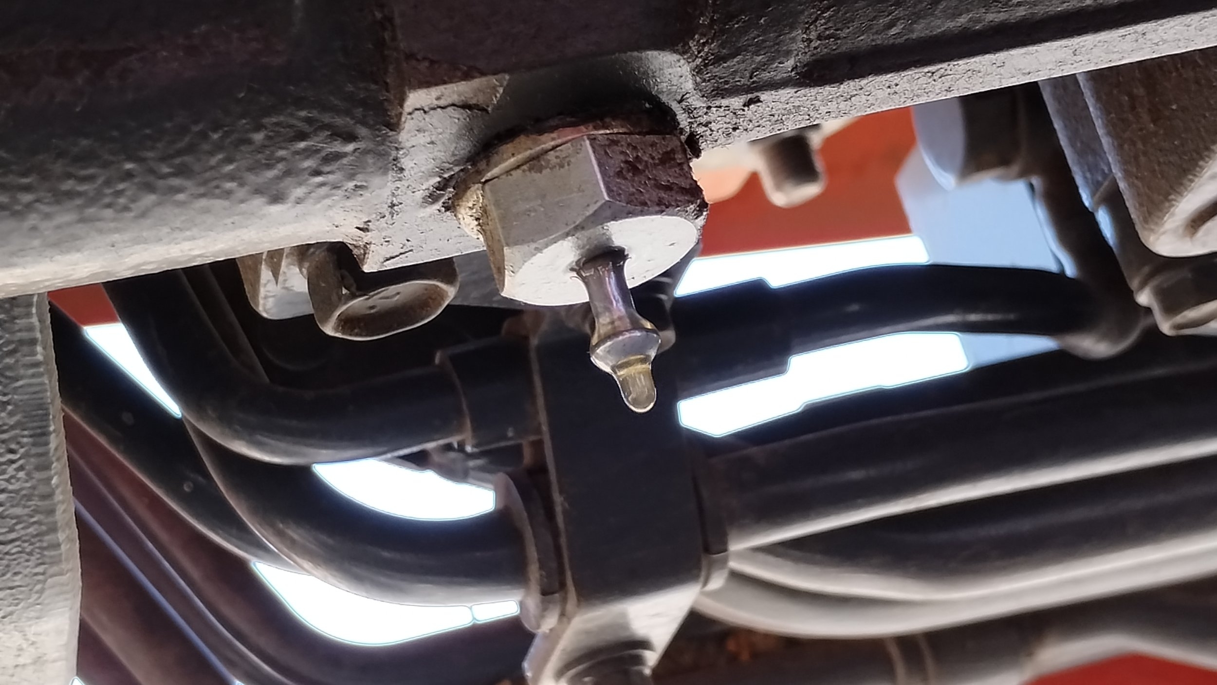

well after a few weeks of cool weather, it finally got warm. Tractor was running good while it was nice.
On the first hot day it started stalling pretty bad, when I got back to my shop there was hydraulic fluid coming out of the silver thing (or above it and dripping down) in the pic. Service folks said it most likely some seal on the transmission in there that doesnt go bad often.. of course. I dont remember exactly what he said it was, but required essentially split in half.
Havent heard back yet on the exact issue. But I am guessing the stalling was when the fluid got to a certain temp it would start to leak then stall out.
That is the drain for the bellhousing and if it is dripping fluid, it's indicative of a main seal leaking. If it's engine oil or transmission fluid, only you can tell but either wan it will entail a split to remedy and has nothing to do with your stalling hot issue.

#24
it was transmission fluid that was coming out.
   / L4240 Stalls when the ambient temp is hot. #25
Then your input shaft seal is leaking. Least it's not the crank seal leaking because that usually contaminates the clutch if you have a clutch.
Amount is always important because a small amount may be from thermal expansion whereas a large and steady amount means the seal is shot.
   / L4240 Stalls when the ambient temp is hot. #26
Actually this is a known failure point on the Grand L, both the 30 and 40 series. And it may recur in a few years. So far mine has held (knock on wood). The crappy part is you have to split the tractor to get to the one cheapo seal to replace it. Why Kubota let it go all those years without a real fix is beyond me, but probably good old cost.
   / L4240 Stalls when the ambient temp is hot. #27
I knock on wood as well (leaking crank or input shaft seal). Of course neither of my M's have a clutch to get contaminated. All that is in the bell housing is a damper plate to mitigate shock loads during directional changes so if they did start leaking, I'd just keep an eye on the engine oil level or the gearcase level.
Even with nothing inside the bell housing, both still have pin drain on the bottom.
