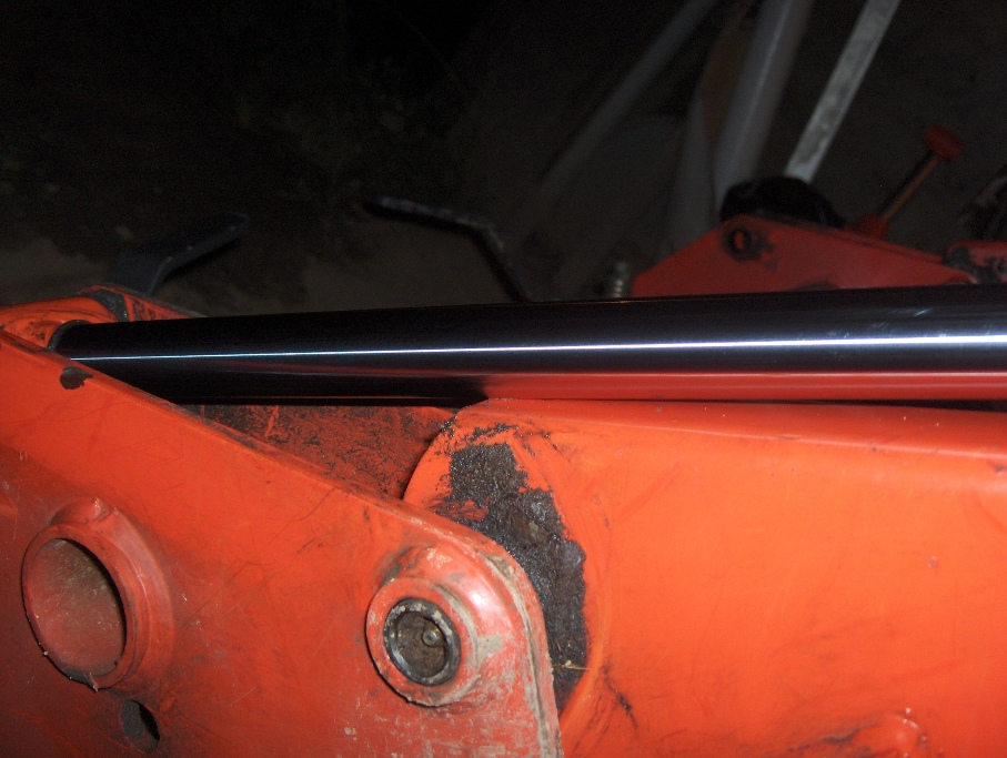

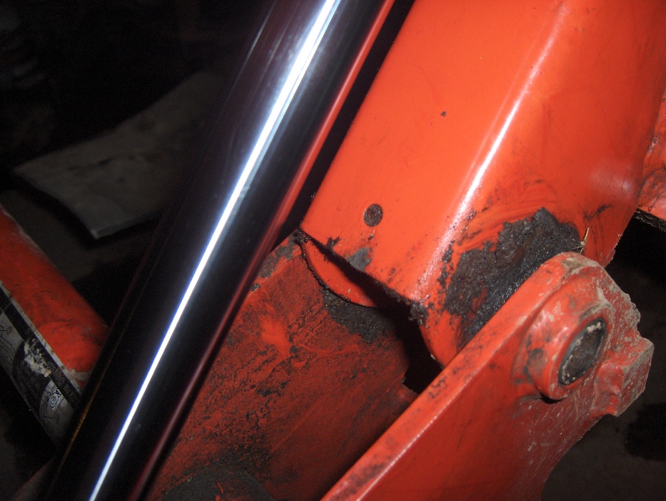

Well I spent some time looking closely at the cylinders and the movement and such. I found a different issue that may very well be instrumental to the cylinder failure. The rod of the cylinders hit the bottom most part of the boom in full dump mode. It appears that the SS Quick Detach has the movement stop made onto it. The cylinder rod hits the boom before it hits the limit stops. Here are a few pics of what I am talking about. I also have a call in to the Kubota dealer to get his opinion and see if this is supposed to be. It doesn't look right to me. I checked everything and nothing is bent and all pins are tight. If you look closely you can see where the rod has been hitting the boom.:confused: All thoughts and comments appreciated.

Well, I've seen something like this on a New Holland compact.. as I recall the bucket stops were either beat flat or were too thin to prevent the rod from touching the loader arms at full dump position.
I'll have a look at my 463 arms tomorrow, although it's a different loader than the 703.
Incidentally, I straightened a bent cylinder rod yesterday, pretty much the same size you have. It turned out pretty good, luckily there was no damage to the gland or the cylinder itself.
