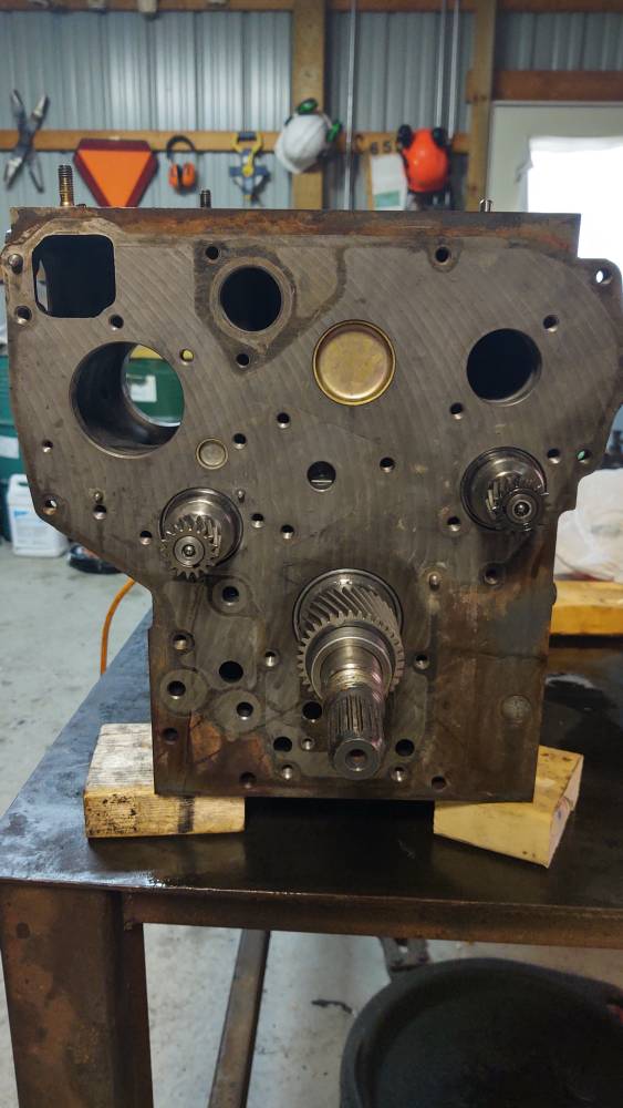

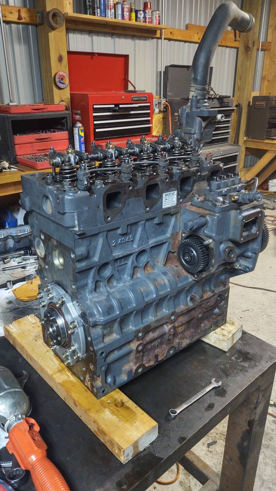

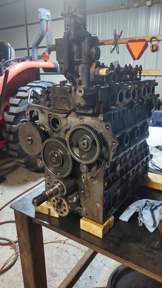

Made some more progress this afternoon. Everything went smoothly.
To put all the shafts and gears in, first set cylinder #4 to TDC,
- Slide the balancer shafts in. Put the mounting bracket and torque those, as there's one bolt hidden behind the cam gear.
- Slide the cam in and line up the timing mark to the balancer shaft.
- Install the fuel cam.
- Bolt/torque the idler gear mount, then slide the idler gear in, lining up all timing marks.
Note: make sure to put the valve tappets in BEFORE the head. I almost forgot and was just about to torque the head down.
I forgot to put the tappets in order of how they came out, and noticed it said in the service manual not to swap them around. Oops. Hopefully since it's a pretty new engine it won't matter. I'll double check all the valve clearances before running it.

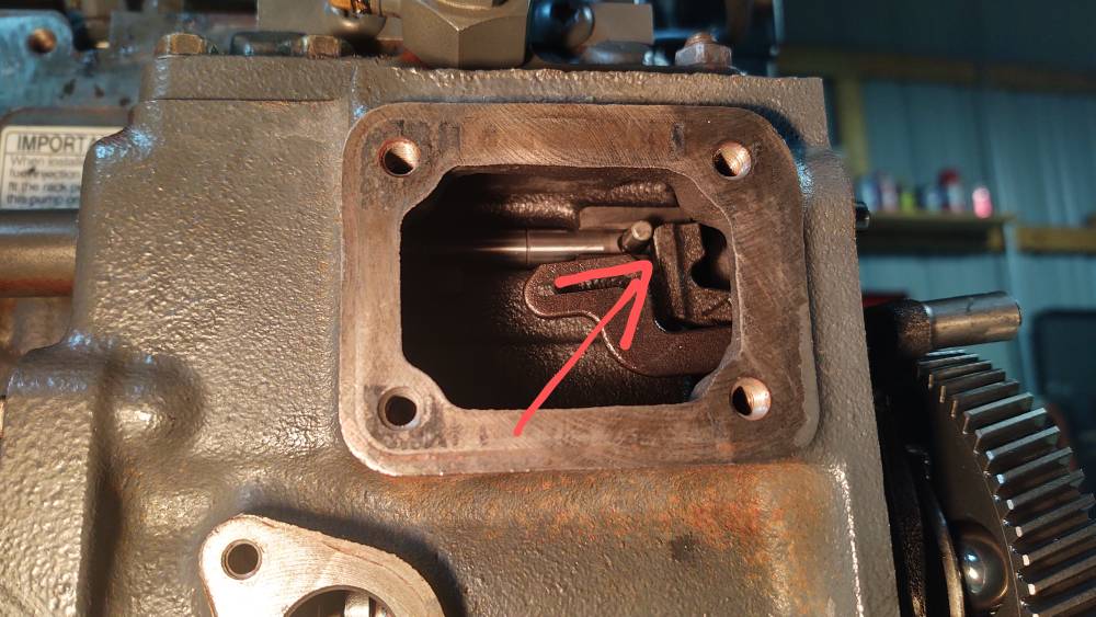

Note 2: There's a little lever (governor??) that's part of the fuel cam assembly. When you put the injection pump in, you have to push it back out of the way of the rack pin on the injection pump before you bolt it down. See the pic with the red arrow. I missed that and tightened it down with that lever under the pin. It bent the lever but thankfully I was able to straighten it out.
