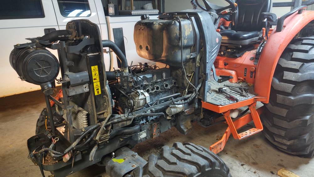

Made good progress today and got the case bolted back together. The only hitch was those governor springs from the throttle body to the fork lever (in the injection pump housing area of the block). They're a royal pain to put back on. They kept falling off the throttle body lever and I dropped one, had to take the gear cover and fuel cam back out to get it. Best plan is to take off the engine stop lever housing and hold your finger against end of the spring on the throttle body lever to keep it from coming off, then take a pair of needle nose with your other hand and hook the springs on the fork lever.
Other than that everything went smoothly. Hopefully will get some time tomorrow afternoon and get it all back together.
Perhaps I should do a writeup on splitting the case and tearing the engine down. If I can find the time...

You bet misery loves company! I needed some this afternoon trying to get those steel hydraulic lines back in. Crazy jigsaw puzzle...and you have to do them in the right order or you'll end up taking the ones off you just put on. Ask me how I know. :mad:
I don't envy you. That $7500 hurts thinking about it. Yeah I was fortunate here that the block wasn't damaged too much and was able to just fit new bearings.
I considered new, but I'm cheap :D I had about $700 in parts and another $400-500 in fluids and a few odds and ends. New with warranty would be nice, but I figure worse comes to worse I'll just be back where I started in another 350 hours. And I'll be able to do it faster next time! :laughing: Hopefully that won't happen though.
Didn't get as far as I hoped this afternoon. The devil is in the details. So I guess startup will be tomorrow... IMG_20201221_184836796_HDR.jpegIMG_20201221_184844927_HDR.jpeg
