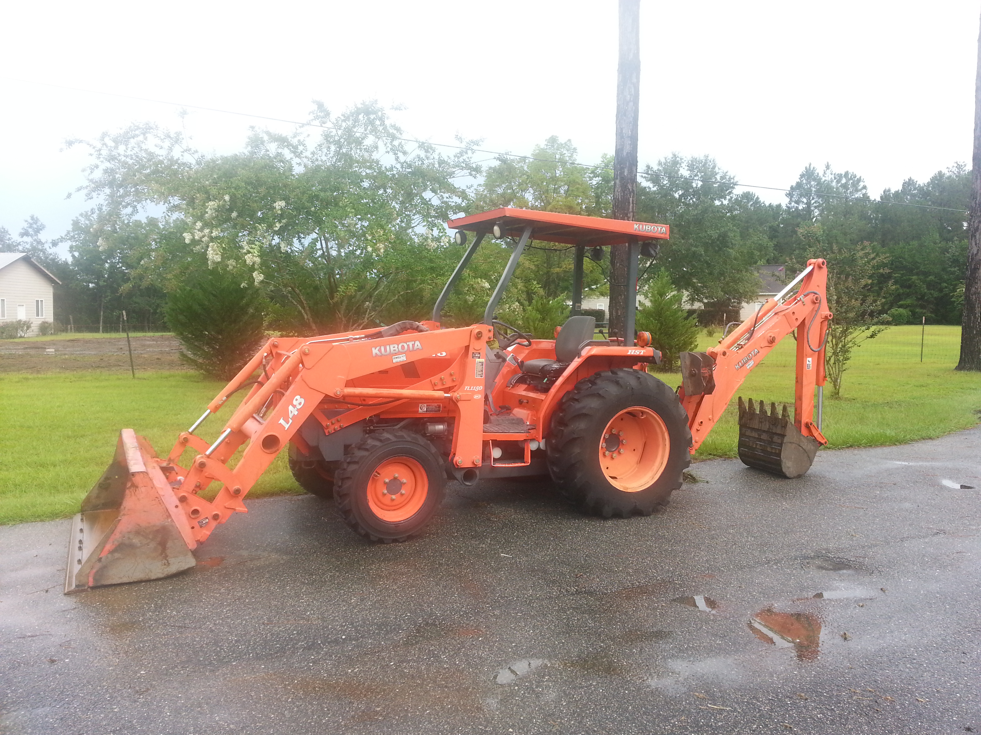

Well, Here is my new ride L48 TLB, I sold the TC30 Sunday, and in less than 24 hours have this beauty sitting in my yard.
I will miss that little blue mule, I owned it 11 years, but I really needed more lifting power, I think this will do the job just fine.
Thanks for all your advice.

Beefy Looking Curl cylinders on your tractor, I upsized mine on my L39. I like that deep bucket. I'd like to find an L48 bucket used.

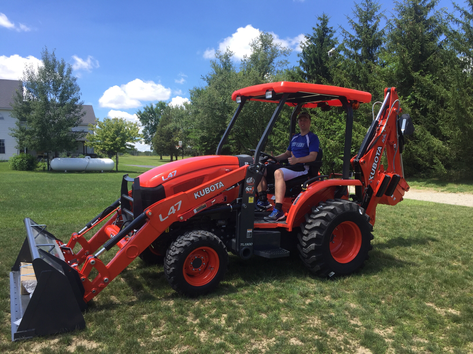

LOL! That picture was just after rolling off the trailer when I brought it home! You have to look close but it has the thumb and front hydro. Has a "60 wicked grapple on fel now. Just wish I could get more play time with the new toy...
