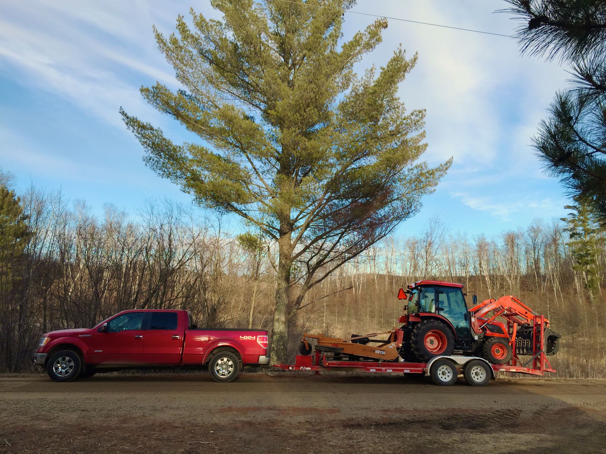

It'd be one heck of a dump trailer. The NX6010 is 78" wide across the rear wheels with industrial tires mounted. On the other hand, A $20k difference allows for the purchase of a car hauler to chase the tractor around. If you go that route, get a 22' or 24' trailer as my 20' is cramped when things are mounted on the tractor.

I would expect your dump trailer has a GVWR somewhere, unless it was home built. Aside from physical dimensions, two of tractors you're talking about are +/- 4200 lb, so I think a 7k car hauler would be the minimum you could get away with. (Isn't the 35 series Mahindra, like, 5500 lb?) Throw on loaded tires, FEL + grapple, rear implement like Eric shows above, and you're talking 10k dual braking axle minimum. In Oregon, moving to that size or larger trailer makes it "commercial", plus the tow vehicle also must be registered as commercial. That results in quite a number of 9999 GVW trailers being pulled by half tons.
