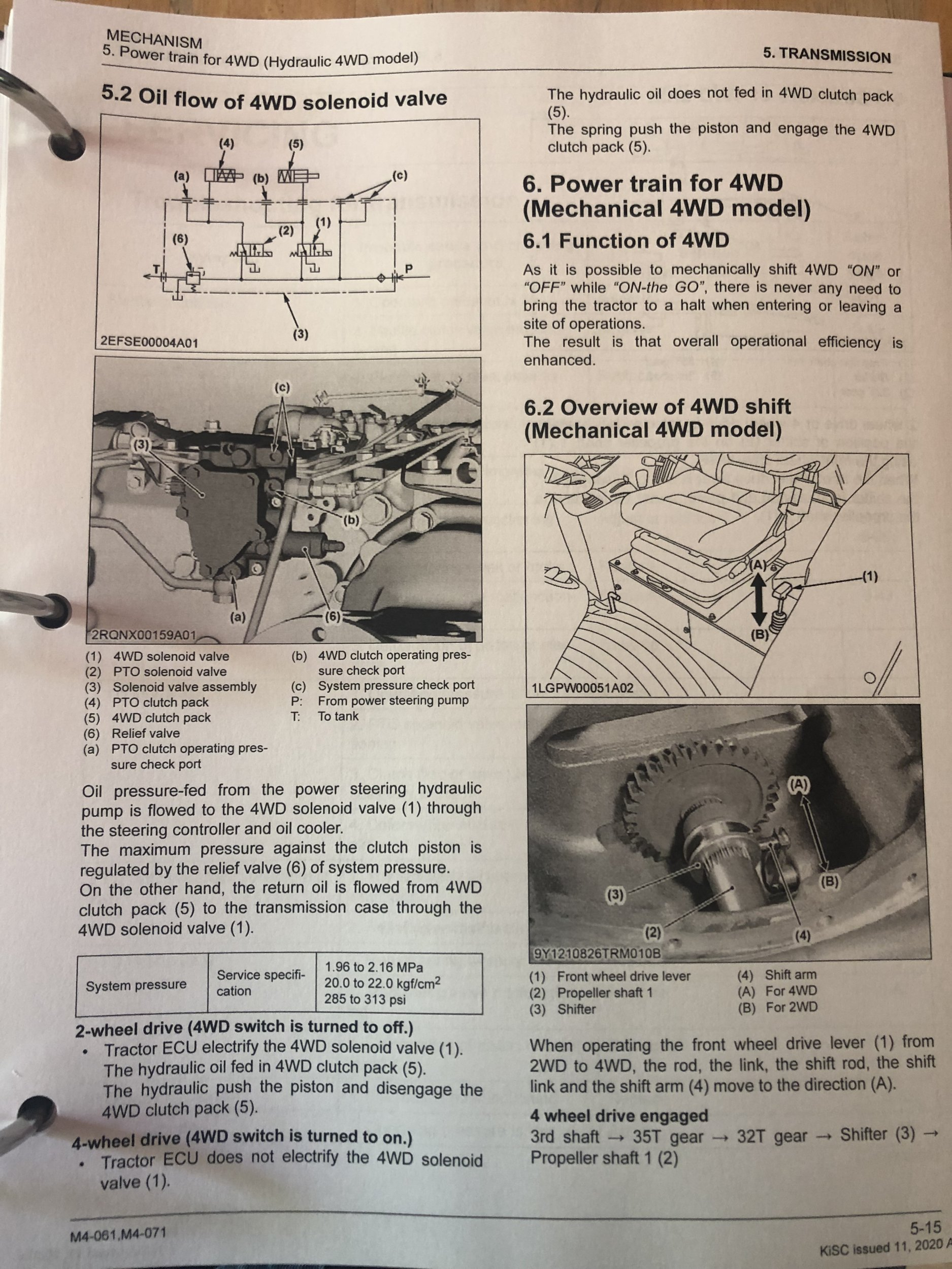

I ordered the M4D service manual so I can at least understand how the 4WD engages and is in play while braking. Hope it arrives this week so I can dig a bit deeper. As others have stated the dealers are clueless with this noise.

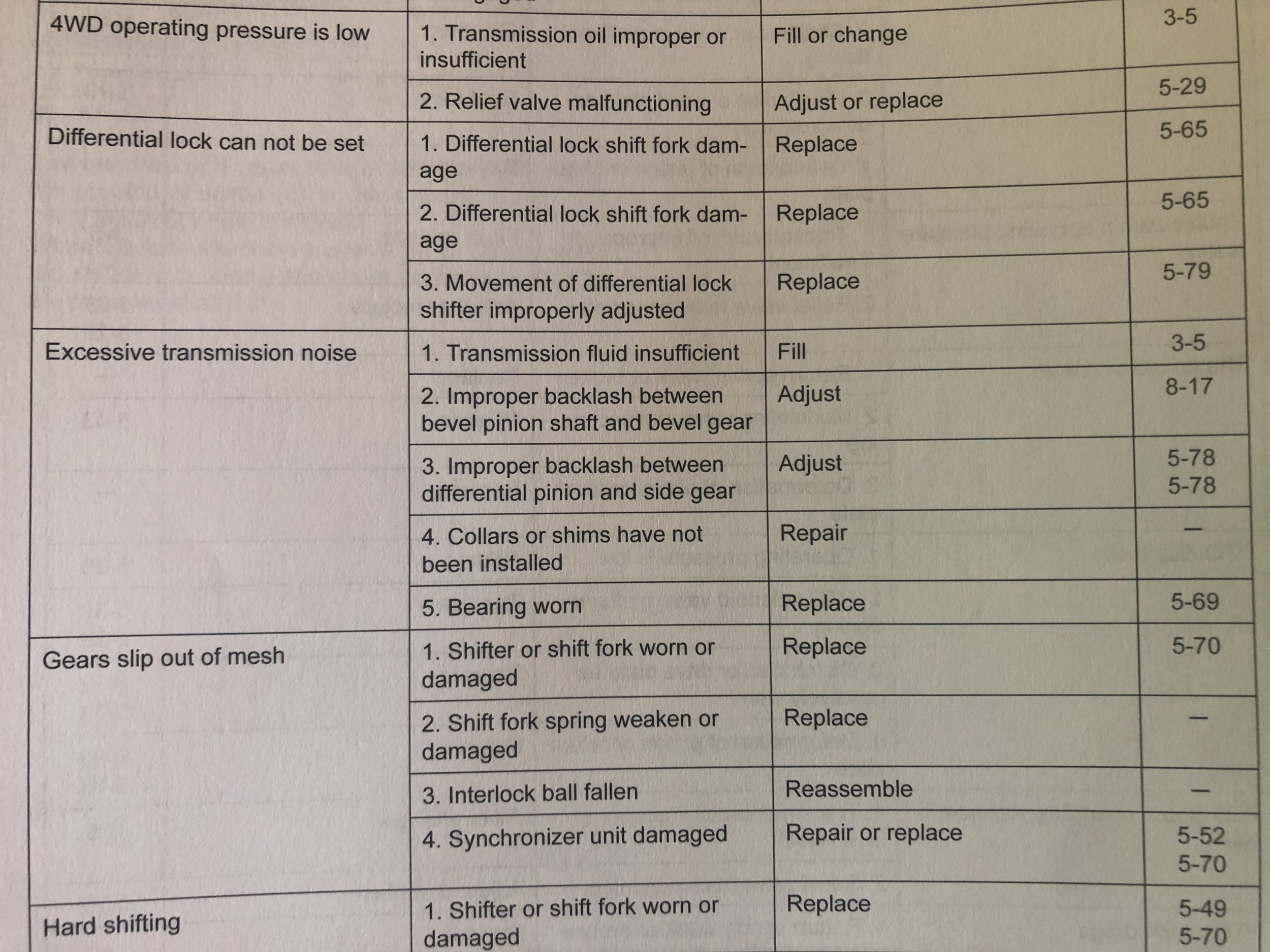

Not much there, for trouble shooting your choices are add fluid or split the tractor so small wonder the dealers don’t want to touch it.

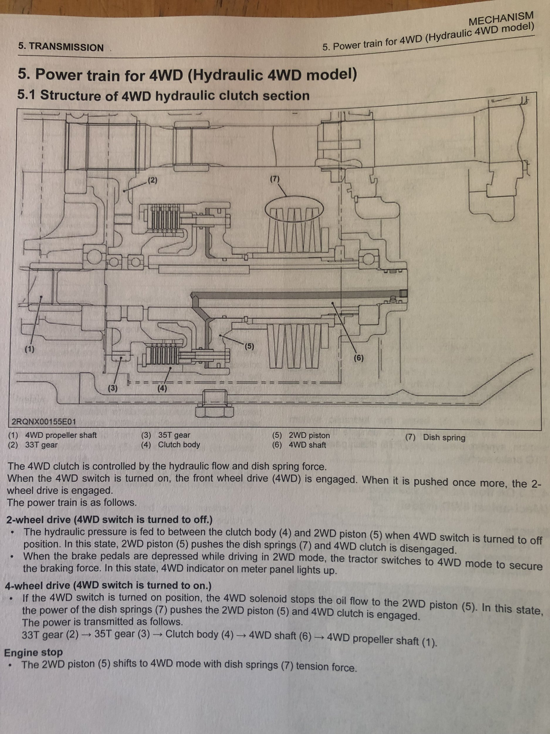

View attachment 743135View attachment 743136View attachment 743134
Thanks. Looks like there is a bypass regulator along with test ports. I’ll snoop around and see if it’s the noise maker. Wondering if the fluid expansion at high temps is increasing pressures higher than spec.
What’s interesting is they rely upon the 2WD solenoid to be activated to disable 4WD. The 4WD has a large spring to engage and appears to be the default. So if it were a faulty solenoid it should default to 4WD full time.
Given that scenario I’m suspecting the fluid pressure is excessive and that bypass is bleeding off the excess. Tractors with more hours may not show the issue if they leak down or settle in with lower pressures over time. At least a theory.
