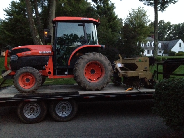

Well, folks, to close out this thread, I wanted to let everyone know where I ended up on this issue. After a lot of searching and number crunching we determined that we would buy used instead of new. I sold my JD 4720 to a gentleman from Malibu, CA and shipped it across country. We found a very nice, lightly used 2012 Kubota L5740 cab tractor at a dealer in New York state and were able to make a deal with them and paid considerably less than we had planned to on a new tractor. With what we saved, we are now planning to purchase a third, and slightly larger tractor but probably won't do so until after the National Farm Machinery Show in Louisville, KY next February.
The Kubota had 105 hours on it when we picked it up about three weeks ago and it now has 185 hours on it so yes, we've been working it pretty hard and I'm not disappointed in the least. This week I pulled a disc through heavy clay topsoil for 5 hours on a hot day at 2500 rpm and the AC stayed ice cold and the machine didn't overheat at all. Sorry, but my Deere crapped out on that same challenge twice this season. It was a good tractor for light duty but just not cut out to bust a gut in the dirt.
I want to thank everyone who shared their thoughts on this thread. I got very good input and through all of that ended up with a strategy and a tractor that works for us. It pays to ask questions!
