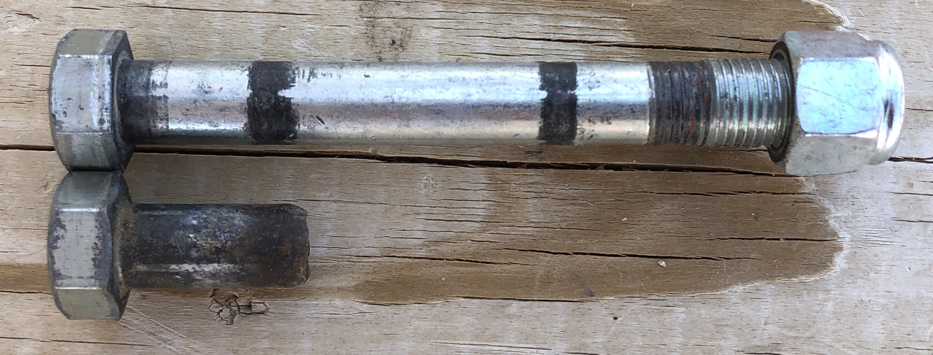

Fellow Kubotan's.....
I made this video for a friend (named Darrell obviously) at the last minute and had no plans to put on YouTube so forgive the poor camera skills and narration. After giving it some thought, I feel others may benefit from it. It sure woke my eyes up to how quickly a very heavy part of your tractor can be laying on the ground looking up at you while you search the yellow pages for crane rental 2 hours from the closest SMALL town.

I'm religious about the 10 hours, mainly just because it's so much fun using the Milwaukee cordless grease gun. What blew me away is that for that bolt to clean sheer would have required a lateral rotational force ON the pin of such high amount, it must have been dry and the boom grabbed a dry spot on the pin and grabbed on. I bought it with 50 hours on it, it was a rental from the local dealer but you never know how much they greased it.. just always assumed that pin would be so locked down it wouldn't rotate. I was going to get grade 8's as well but the Homeless Despot (the only hardware store within 100 miles) only had those.. Now that I'm aware, I'll watch them close, they only really do keep the pin from leaving the boom so should be ok as grade 5 (which I assume they are).
The cheap Chinese slave labor nylocks backing off was a surprise as well, normally I hate those things cus they gall and lock up so tight you need to chisel them off, not loosen by themselves... That all being said, it's obviously good practice to check all those post delivery (which I did, they were all snug) and continue to on a regular basis.
Item 40 below is the little snapper....

The nuts shouldn't be overly tight, you want some play so the bolt can actually "float" a little for the slight pin movement, the bolt being too tight can actually cause it to break easier.
The broken bolt on the boom was possibly caused by catching the bottom and breaking it or as you said a dry pin, if it was dry enough to cause that you might want to check for damage. Being a rental who knows how it was treated in those 50hrs, the boom has a lot of weight and takes a lot of cyclic loading so a dry pin could cause problems.
If your replacment bolts are stainless I can't tell the grade from the video, if they are just zinc plated then they appear to be grade 2 due to no making on the head.

Great points, I'll probably back off that lock nut a bit, it's floating but could be a bit looser. I'll probably source some grade 8's at some point but I was torn between "do I want to make a cheap bolt harder to break and risk damage to the boom ect or do I want to consider it a cheap pseudo sheer bolt and just keep an eye on it and have some as backup" personally I'd rather sacrifice the occasional cheap Home Depot bolt than risk damage to the Kubota boom etc. :). I didn't even look at the head, if I recall my apprenticeship with Detroit Diesel Allison, the number of slashes on the head plus 2 is your grade (6 slashes is a grade 8) but I may be mistaken, it's been a while.

Well I checked out the snapped off bolt head (I still had it) and also checked another that I had pulled that had not snapped yet but I wanted to be safe (and compared it to the spot it was in). You can clearly see that grease does not get in that passage on the end of the pin, and they way it's designed, in motion it just scores and scores the bolt till it eventually snaps. The marking on the head is .7 which would imply with metric grade indicators that its around a grade 5 but with that scoring, and the remaining head piece I have left, it looks like it just scored the outside and then snapped, no twist markings on it etc.... you can see it wiped the threads right off and even bent it a bit, you all may want to check yours for score marks. They need to countersink/chamfer the rod shaped hole that goes across the pin as it's obviously stronger metal than the bolt and has spurs on their drilling.

How many hrs are on the machine? Those bolts look awfully dry and clean, the grease doesn't need to reach the bolt, but anything with some hrs that's been greased properly will most likely show up on that bolt from my experience.
That bolt should see very little load on a properly greased machine that isn't abused. In order to shear a bolt that size something is wrong.

I bought it from the Kubota dealer at approx 50 hours and noticed it before my first grease which would have been at 60 hours but to answer your question, I think I'm at 175 hours right now. They had it in their rental fleet for the first 50 hours of it's life and I agree, it does not appear that any grease has ever gotten down to that area but when greasing, it just keeps coming out the other end so there may not even be a grease channel to that area, I may pull them out and manually grease them.
