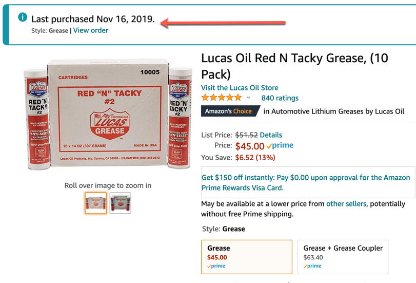

This stuff? Lots of good reviews on Amazon, FWIW. Here's the spec sheet. Only a dollar or two more per tube than the TSC stuff. I've put a couple tubes of it into the pins on the FEL and backhoe, and it seems to be working fine. That's been enough to push some, but not all, of the moly grease out that was in there. I haven't noticed any run out, but it'll be over 100F tomorrow so I'll keep an eye out. It's supposed to have low viscosity at low temps, so it'll replace the boat trailer grease that's in the steering bearings on my winter motorcycle. Handling gets "interesting" in sub freezing temps as it is now...

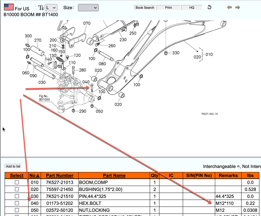

I'm religious about the 10 hours, mainly just because it's so much fun using the Milwaukee cordless grease gun. What blew me away is that for that bolt to clean sheer would have required a lateral rotational force ON the pin of such high amount, it must have been dry and the boom grabbed a dry spot on the pin and grabbed on. I bought it with 50 hours on it, it was a rental from the local dealer but you never know how much they greased it.. just always assumed that pin would be so locked down it wouldn't rotate. I was going to get grade 8's as well but the Homeless Despot (the only hardware store within 100 miles) only had those.. Now that I'm aware, I'll watch them close, they only really do keep the pin from leaving the boom so should be ok as grade 5 (which I assume they are).
The cheap Chinese slave labor nylocks backing off was a surprise as well, normally I hate those things cus they gall and lock up so tight you need to chisel them off, not loosen by themselves... That all being said, it's obviously good practice to check all those post delivery (which I did, they were all snug) and continue to on a regular basis.
Item 40 below is the little snapper....
